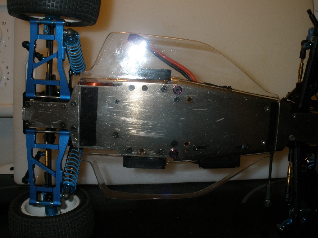

What Jirka said. I mounted my Mid undertray using double-sided tape and a pair of flathead screws and conical washers; it should never rip off and the bigger surface contact area of the conical washers should prevent cracking of the Lexan where it's bolted on, than if I used screws alone.

I figured I'd share some pictures that should clarify what the TBG undertray covers and how I chose to install it. I used 2 strips of double-sided tape and 2 flathead screws & those purple conical washers. They only protrude about 1.5mm out from the Lexan surface. You can see where the undertray doesn't extend to the front or all the way to the rear, I can't answer why but it seemed odd to me, too. Oh well, the tray fits pretty snug to the chassis plate when positioned correctly, and I suppose you could stick on pieces of the chassis protector film Terry mentioned in the open areas, if you really wanted to.
