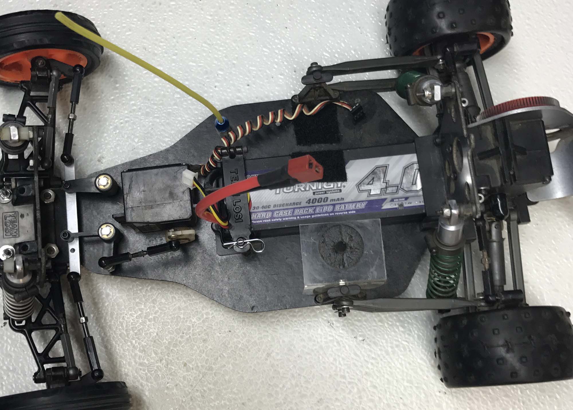

Re: Old chassis and lipos?
I have found 2 hardcase lipo packs that fit the jrx series without modifications, only one is still available new
The first is the SMC lightning volts 3200mah red and black checkerboard battery which was used as the DODC.com spec dirt oval pack. it is discontinued.
The second is https://hobbyking.com/en_us/turnigy-4000mah-2s-30c-hardcase-pack-roar-approved-de-warehouse.html
