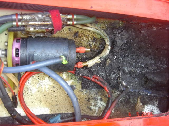

I use Lipo's in boats, and have had a few submersions with them. If they are properly sealed, you can simply dry them off and have no issues, but 'properly sealed' is very difficult to achieve. Each single Lipo cell is made up of hundreds of layers of very thin lithium. In between each layer is a coating of silicon polymer. The danger with Lipo's is that; if the battery gets too warm, the silicon melts and the charged layers of lithium short circuit against themselves. It only takes one layer to make contact with another and the heat this produces melts the next layer of silicon. You then get a very fast chain reaction as the heat transfers through the pack melting each layer and causing more short circuits/heat. This is why lipo's 'go off' with a bang.
Nimh's are different by physical design, so when they get submerged in water they simply dis-charge. Dry them out, re-charge and you're back in business.
Lipo's are not designed for this, so only a perfectly sealed pack will survive.
It's an individual choice, but my advice would be to stick with Nimh's if you are regularly going to get them wet.
I use 22.2v 5000mah lipo's in my boats, and this is what happened when one got properly wet;
This little accident cost me the best part of £2k. I waited 15 minutes before pulling the hull out of the water and even then, the water-line was sizzling from the heat that was transferring through the hull.
Water and Lipo's DONT MIX!!!! :cry:
