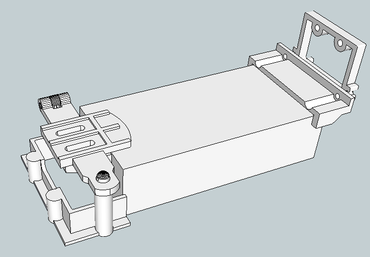

Best method to get Lipo Battery in XX is velcro straps. Ditch the plastic strap down the middle.daz_75 wrote:I used a hobbyking ultimate shortly lipo in my XX the other day it doesn't sit flat and the battery hold down had a real bend in it but seemed to work ok
I have method for full size Lipo for original JRX-PRO and JRXT. Might work on JRX2.
http://sabulatech.com/storefront/index.php?id_product=3794&controller=product&search_query=lipo&results=16
Doesn't require and mods to rear bulkhead height. But will off course change weight more front. But with all the understeer in the old ones that might not be a bad thing.
I started on one to allow Shorty on the JRX line but got distracted and never completed it. It would work on the Graphite and Molded Chassis. All required is replacing the strap and adding holders in the back. See picture below.
It would be similar to this one for the RC10. http://sabulatech.com/storefront/index.php?id_product=3806&controller=product&search_query=lipo&results=16

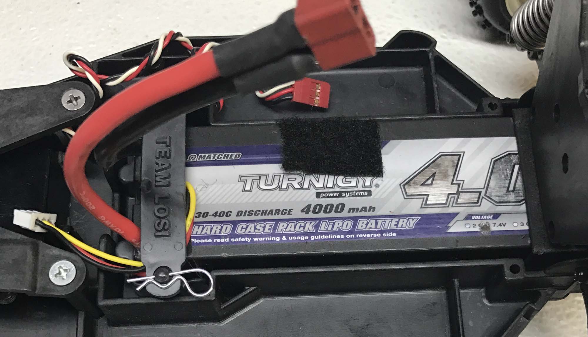

I have found 2 hardcase lipo packs that fit the jrx series without modifications, only one is still available new
The first is the SMC lightning volts 3200mah red and black checkerboard battery which was used as the DODC.com spec dirt oval pack. it is discontinued.
The second is https://hobbyking.com/en_us/turnigy-4000mah-2s-30c-hardcase-pack-roar-approved-de-warehouse.html
