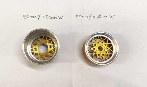

GreenBar0n wrote: Wed Jul 17, 2024 7:46 pmWhat diameter and width are your See's rims?
I don't want to hi jack your thread but it's these.
This thread is dedicated to anyone needing on-road foam tires. I'd be glad to see someone get something out of this too, feel free to post in here like it's yours.
Your See's wheels are exactly what I would want for an RC10L, those look great! The width of your rear tires being almost 2" seems like that would be the tough donuts to find, the front donuts at 2" x 1.1" are very easy to find.
Which donuts do you currently have, that you're thinking about trying?

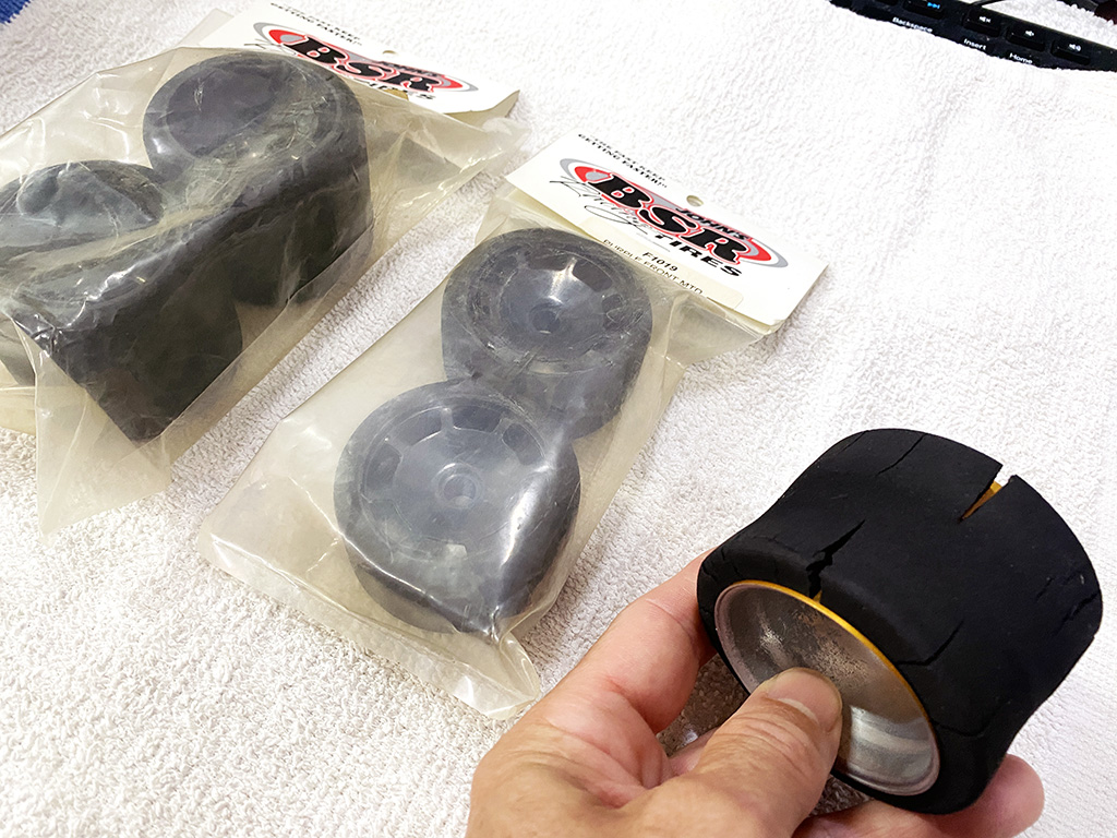

The 3M Weatherstrip adhesive says it can take 24 hours to cure at 70°, got about 2 more hours to go on these.
Can anyone guess which was the first one I tried to glue?
Hopefully the tyre file will knock that glue mess off of there. Learning the hard way has its merits too.
GreenBar0n
Posts: 1557
Has thanked: 1231 times
Been thanked: 799 times
Re: Associated Foam Tires - Standard size
Post by GreenBar0n »
The containment box -
worked pretty well outdoors - this is not an indoors project (garage maybe).
The CRC Tyre File is a must have for this task.
The CRC Tyre Truer V3 is really impressive, accurate and with solid repeatable results.
These Bolink wheels were ruined, all of them had the most ridiculous shelf dents in them and were completely unusable - until now. Now they're all the same diameter and trued again.
Working up the courage to start on TDP wheels, there was no pressure with the Bolink wheels, but these front Purple donuts aren't easy to find, can't mess those up.

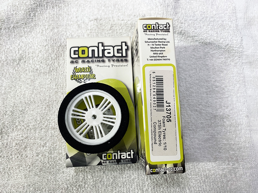

But, I found many modern touring car wheels are roughly 50mm x 27mm which should be perfect. I found this by accident when going through my tires one day. I just happened to look at the Contact RC tires I had and said hang on a minute! After countless hours searching for old tires I have these things sitting in my tire bins the whole time.
I plan to dismount a pair to try out. I also found Contact RC has donuts that are apparently 48mm ID (Part # JY35) so I bought a set of those to try as well. https://www.ebay.com/itm/405063853489

The TRC green dot set I bought in error, and listed earlier in this thread, measures a 1.89" inner diameter, or 48mm.
TRC 48mm ID donuts next to 40mm ID Jaco donuts:
The ones you have ordered should do it. Definitely let us know how it goes.

Couldn't bring myself to cut TDP vette donuts today.
Have to narrow the fronts considerably, and these are the Purple dot hard to come by ones.
Will do this tomorrow.

Glued and trued, this project is now completed.
Made both the front and rear 60mm outer diameter. Not sure if I'll add the ribs in the front wheels, that seems to make them split easier.
I want to put foam tires on all of my street runners, cheap and easy to keep them looking new now.

Really appreciate that, and, none of this would've been possible for me, or anywhere this close to accurate to the movie car wheels, without your original Advance Eng. rim pics and measurements - much thanks again for those!
@MarkyDents original pics for this project:
Jimmy at Dhawk then translated those imperial measurements to metric, and made this happen!
I have (2) more NOS Jaco Green dot donut sets to install on the second TDP rim set.
My first attempt at the glue and true process is pretty bad, glue missing from where it should be - glue where it shouldn't be. I want to do the second set as cleanly as I possibly can. If I get it right I'll share my method, and if I blow it I'll share that of course too, as a cautionary tale.
I'm looking for another Pro-Line Jaco set for the front wheels, Purple and Pink dot are high traction asphalt, would like to find those, want to have a spare Green dot set for rears and not use those in front.
Will be back at some point with another round, and hopefully better results next time.

The problem with foams is that if you try to push the rim in the foam with wet glue it just pushes the glue out.
Use contact adhesive and coat the inner surface of the foam and the outer surface of the rim. Let it dry until it it is just slightly tacky to the touch. Use your finger or a brush to then generously coat the contact with turpentine. Quickly push the rim into the foam and let dry fully. You'll have perfectly glued foams.
Keep in mind you only get one shot to push the rim in the foam. I normally place the nicest edge of the foam donut down on a piece of glass or something and press the outside face of the rim fully into the foam. This ensures the foam is flush with the edge of the rim and that the foam spins true.
If the rims have a big outside lip like that I would probably set the rim face down and push the nice side of the foam onto the rim, but use something flat to push it on evenly
