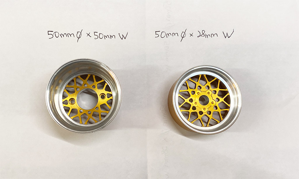

I'm trying to find foam tires for what is said to be a standard Associated wheel size. The place I'm getting the standard wheel size from, is according to the Mini-Mags ad:
A10-Fs fit RC10 and use standard size ASSOC. tires
The wheel dimensions that I have:
Caliper measurement = Converted to Fraction
1.7" = 1 11/16" - Front & Rear diameter
0.75" = 3/4" - Front width
1.35" = 1 11/32" - Rear width
Were the foam tires different sizes for the 1/10 and 1/12 on road Associated cars? Is there anywhere I can find the specs for the on-road foam tires?

Scale is difficult to tell in pictures, got a front set of 1:12 tires accidentally. For $10 it was another lesson learned. May have somewhere to put those at some point.
The TRC rear tires are nearly perfect for both front and rears, with 1.7" ID, and 1.5" wide.
Going to try again for front tires, 1.7" ID is the most important in this case.

The donuts are cut and trued to match desired width and diameter.
1:10 pan car wheels are generally 1.7" or 2.0", with widths varying. 1:12 are usually 1.4".
The dots are describing shore of the foam, so nothing to do with the wheels.
Tire (or donut) cutters are called tire truers. There are plenty of them out there used, but you have to search for the deals. Then you may need different hubs to fit different wheels, but if you are just doing a few random wheels here and there, you can usually rig up some sort of washers / bearings / bushings / etc to get a wheel to hold for long enough.
You can also use the truer to narrow plastic wheels. It is just a super mini lathe.

Following up on this thread. Both donut sets I bought, shown above, didn't fit the 1.7" wheels I ordered.
Turns out Pro-Line Jaco 2202 green donuts were the perfect fit and composition for the rear wheels. Ordered the Pink Jaco's for the front, for asphalt only.
The Jaco donuts are rough cut, and must be trued.
Got the Contact RC Tyre Truer V3 today, with the 1/10 arbor; the 3M weatherstrip adhesive arrived too.
Comes with the carbide cutting blade.

Both of these donut sets perfectly fit the 1.7" wheels, the rears are perfect width, but the fronts will need to be narrowed.
Going to use 3M Weatherstrip adhesive to glue these donuts to the rims, and then true them, and then round the edges with the CRC file.

I don't want to hi jack your thread but it's these.
