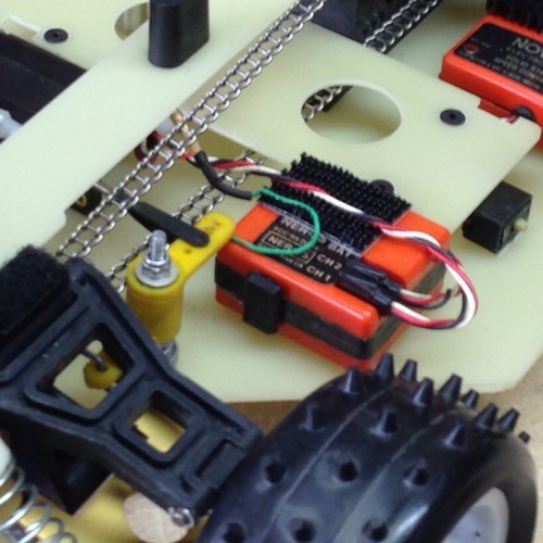

I Wanted one of these since I was a youngster! Finally got one at 35 years old! My brother picked up a LOT of Rc stuff and I bought it off him for 50 bucks. I went through it last night/today and cleaned everything up pretty good for now. I read the thread on peroxiding the white parts in the sun and the next sunny day I am going to do that. They aren't too yellow and I don't want to overwhiten since I want to do a pretty good resto on it. Not a perfect resto because I don't want it to be perfect. I want it to look like its age, but not totally. I will drive it on Sundays to the grocery store. lol! :lol: From the info I found on this site it seems to be a Cadillac from what I can tell. I have the original manual. Its the yellow one and dated 1984 with the Cadillac address on the back page. I could see the A stamp from the bottom of chassis, and when I had the motor out I verified it is in fact an A chassis. Heres some pics. The only thing I have found missing is the front chassis brace tubes, which my brother has found one in the box of stuff. -May find the other one. We will ask the neighbor if he has it. The other thing missing is the front body mount. It runs with the vintage electronics. Ive driven it and its glitchy. I want to upgrade to Lipo/Brushless. Nothing crazy just 2S and a higher Kv I guess so I don't rip the gears out of it. Let me know what you guys think! :mrgreen:

and before you do anything else you may want to take off the nose and straighten it. Then get some nose tubes :idea:

I just found the manual online for the Futaba mc112b esc and see that it needs to be setup without the motor connected. I am going to give this a shot. I'm not real familiar with vintage esc's. could this be why the car was glitchy too?

wickedcrawler wrote:I just found the manual online for the Futaba mc112b esc and see that it needs to be setup without the motor connected. I am going to give this a shot. I'm not real familiar with vintage esc's. could this be why the car was glitchy too?
One other thing.. Any recommendations on getting better rear tires without spending a crap ton of money?
The only reason to set it with the motor unplugged is just to make it easier. Glitching is typically due to the motor caps not being soldered on or incorrectly done. I twist mine into a trio and solder the three points but everyone has this methods. If the caps are on and correct check that the antenna is away from the power wires and the battery and that it hasn't been cut. You can wind it up inside the chassis if its one of the old long antennas or my preference is the old school heavy duty self mating Velcro, you can thread the antenna wire in it.
