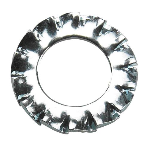

You can always use a washer like this between the wheel and the hex! :D
Cheers
Lars

mmh... I was watching them too. looked too good to be true. The washer will be useless as soon as there's some power going through it I'm afraid, the whole assembly risk slipping endlessly :cry:

I think it will work, have you seen the drive washer on a Scorpion?
Cheers
Lars

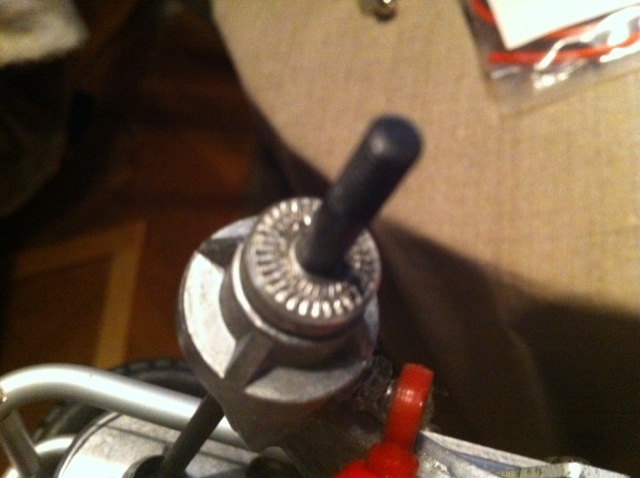

tamiyadan wrote:the original optima did not use hex nuts it used a round pressure fit hub with star like teeth to grab, later on kyosho switched to a hex style pressure fit star tooth hub then later they ditched the star teeth and just went to a smooth pressure sit and smooth faced hex. took them 25 years before they made a model with a pin style captured hex hub.
if that was the intent of these rims based on the really old design that is fine you could use them but they will slip because the original plastic hubs were dug into by the star teeth, it will be very difficult to achieve a good lock with these hubs using the old system.
these hubs in the auction are just for show really.
Like this on the Scorpion.
Cheers
Lars
My Feedback

That might've worked for the stock Mabuchi 540 motors, but it'll be useless with the higher-torque motors, especially current brushless setups. In order for a lock-washer like that to work, you'd have to crank it on so tight it'd crush into the aluminum of these gold wheels. And, that won't last for long before you'll be just spinning permanently damaged wheels.
