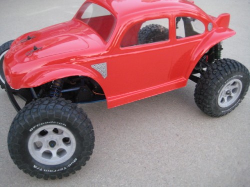

I had a blast yesterday, filming and bashing but it ended in a crash
Upgrading to RPM rear hub
I'm so over these Pro-Line hubs
what am I gonna use instead ?? Well take a guess

Looks dark outside...did you have your headlights on? :wink:
For my guess I'm thinkin your not gonna re-use the same style :P

I'm trying to get the geometry right on my new front end
Morten
Morten Max
Coelacanth
Posts: 7421
Location: Alberta, Canada
Re: Traxxas SRB... Stadium Racing Buggy
Post by Coelacanth »
I think what you've done there with the hub & steering/suspension linkage is pretty cool, but also think you're at risk of "overcomplexifying" it. And anything that's overly complex is bound to break...there's too many points of failure in that design. Rods are gonna get bent and that alloy ball-cup screwed into the blue control arm end is bound to rip out sooner or later, I'd imagine. But cool how you managed to give it caster adjustability, all the same. 8)

Rear hub is replaced with RPM and the front is almost done
Still waiting on Slash 4x4 heavy duty drive shafts

I don't like feel and lack of steering from the trailing hub, that's why I want the inline steering hub

Right ..Well I dropped the chunky 8th scale hub and chose a Jato steering hub in stead
And they are a direct fit, NO slop, just a wee bit tight
they didn't have the steel axle ( easy enough to make, and a set of 17mm hex hub with bearings)
Got new steering and camber turnbuckles as well
Morten
