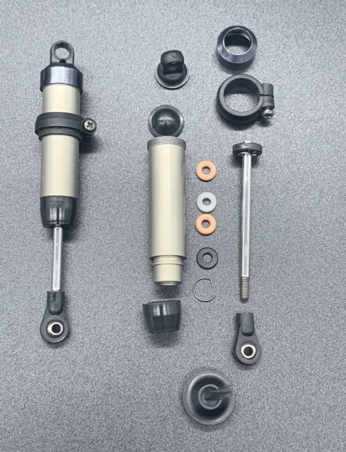

Hello all, need some assistance identifying these shocks.
I have an old Kyosho Lazer that came with these shocks (I’m not the original owner). They look like the Equalizer shocks but they don’t have the 6 sided shock caps. See photos. These have round smooth caps (maybe swapped?). I also thought the Equalizer shocks have a threaded body for the shock collars. These don’t have a a threaded body.

Those do looks like Kyosho shocks.
Equaliser shocks are a bit of a disaster to identify properly because Kyosho produced variants of these shocks under the same part numbers. So it would completely depend on when they were bought. The "H" denotes hard anodized shock bodies, AFAIK, and they also exist with threaded bodies.
For the shock caps, these might have been replaced by the original owner. Black round caps might have been available from Kyosho separately, as their plastic bodied sports shocks (which also come in multiple variations depending on the period they were released in, with no change in part number) use round caps. I've never tested whether those caps fit on the alloy shock bodies, but wouldn't be surprised if they did, since the sports shocks use the same spring diameter as the equalizers, golds, etc.
