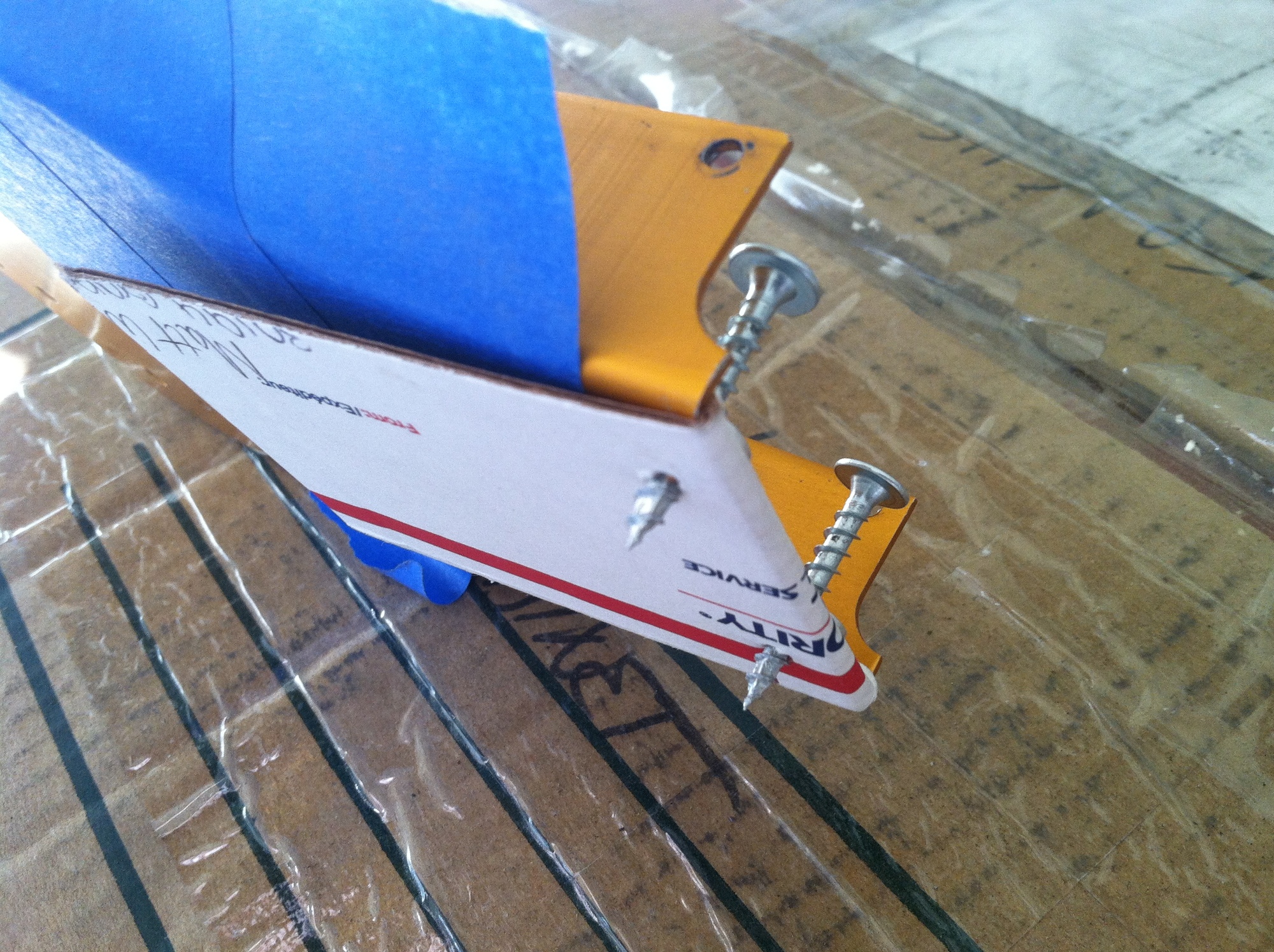

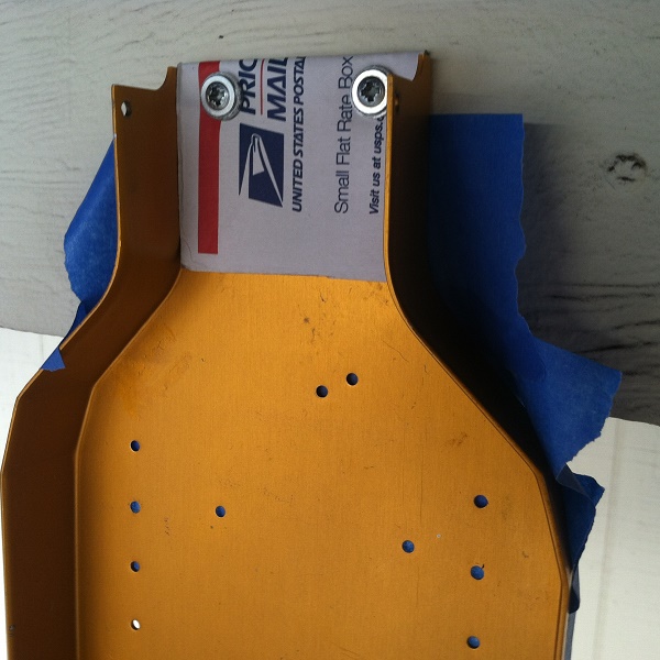

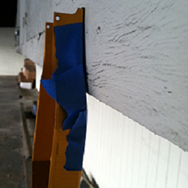

I have not had the best luck with the over the knee approach.
I mount the chassis nose to a wood structure and apply smooth even pressure.

That’s exactly how I do it.
RC10resto wrote: Wed Jan 22, 2020 3:29 pm I have not had the best luck with the over the knee approach.
