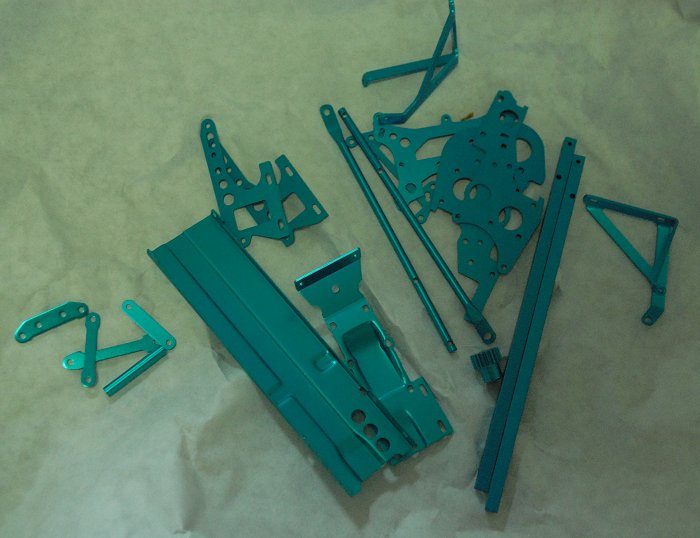

As you probably know, you can't restore worn/scratched anodizing. You can refinish the surfaces and re-anodize it.
I haven't tried this yet but another forum member told me that Easy-Off oven cleaner (the yellow cap high strength stuff) will quickly remove anodizing. Just don't leave it on very long, I'd rinse it off as soon as the anodizing was removed.
The next part I *have* done. Sand the bare aluminum smooth. I started with 600 grit, then moved on to 800, 1000 and 1500 grit, and finally rubbed it down good with some 3M Rubbing Compound. That should give the aluminum a nice polished sheen.
Now, it's ready for the anodizer, who can re-anodize in any color you want.
The attached picture shows a number of parts that I refinished as described, and had them anodized. They were bare aluminum to begin with, but you can see they're more polished than the rest of the parts before being anodized. The 7 shinier parts on the lower left side of this pic are the parts I prepped.

I would assume any good anodizer could get a pretty close match if they have pictures of the original color beforehand.Twin Detonator wrote:Cool, How close of a color can a reanodizer get to the AE Gold color?
I bought all the blue anodized parts in my picture excluding the 7 parts of my own, from pargu2000 in Korea. I shipped my parts to him and he charged me $30 for the anodizing. Seemed like a fair deal, but I'll leave it up to someone else to estimate more local pricing.Any idea on how much it would cost to get the parts redone?
