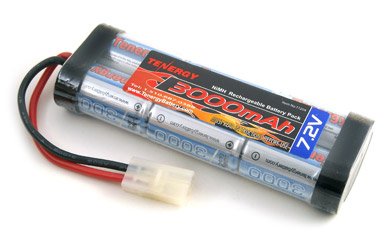

Just bought this truck. I wanted an RC10T back when I was a kid. I ened up getting a JRXT (that I was very happy with) back then. Anyways, I have some Tenergy 6 cell batteries packs and they wont fit. Even when I changed the battery cups to verticle. Any suggestions besides switching to lipo? Thanks< Kennth

is this what you have ?
if so than ya its a hard fit .. you could remove the end caps .. it will help and if you have to put a notch in the battery cup to make room for the wires comming out of the end

Yes it is. Thanks for the help. I guess batteries are larger these days.
Posts: 12185
Has thanked: 1080 times
Been thanked: 3730 times
Re: Need Help. Battery wont fit.
Using more modern cells in a side to side orientation is typically too wide, heck even with the old batteries it was tight. Even front to rear it's going to be long but you can cut out the cup as needed.

nimh cells got bigger as time went on. more capacity, bigger size.
