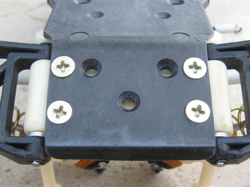

Just got my Klein Arms, just waiting for the other parts to arrive. I Think i'm still a long way to go but already change my slipper set up to B4.
Anyway have a questions though, would the stock Hinge Pins (Front/rear) needs to be replaced by RC10T hinge pins? i saw this somewhere here that it needs also to be replaced. Need to verify.
Can anyone show me a picture of a Graphite Chassis with the nose section cut off? (narrowed) so that i would have an idea how much of the chassis i need to shred to accomodate the RC10T Front bulkhead.
If I use the RC10T front bulkhead and Shock tower, do i need also to put the noseTube for support if im using graphite chassis, coz ive been checking for pic and i dont see anyone who has done this , using RC10T front bulkhead with an installed Nose tubing while using Graphite Chassis? all i see are Tubies or using worlds front bulkhead. Any ideas and pictures would really help. would the modified kick -up handle to horrible 3ple jumps?and not break?

Jun, kamusta? I can answer the last Q, you won't need the tubing. It only works with tub chassis, since there's nowhere to mount it on to a graphite (AE) one.

slow_jun wrote:Can anyone show me a picture of a Graphite Chassis with the nose section cut off? (narrowed) so that i would have an idea how much of the chassis i need to shred to accomodate the RC10T Front bulkhead.
Check out Scr8p's car on this thread. http://www.rc10talk.com/viewtopic.php?f=38&t=10403

here is a pic of nose tube mounts for the graphite chassis

Vintage AE - exactly what i need, any more bottom veiw pics? i need to base where to start to cut the front kink up. would you happen to know the part number of that nose tube and nose tube post/mount (dunno whats its called :lol: ), and also Links to tower.... if any... :D
Scr8p - was this a modified Kick up? seems like its machine cut (perfect).and cant help but noticed , is this composite or Graphite? Sorry I;m not that too knowledgeable on RC10/T.
Checked my RC10 and it seems that it will need a very large modification on the front Kick up, just need to be sure before any dremel kiss my RC10... :roll:
Thanks.... Great thread!!!! indeed.

Bimdapogs wrote:Jun, kamusta? I can answer the last Q, you won't need the tubing. It only works with tub chassis, since there's nowhere to mount it on to a graphite (AE) one.
Bimdapogs,
oks lang, Thanks. when i was running thru the cutting stuff inside my head, seems that it wont be able to handle such bad landings from the track i will run my runner. Thanks to all..... slowly putting the pieces with the inputs and pictures here...
