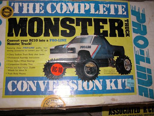

So on my latest acquisition, I scored a Proline Truck conversion.
In going through all the parts, Im missing one of the axles. I did get some similar axles from a friend, but they aren't drilled for a king pin. (If you notice in the following pic, there is a hole drilled.)
(borrowed from Ebay )
Wondering if anyone has one lying around. Also wondering if there are any conversions out there as well as how many conversion kits were made:
Proline, A&L, JG, etc.

Nice score. I'm still hunting for one of those Pro-Line kits.
Andy's also made a truck conversion kit. The axles without the holes are for the earlier 6216 steering blocks.

This thread has some info and pictures of some of the early truck conversions including my Andy's.
http://www.rc10talk.com/viewtopic.php?f=36&t=6148

A Pic of the car, and truck body

The only Andy's monster truck "kit" I know of is the one in Synergy's link, although it did come in a couple of variations depending on whether it came with a clear or painted Jeep or Chevy body.
Andy's also make a molded monster truck chassis and a chassis-mounted truck front body mount, but I don’t think either of those items ever came in a kit. That body mount is similar to the one that mounts to the tubes, but it bolts directly to the nose plate using the body mount hole and two of the front suspension mount holes (using longer screws).
