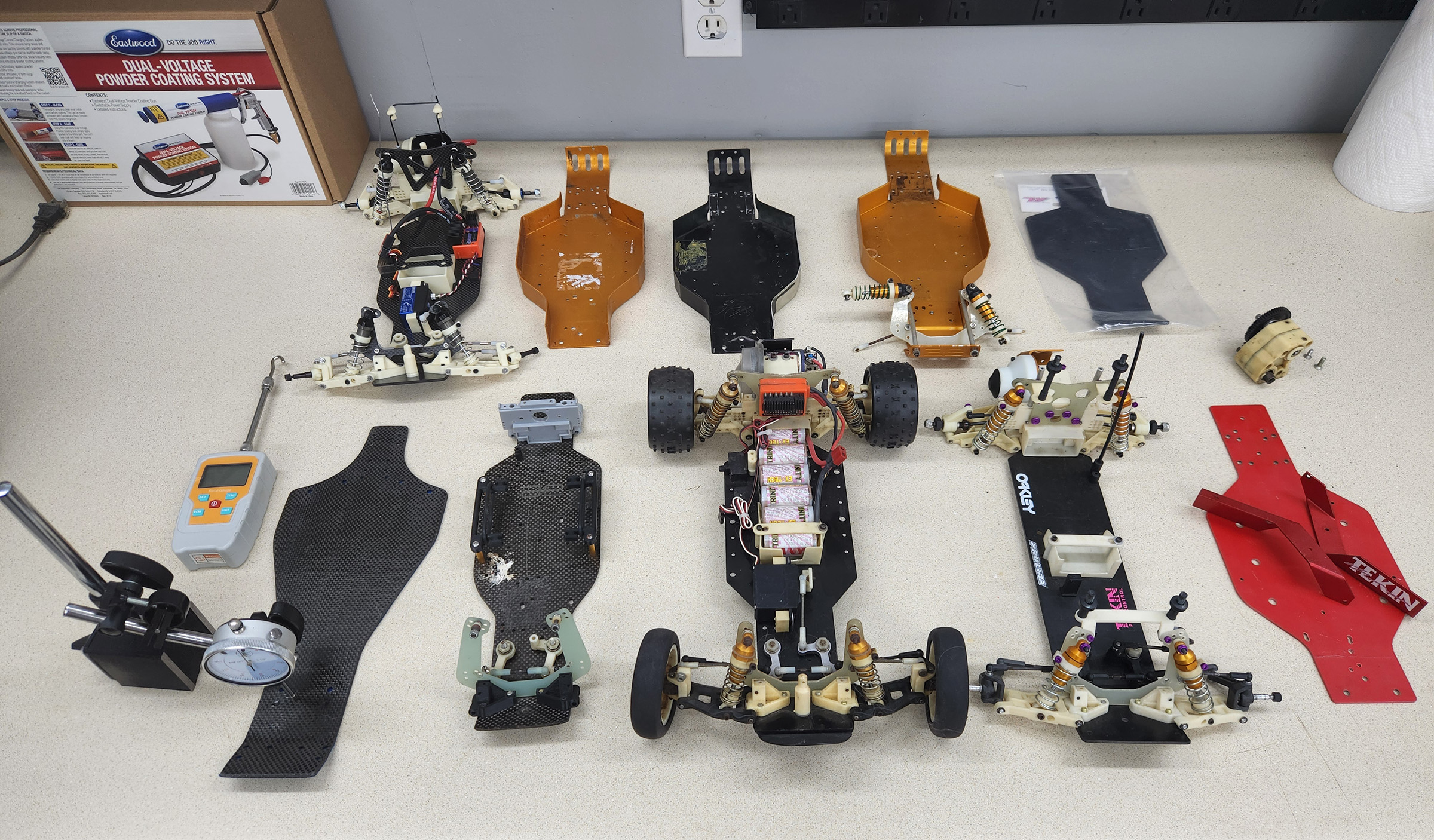

The contestants so far:

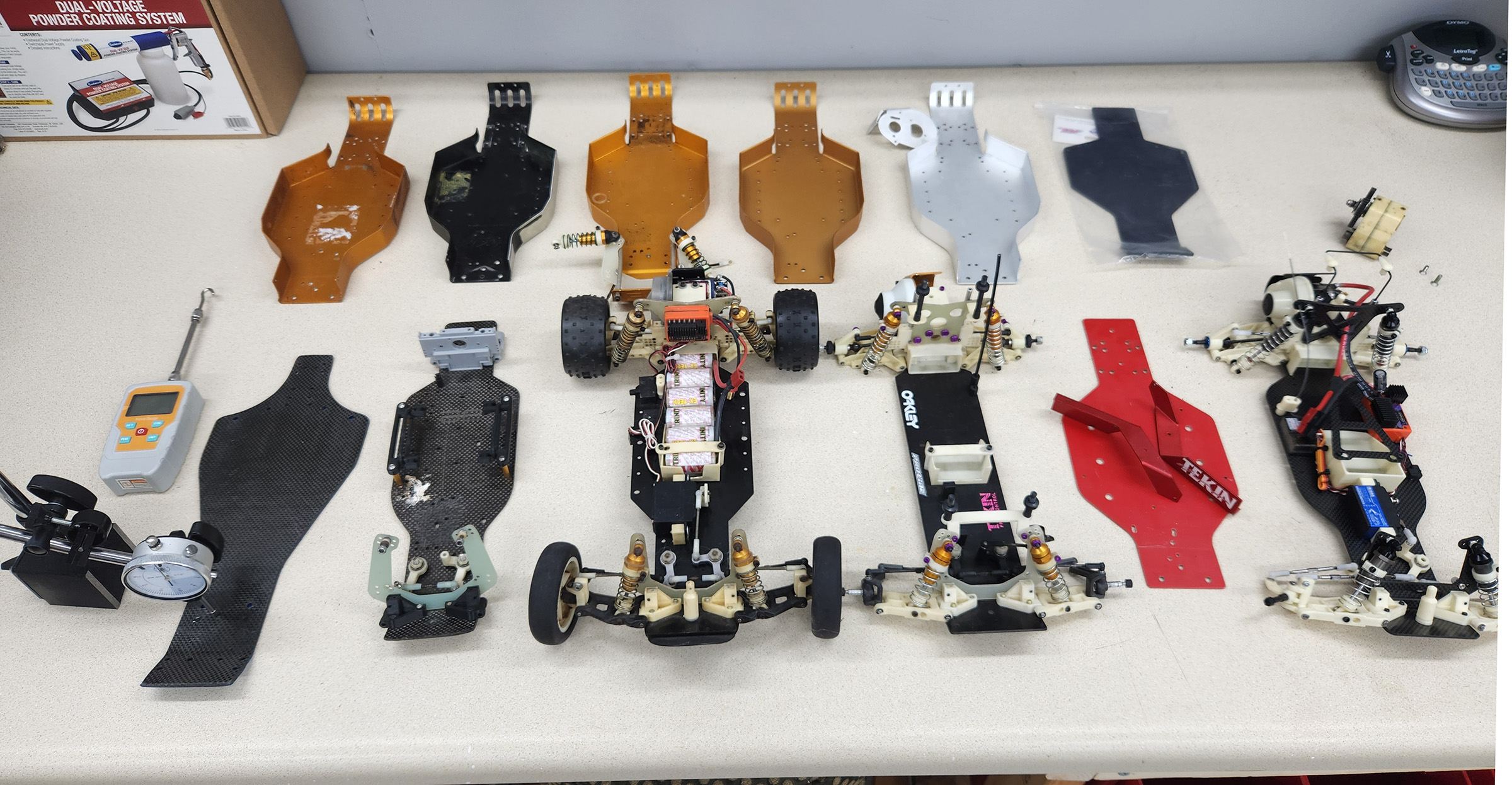

EDIT: added a ReRe and a ReRe stripped to the mix

So, the first page of this post may just be me remembering/finding various chassis. :D I remembered I had a CC oval chassis (on a great project I need to get back into), so that adds an original CC to the mix. I honestly don't know what the straight carbon chassis in the original pic, if anyone wants to chime in.
I know I also have an original TrackMaster oval chassis in pretty bad shape, but if I can find it, it is going in the mix.

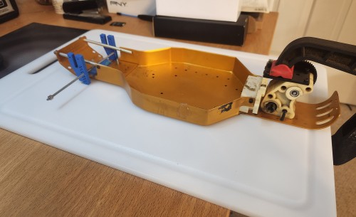

So I got into the testing this evening, and it started off great with the aluminum tubs, but then ran into a snag with the graphites. I am not a physics guy, so I don't know if what I am stating here is correct in the physical world we live in, but I am just reporting what data I have seen.
I started with all the aluminum tubs, mounted as shown above with the transmission brace clamped down, and I was happy with the results. No crazy outliers or anything, just believable data. As I was testing these, the entire rear portion of the chassis stayed tight to the board, and the flex or bend was seen in the chassis from forward of the bulkhead.
Then I installed the AE RC10 graphite chassis, using the same bulkhead / trans / brace set up, and clamped the same way. The initial heights required more force than the tubs, but then the force required seemed to stay the same as I raised the height, and I then noticed that I was "rocking" the clamp backwards and lifting the chassis in the back. Couple of grunts on the clamp ended up with about the same results. The graphite chassis was more rigid, and wanted to remain straight, and would rock/lift the clamp before bending any further. I then altered the testing apparatus and removed the trans combo, and simply clamped the rear of the chassis to the board, and repeated the test. With doing this, the rear of the chassis stayed solid to the board, and the only flex witnessed was in front of where the bulkhead would have been.

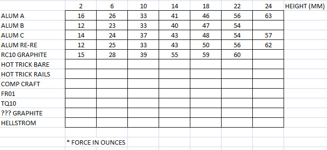

The below is my oz to mm chart in raw form so far. The graphite numbers are with it hard mounted without the trans combo.

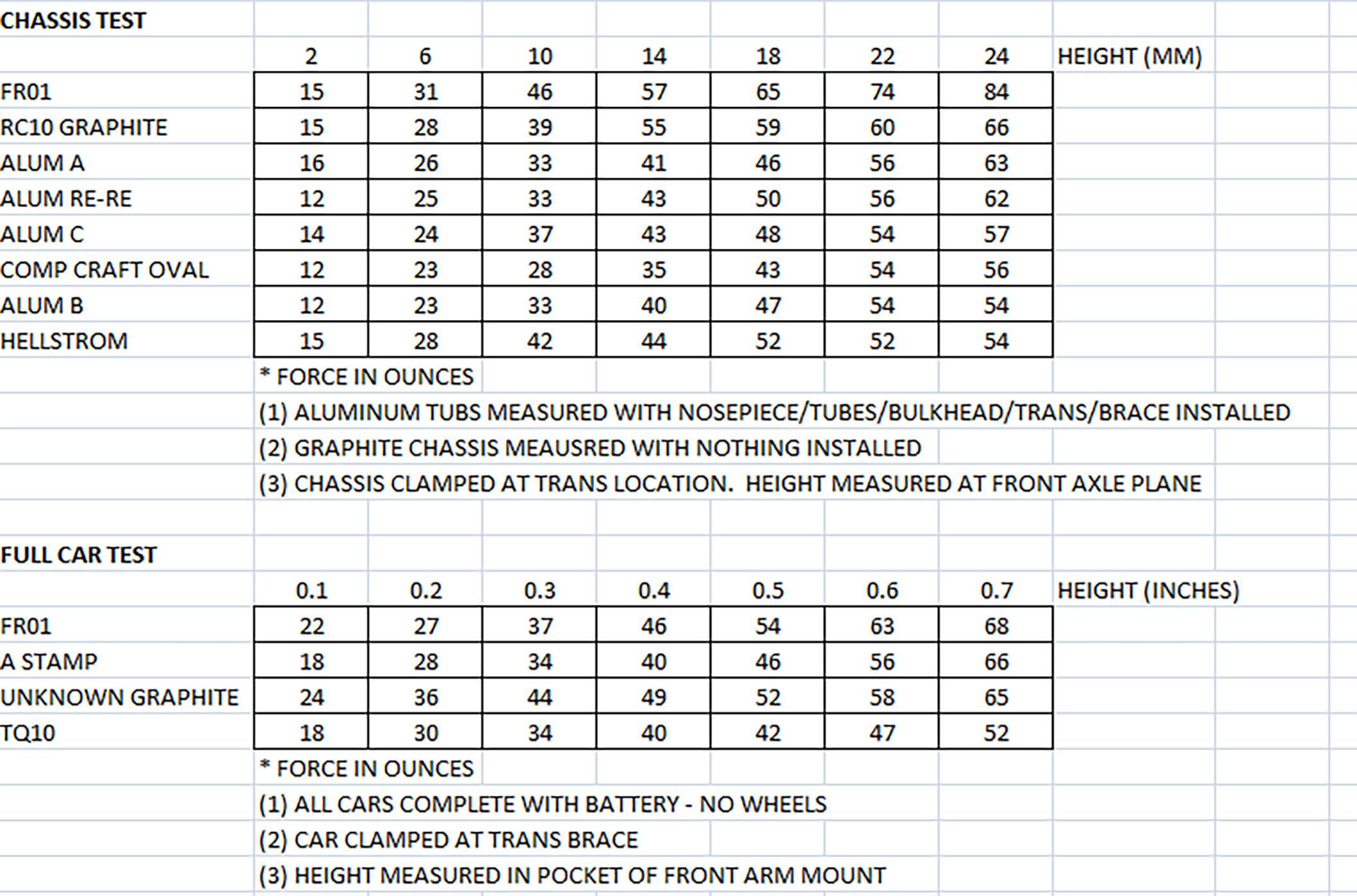

Data. Use at your own risk. I ran the FR01 chassis test twice. :D Weird that as a bare chassis, the FR01 seemed much more rigid than anything else, but as a complete assembly, it kinda fell right inline with the others. The aluminum pans really do benefit by bracing created by accessories; servo and mounts as Dadio suggested, and I even think battery stays help. Hmm, maybe I will run another chassis test of an aluminum chassis just as above, and then add just a servo combo and battery stay.
Again, the whole purpose of the testing, for me, was to determine if the FR01 would flex more than a typical aluminum pan. The methodology here is loose, and no data should be considered truly accurate, but it provided a result for what I wanted to test. The next phase for the FR01 can commence.

morrisey0 wrote: Sat Aug 31, 2024 2:07 pm Data. Use at your own risk. I ran the FR01 chassis test twice. :D Weird that as a bare chassis, the FR01 seemed much more rigid than anything else, but as a complete assembly, it kinda fell right inline with the others. The aluminum pans really do benefit by bracing created by accessories; servo and mounts as Dadio suggested, and I even think battery stays help. Hmm, maybe I will run another chassis test of an aluminum chassis just as above, and then add just a servo combo and battery stay.
The sides of the tub being bolted to the bulkheads essentially acts like a double-decker chassis would.
I find it interesting that everyone likes to claim the RERE chassis is ultra flexible compared to the old chassis but here it is being incredibly close to the numbers from the OG A stamp.
