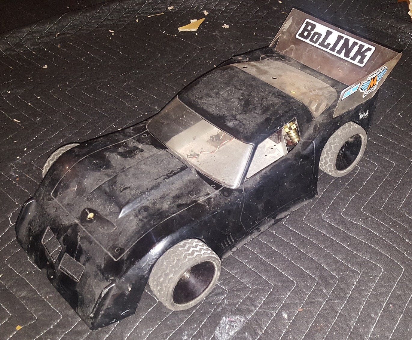

I had a bit of time after painting a few upstairs outside walls to putz with the outlaw for fun,

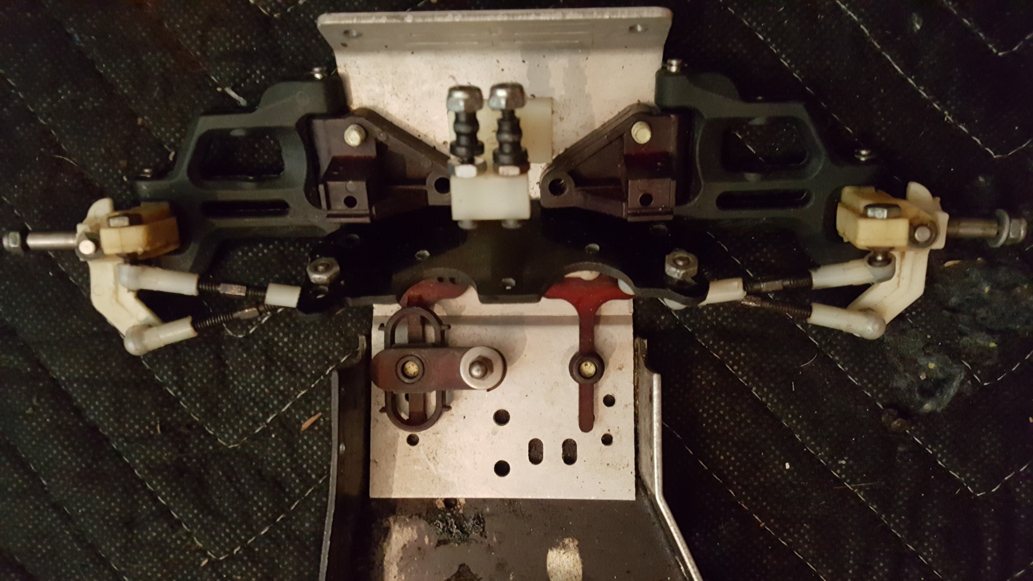

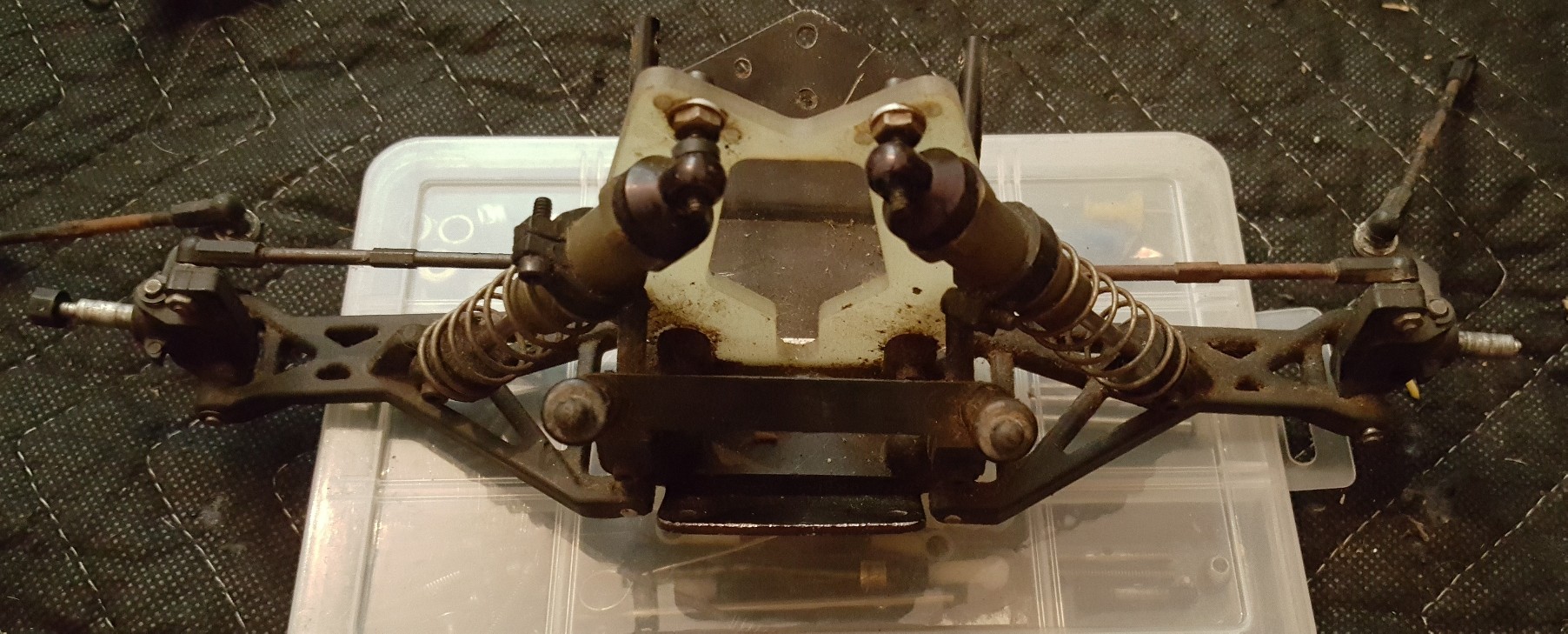

I did use the gold front clip but i didnt trim anything 3 screw holes line up 2 are tapped ill just tap that 3rd one,
Gold front clip
Gold front clip
The WB will be okay since someone way opened up the bodies wells,
Outlaw dirt vette
Outlaw dirt vette
i way should have cleaned the GT before messing with it i knew when i bought it ( 25.00 on craigslist ) it had been well bashed,
Bashed gt front clip
The plate is warped but if you need a piece let me know.

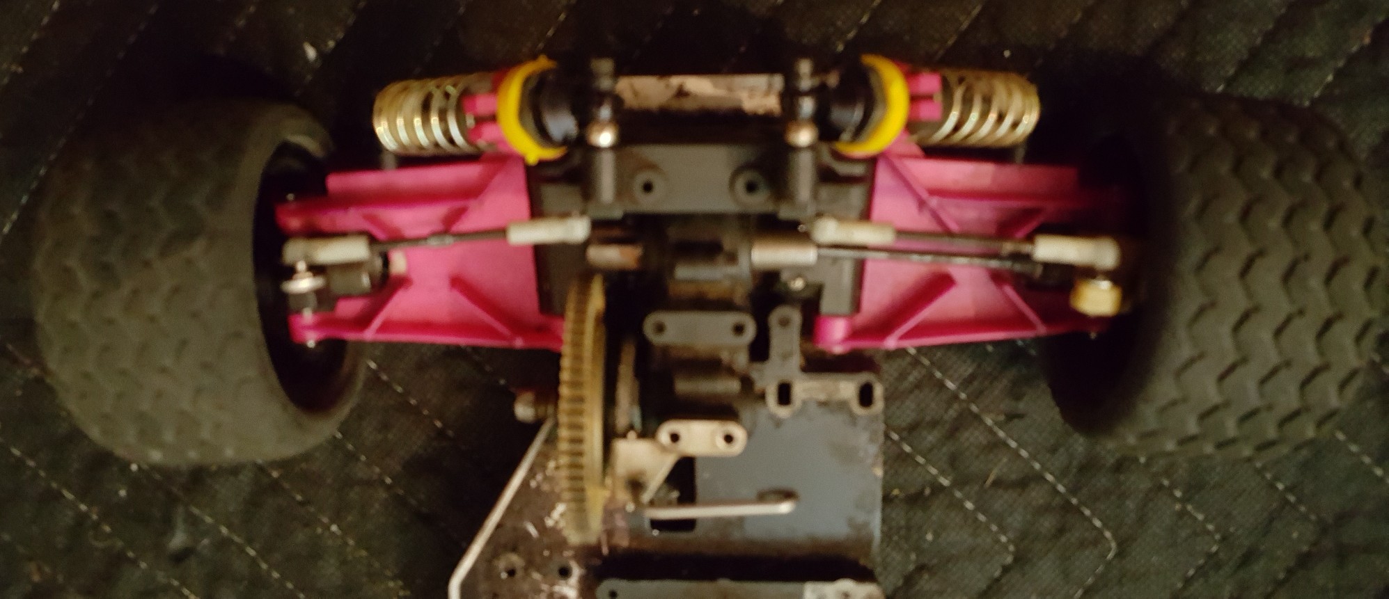

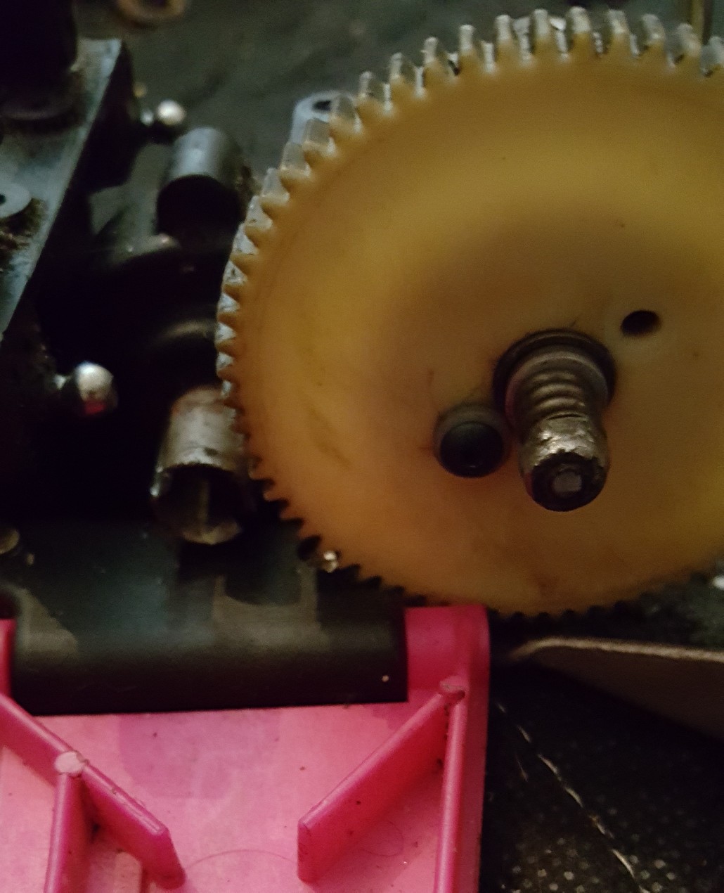

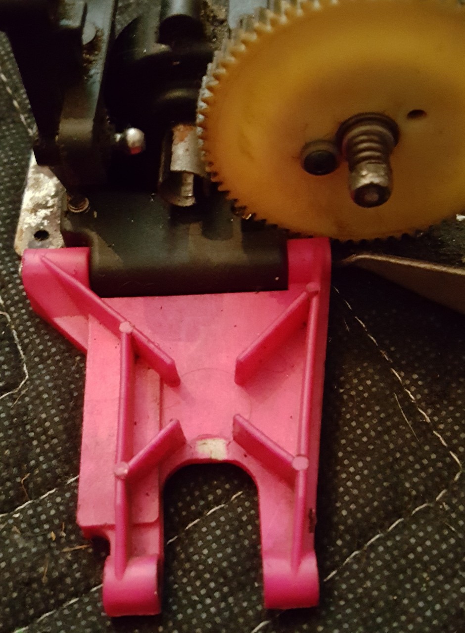

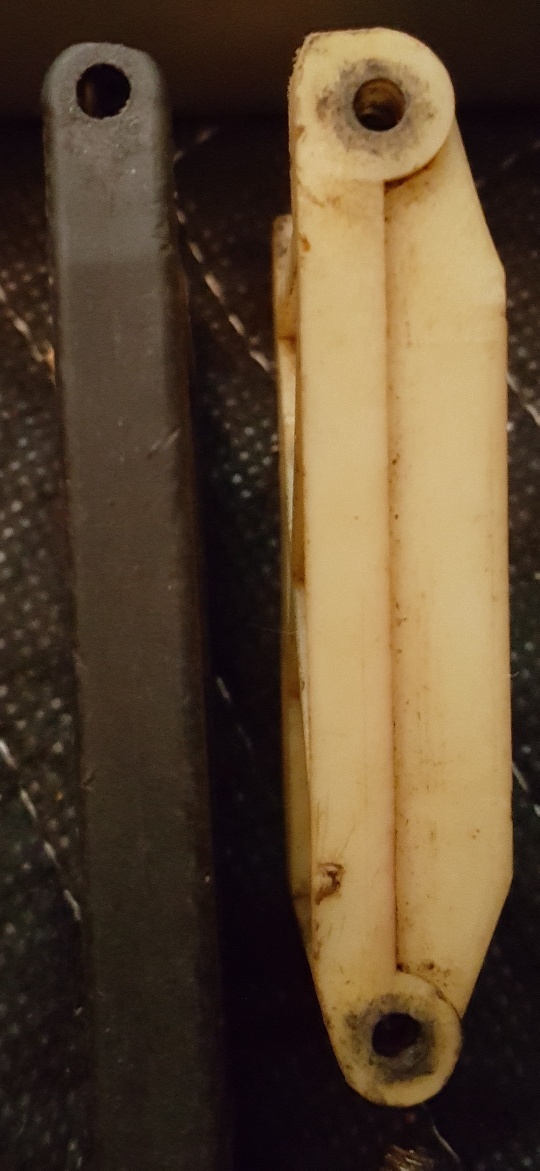

So my questions about rear buggy arms and the arm mount,
When i used a stock buggy arm on the gt mount the spur gear hit it, and no, i havent rebuilt the tranny yet,
I noticed on these pink arms from my boneyard someone trimmed a bit at the pivot area, this does clear the spur, barely,
Arm 01
Arm 01
Arm 01
Arm 01
Here is a comparison, stock buggy arm and GT arm,
The GT arm is far more refined,

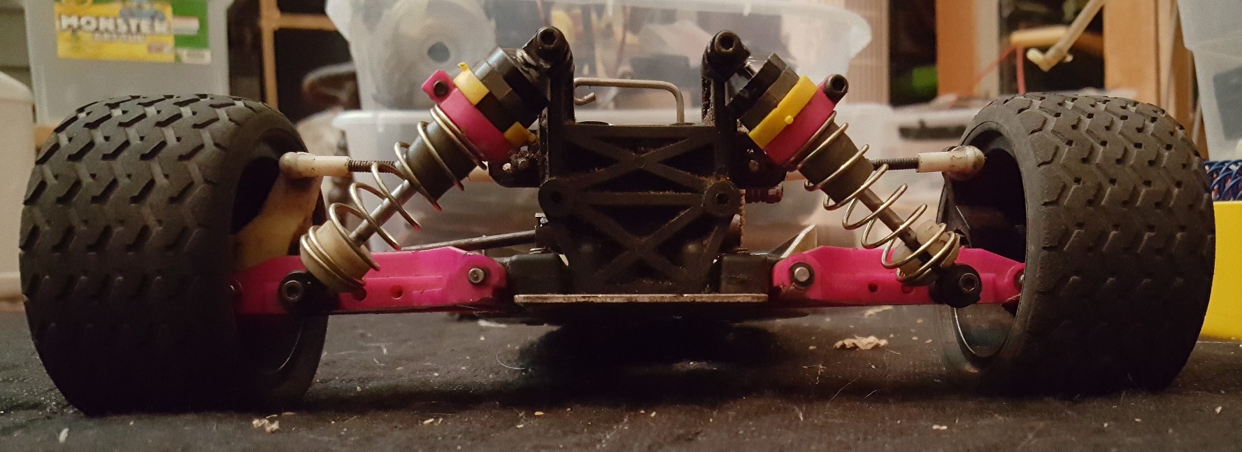

Progress,
Rear custom 01
Rear custom 01
Rear custom 02
Rear custom 02
Im fairly happy with this set up, the shock spaced off the A arm and i just have it mocked up, ill have to rebuild the shocks and use correct springs and oil, use nice spacers
Not sure if ill use the lower shock mounts from the GT, ill do some testing,

It also dawned on me that my body for this project has holes, the rears were rc10 body mounts on the tops of the shock tower the front was one hole that seems to have mounted like a gold tub buggy body,
I have to at least in the rear make a body mount that meets the holes i dont wanna cut more holes,
