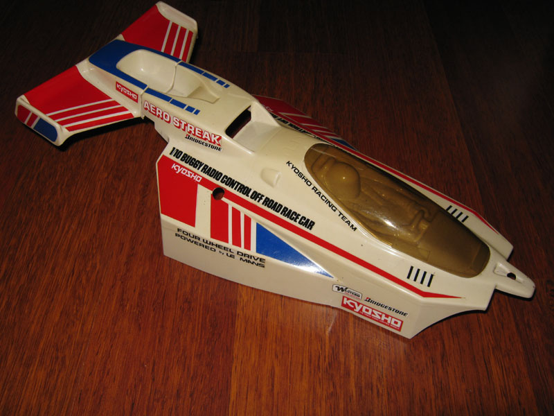

Car is slightly used, with the body being worst off:
The rear wing is attached to the front of the body using two screws, and I'm not sure the body's actually made of lexan - feels like thin ABS or so. It has some cracks in it, is somewhat yellowed, and the driver needs to be painted.

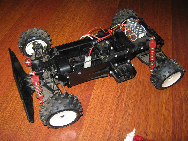

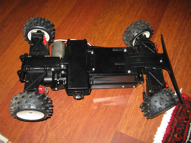

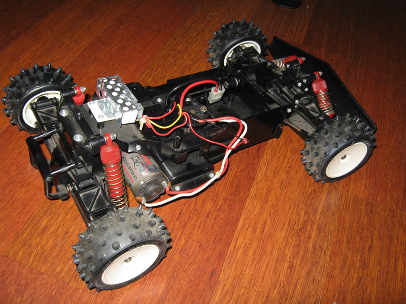

Chassis:
The car has plastic bushings everywhere, and the stock shocks suck. Extremely bouncy with no damping whatsoever. Springs seem way too hard. The front shocks have two mounting points on the lower wishbone. The steering is interesting: it uses a sliding rack instead of the more conventional steering linkages. The battery tray looks lipo-ready (for a 20 yo car!), and should be able to take a squarish pack without too much trouble. The motor sits very far off-center - I wonder what effect that will have on handling. The car has four different gearing options.
The only options shown in the instructions are ball bearings, universals and optional shocks. However, the steering links can also be replaced with turnbuckles, and the rear wishbones have holes for a rear swing bar. The mechanical speed control sits on a removable plastic plate.
Plans:
- front universals
- better shocks, will probably go with the black plastic/alloy units I've left over from other projects.
- ball bearings
- steering turnbuckles
- was there ever a swingbar set for the Shadow? If not, may try making one myself.
- anyone knows whether the transmission can stand a brushless?
