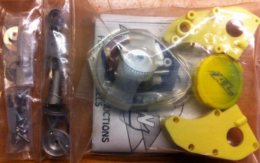

Hi experts, I have a question for you:
I have started to think about my next project, this project includes a NIP vintage A&L Ultima gearbox! Do you think the A&L gearbox will stand up for 9T brushless motor and S2 LiPo? 8)
Cheers

No, but maybe Darryl can chime in here- the NiCad's BITD never saw the same voltage numbers that the last batches of 40a matched NiMih's saw- and the power output of the motor is increased exponentially with input voltage. The peak output ( under 1 min ) of a SCRC 1700 pack BITD was about 8.0v and for every revolution of the motor, that voltage continued to decrease as did motor output- A current nice 20-30c 2S lipo has an 8.44 voltage peak, but the voltage really dances at that point for way in the run causing a more consistant motor output, and more heat, consistant torque throughout the run etc. I think that the tranny would really suffer from that-I would have no trouble running an nice Vintage 15 turn, but not a 9-

I tried mine with a traxxas velineon, made the belt jump even only on a 6 cell nicad pack.

I agree with what Reggie said. Besides, putting 1 1/2 horsepower through a vintage A&L gearbox is kind of crazy ;).

Point taken guys and thanks for the info! But a modern Ultima SB5 gear-box will stand up for brushless motors and S2 Lipos?

A&L Lethal Weapon is the best tranny ever made it will hold up to anything..... Not Really.
Ok -
Traction is a point to think about along with all the other points mentioned.
A properly adjusted power clutch should take up most of the 0 to full throttle starts. The roughest thing on the belt and gears is full throttle landings off of jumps where the tires end up spinning two to three times faster then the forward motion of the car. So that when landing they need to slow down by 50 to 60% at once and the motor tries to keep them going.
I do think that a 9T brushless would be too much, but at the last Worlds Chris went to way back when, I believe he ran 9T and 10T quads on 2000's with out any belt problems.
There is a belt adjustment we used in the LW's, you take scotch type and wrap it around the middle belt idler pulley in the tranny. You want to do complete revolutions - start and stop each application at the same point on the pulley and trim off any type even with the outside of the pulley. I have personally put as many as 4 complete layers on the center pulley to tighten the belt tension. When you put in into the tranny you want to install it so that the belts running over the pulley is rolling the type onto the pulley and not trying to pull it off. This is the hard part to describe, anyway thsi is how we use to get 200 plus runs out of the belts in our team's trannies, they were told to also check the belt tension and keep it from getting too loss.
Hope this helps, depending on the driver a LW could take a 9T brushless - but I would not advertise it could because of all the kids out there that drive like me with just an on/off switch in place of a speed control..... :D :roll: :shock:
If there is a FAQ section or tech section, someone who understands what I just wrote and can make it more understandable to others is free to rewrite and stick this tune up tip for the LW in it.
