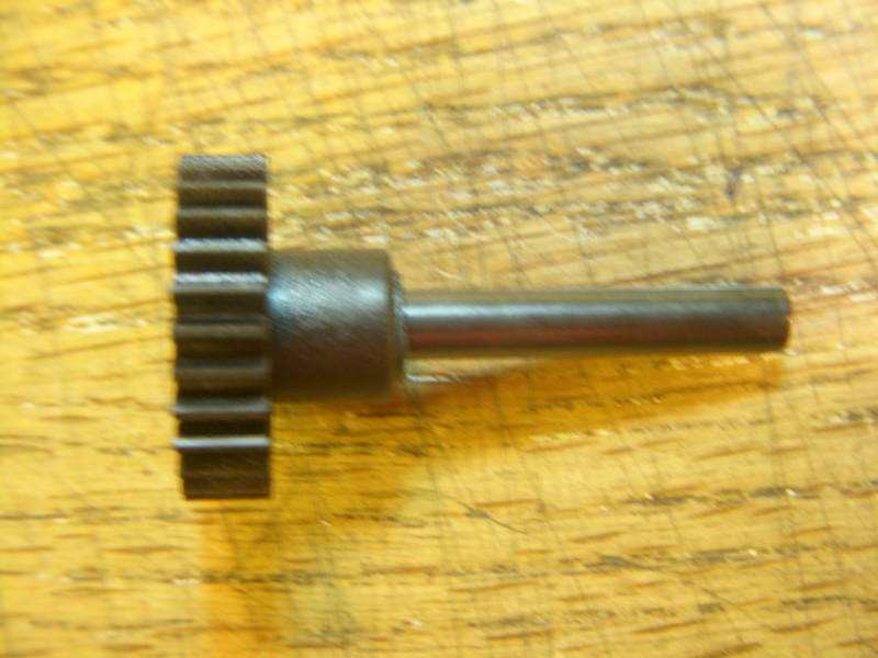

There are two versions of the one with the limiter. There's one with a threaded end for use with a locknut. The other one has the shaft with tapped hole and the limiter is adjusted with a screw. I have no idea which one came first, but I have examples of both in my toolbox.
- Coelacanth
- Posts: 7421
- Location: Alberta, Canada
- Been thanked: 325 times
Re: Need some tech advice re: Turbo Optima gear upgrading
You used an impact wrench on a 1/10 RC car??
Man, you wanted that sucker on GOOD, didn't you?
Here is what was originally on my Optima, and the version of OT-74 that I saw on eBay that I *don't* have. The one I bought has a much beefier, single spring instead of that strange springy-washer thing you see in the attached picture, held on with an e-clip. So, there appears to be at least 2 variants of the limiter gear assembly (the original Optima part isn't a limiter of any sort).
