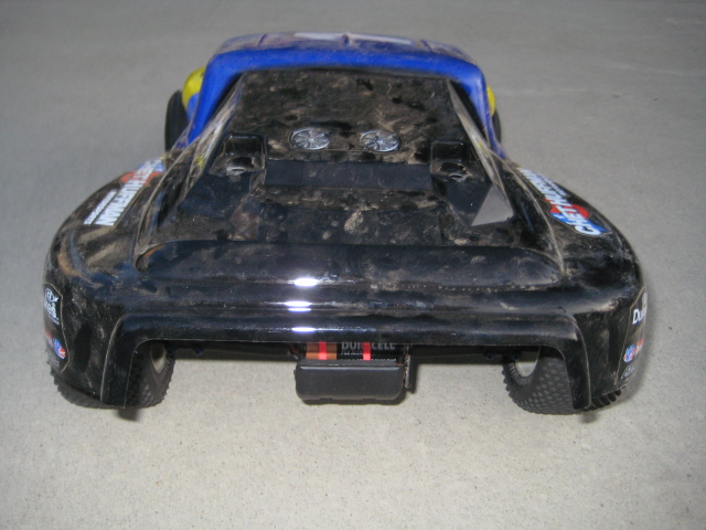

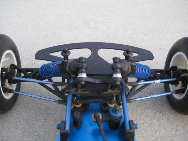

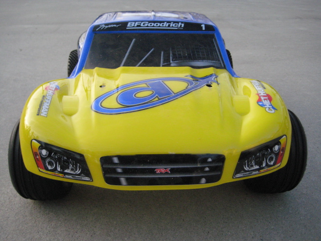

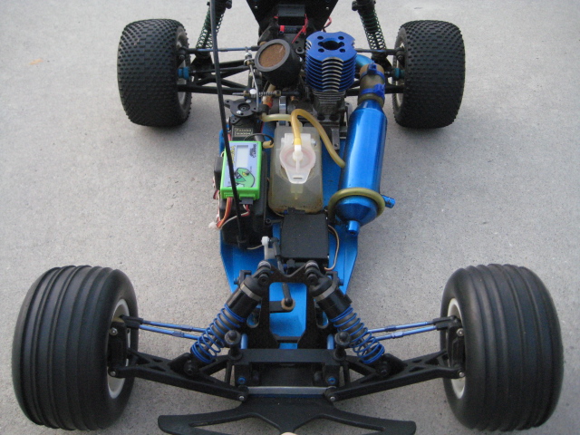

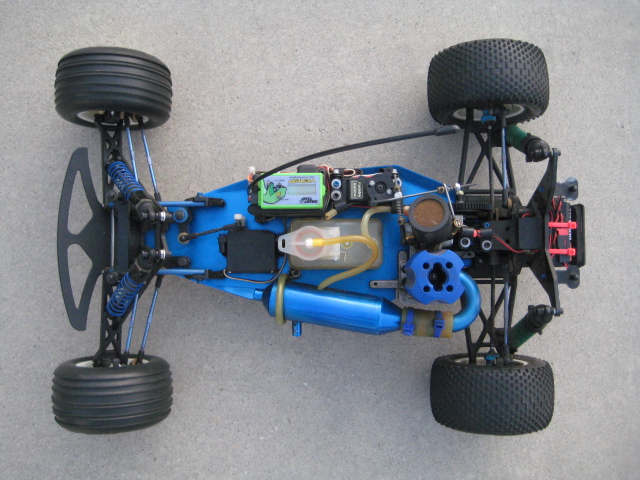

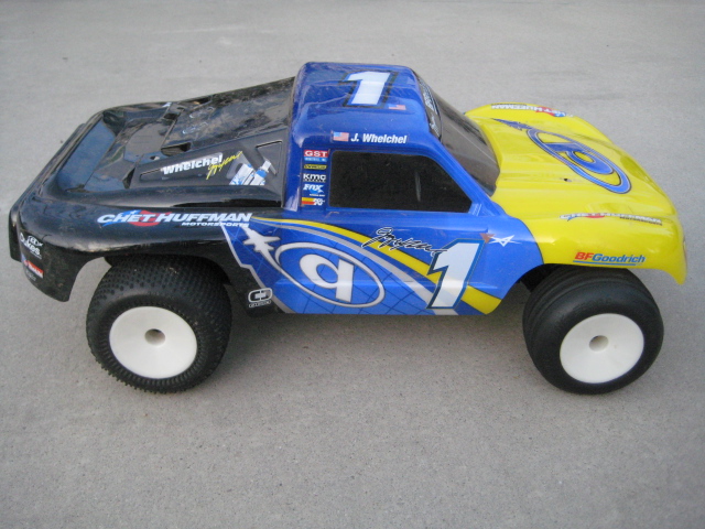

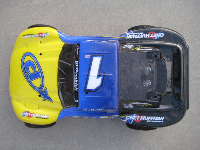

Ok, I can't possibly be the only one who's ever thought of doing this.
Ignore the tires & wheels, that's an easy (Proline) fix....
Wheelbase & width are perfect (w/short course tires & wheels)
A front & rear bumper should be easy to fabricate or modify, body mounts are simple.
I know the front looks a bit odd, but it's got zero bump steer!
Absolutely nothing has been cut or modified at this point...
Imagine how cool a 2WD nitro SC10GT would be!....& it won't fall apart!
Zero bump steer
Zero bump steer

im starting to look for another gt runner to mod i thought the frame still needed to be extended like the rc10t

wow, I just assumed the chassis would have still been too short. Sweet low buck mod!

giggles wrote:im starting to look for another gt runner to mod i thought the frame still needed to be extended like the rc10t
All you have too do is flip the FT arms, shim the upper shock mounts a hair, and do a little adjustment.

I have done that before just to try it, but not to fit a SC body. But that was long before there were SC trucks. Pretty cool. I may have to pick up one of those bodies. 8)

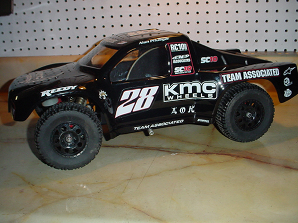

Any problems with the SC10 wheels?

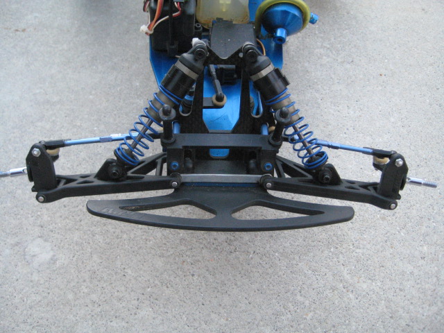

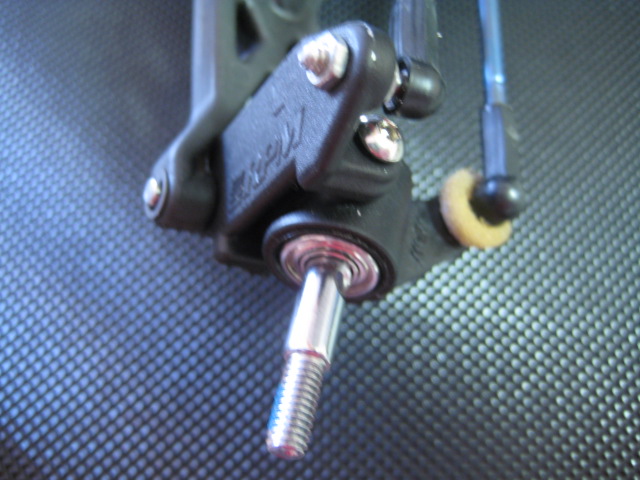

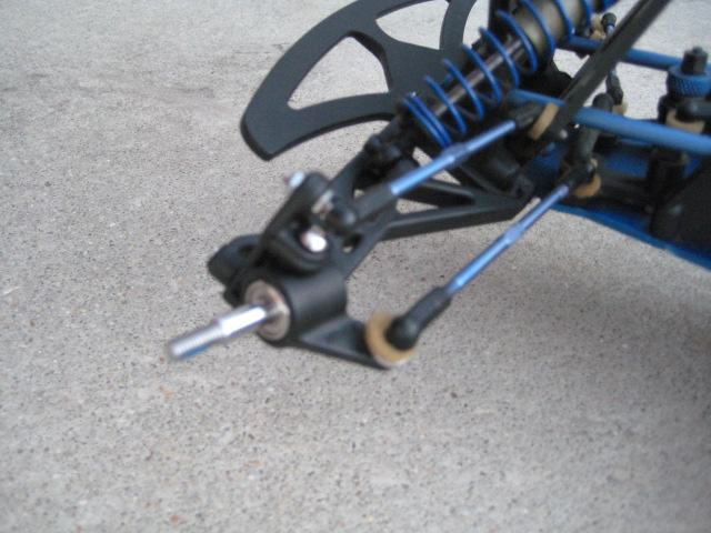

Took a break from the Sand Scorcher build.
Finished up modified front end. Will do alignment later.
Now GT will have same wheels as available for Slash. (and stronger too.)
Hope to pick up beadlocks & scale BFG's soon!

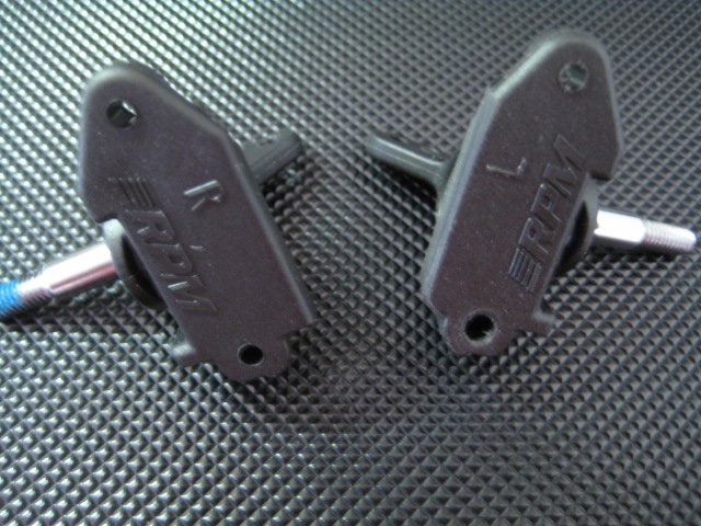

Modified RPM carrier on RT.  Drilled 1/8" lower hole to use Associated pins
