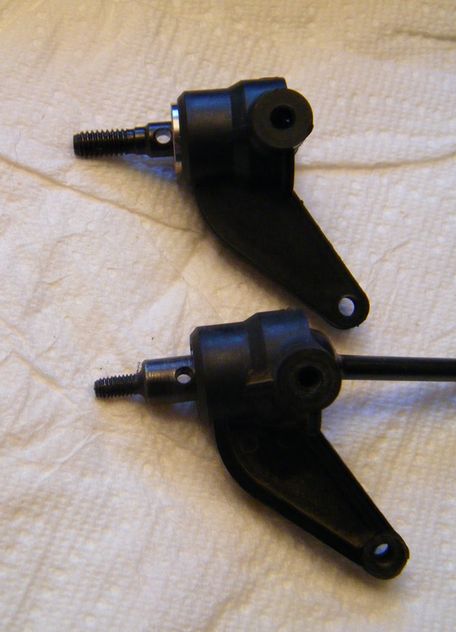

Well, I got the parts in and I have good news, and I've got bad news. The bad news is it looks like it won't work for rear axles. I made the incorrect assumption that the 5x10 bearing would have the same thickness as the 6x10 - when in reality, the 6x10 is 3 mm thick and the 5x10 is 4 mm. Blatant oversight on my part - but this additional thickness basically causes the axle to be too short (so, possibly the RS4 MT axle will work in the rear...need to get one to verify). I do not know if 5x10 (3 mm thick) bearings exist, but a quick search did not yield anything too promising.
However, the good news is that with the additional thickness, it looks like the axles will work in the front. The only drawback being that the Yokomo wheel offset does not match up with a standard 12 mm hex - by about the tune of 2-4 mm wider - so may have to play around with thicker/thinner ones to get the appropriate overall width.
Also, the other bit of good news is that it looks like rear bones, combined with these axles will work in the Tomy Intruder. So for those who own an Intruder, this provides a viable alternative to the old school Yokomo setup.
Anyways, for those interested, the HPI PN is 80824 for a set of 2 axles. Tower Hobbies has them http://www3.towerhobbies.com/cgi-bin/wti0001p?&I=LXAFM4&P=7, and they can be found on eBay as well (depending on where purchased can be as low as $5.50.

So, it's been a while...but finally got the RS4MT rear MIP CVD axles. This was purchased for another project - but I thought I'd go back and take a look at this again. These are a perfect fit for the rear hub carriers (when 5 X 10 bearings are used in the hub carriers). They are 1 mm thicker, but the additional axle length for the RS4MT matches - so, you can now use 12 mm style hex adapters. You could also try some 14 or 17 mm adapters intended for rim adaptation on the Rustler/Stampede (14 mm is the Schumacher size and 17 mm is the older Intruder style). Need to play around with different wheel manufacturers to see if I can find one that puts the track width the same - but very happy these match. The HPI PN for these is 80818.

I've been playing around with the yokomo for replacement axles and shafts to use hex drives and modern wheels. These were for a buggy(870c), but the same principles apply.
I've found that TC5 CVA assemblies work very well in the 870c hubs, and judging by your pictures, look extremely similar to what you have. They are also 6mm in diameter, so you wouldn't need to change the bearings to a smaller size.I've found that these will probably be the best investment, although I will have to stretch the dogbone ends, and utilize 6x10mm flanged bearings in my case.
I know that the tc5 dogbone fits very nicely in the 870c drive cup, it appears to be made for it. If the bone length is correct, this should be practically bolt in affair, as long as yokomo didn't change the drive cup.
If you'd like some dimensions or anything, let me know. The CVA cup part is on the axle, and this assembly seems to have the smallest diameter cvd I've seen yet. smaller than standard MIP, which is smaller than what I think is an hpi cvd(non-mip). I have what I beleive to be HPI parts, but I cannot seem to find another pair like them.
