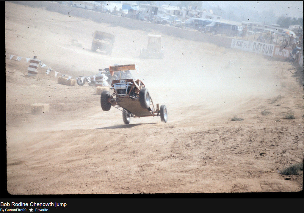

And I found a nice action shot to, enjoy!
Cheers
