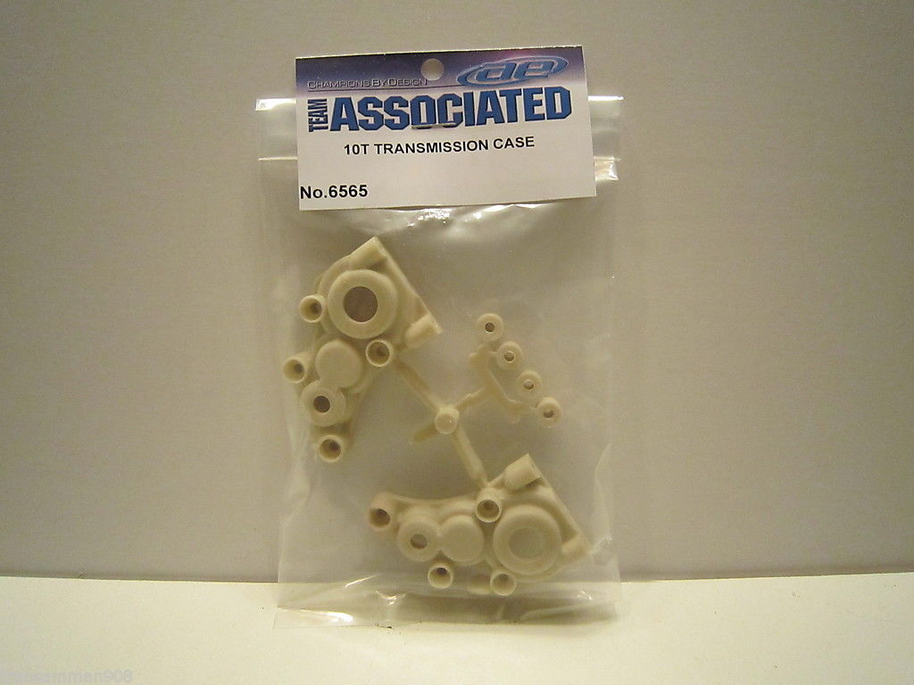

I was thinking of fitting the pulley to the stealth, and was wondering how you guys did it.
Did you drill a hole in the center, grind down the protruding part and fit a big ball bearing in there? If so, what size of BB did you use? I suck at measuring things in other than metrics

that's the re-re case, which makes things much more difficult. it is better to use the US case (6565?) which already fits the bearing if you can find it.

I don't think you have a choice. Pretty sure you have to use the 6565 case.

Yeah, that's the one you'll need. Check Associated's site, I would think they should still be in stock.
