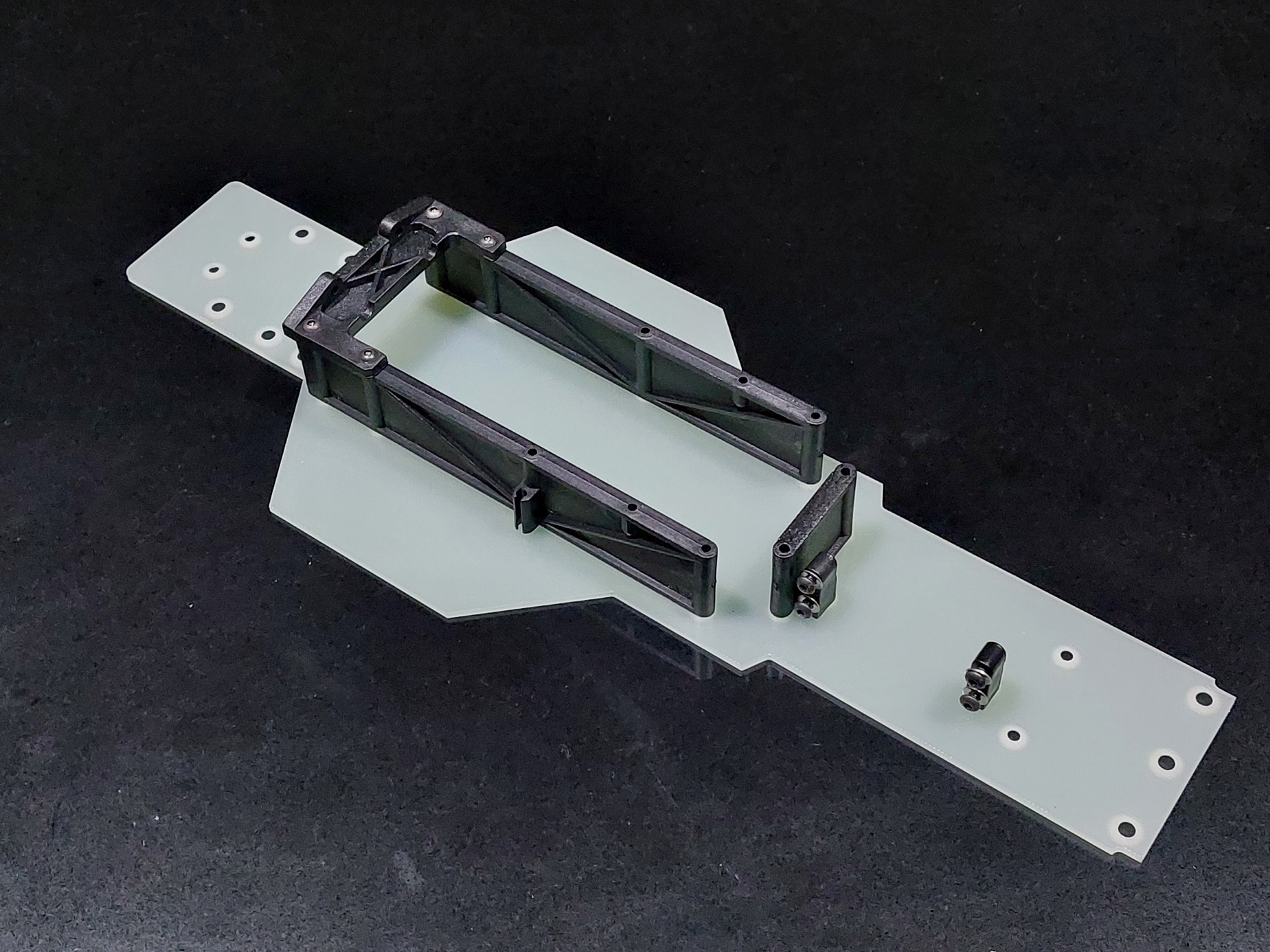

Tonight's progress....
Out of the three of these kits that I built this one is by far my favorite chassis kit. The fiberglass is fairly translucent and has a nice texture to it.
Unfortunately I didn't have the header card for the battery box as I ripped it apart when I pulled it out to dye the nylon black
Steering assembled per SRT instructions, it looks good but I might possibly have to play with the height adjustment slightly for bump steer, we'll see when it's closer to being finished.
Front end pretty much done

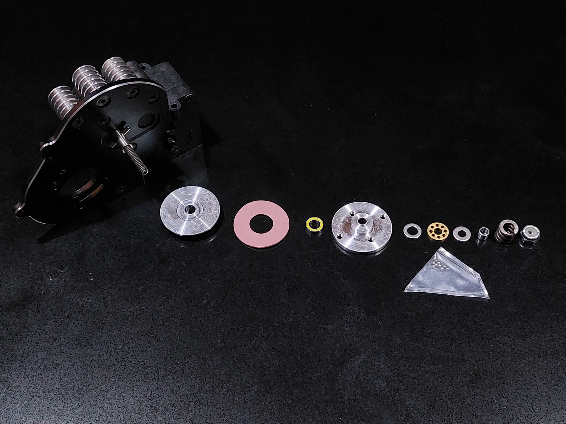

Since I originally planned to build this as a "period" racer I bought an A&L/Factory Works Power Clutch to go along with the theme.
I've never had or seen one before so here it is for those interested like myself.
Looks pretty good assembled. It definitely has that engineered feeling to it.
