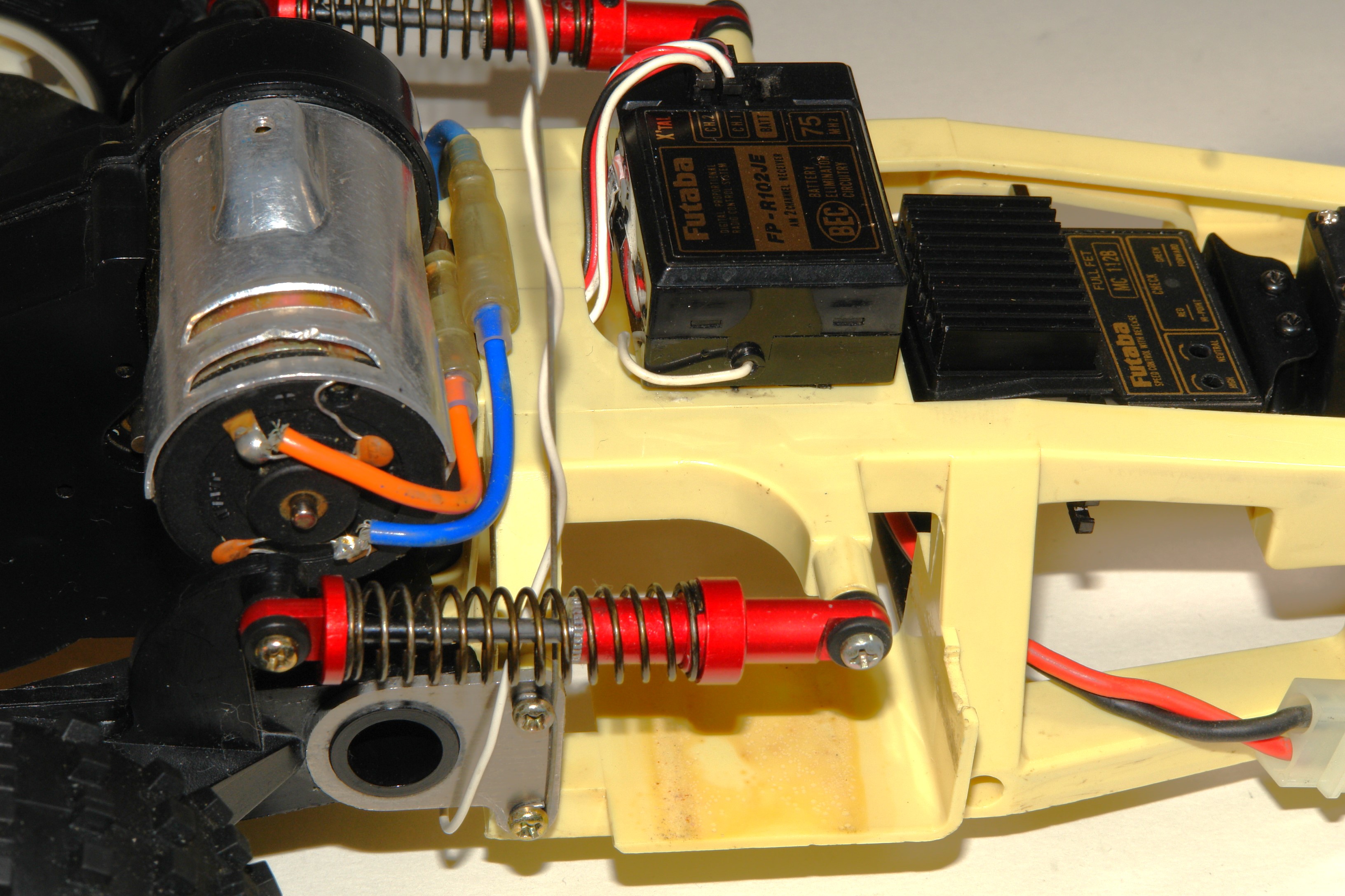

On my Playtron Doberman I mounted a 112b.
My motor wires are orange and blue.
I have the orange as positive and the blue as negative.
It's hard to see but the upper connection on the motor is labeled +
Edit: Hard to beat GoMach to the punch :)
Chuck
