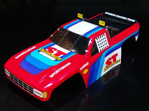

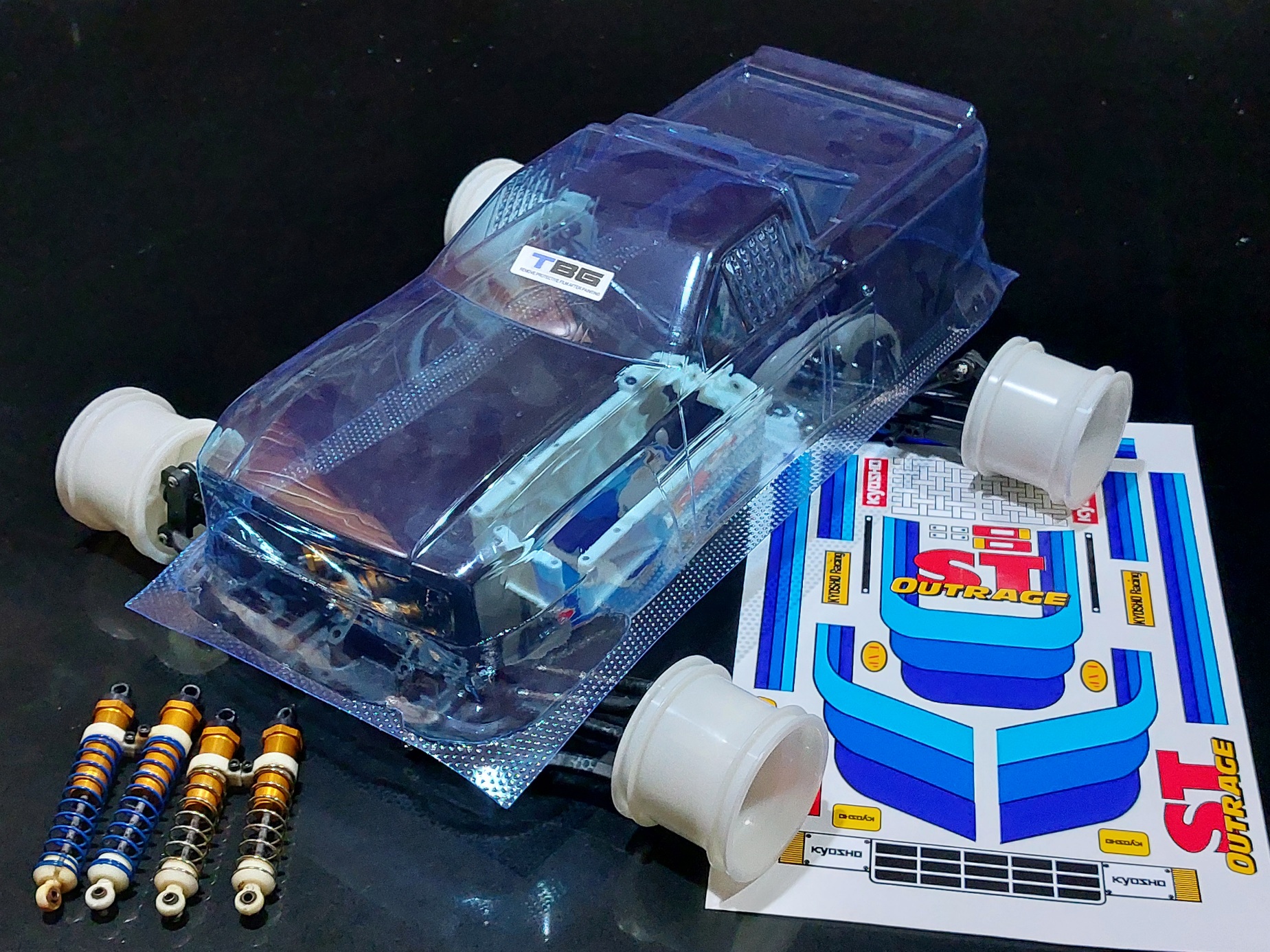

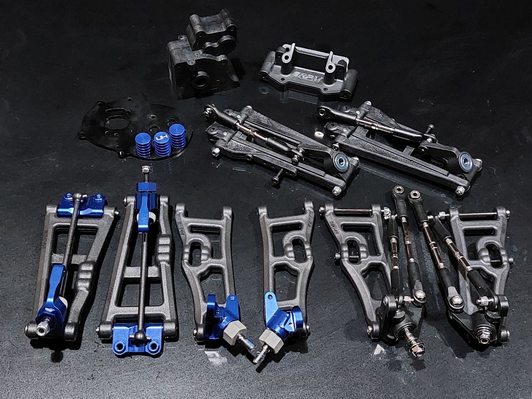

Well, with my pile of parts it turns out I have collected enough parts to put together 90% of another truck. I always liked the looks of Kyosho ST's, so this is the hodgepodge I came up with.
It's basically left over Tra**as parts so you really couldn't call it a Kyosho. However, it would look very similar to this.
This is another body I'd like to get.....
The Outrage is a bit shorter than the SRT so I'll have to make a shorter chassis to accommodate the body, but that's easy enough to do.
Now the question is to use stock black parts and gold shocks to keep it looking Kyosho or use the fancy blue parts that don't really fit the theme? I'm leaning towards stock black plastic :D

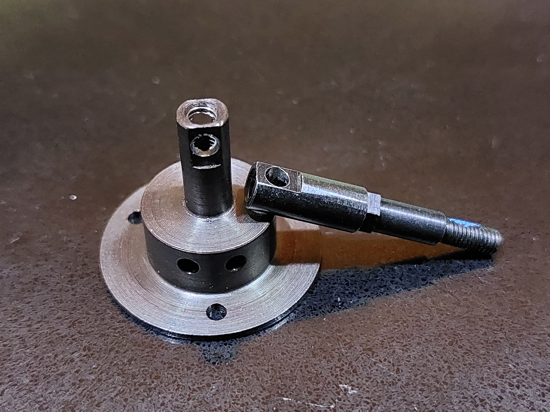

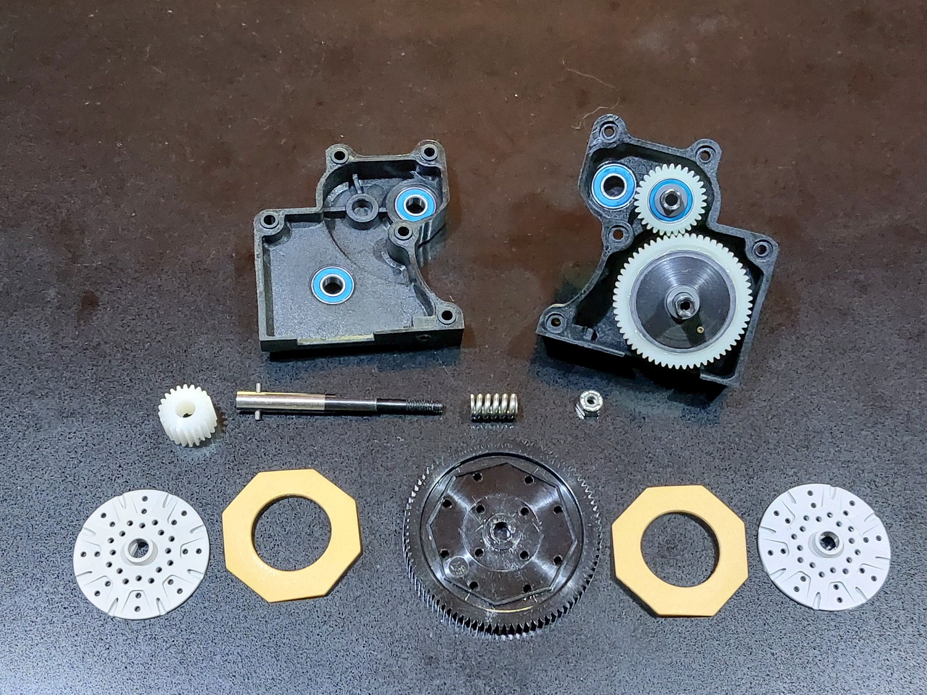

Gearbox time !!

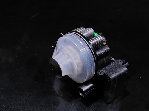

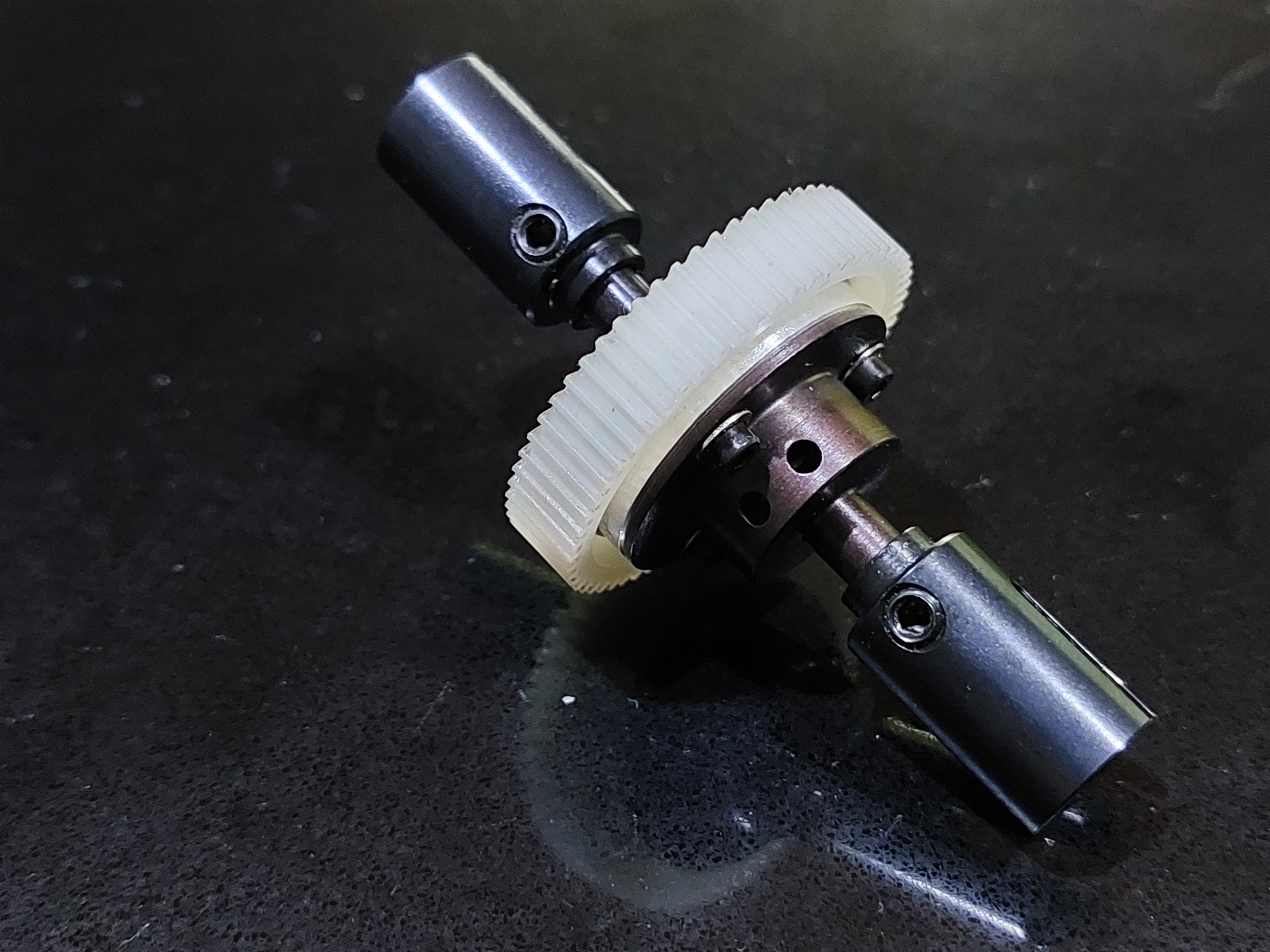

I bought another 4620 diff for this truck and I attempted to drill out the output shafts which I wanted to do with my race SRT. Needless to say it turned out a lot better then I was expecting.
This diff feels better than the other two tra**as diffs that I built, go figure. The only difference is that I forgot to order carbide balls so they are just chrome steel. I'll order a set of carbide or ceramic for the next rebuild.
I've decided to try all nylon gears again, so we'll see how they hold up since this truck will have healthy boost and turbo settings. The top shaft is an Avid AE conversion top shaft, POM gear, Team Brood magnesium slipper plates, and AE slipper pads.

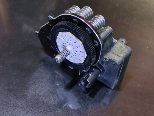

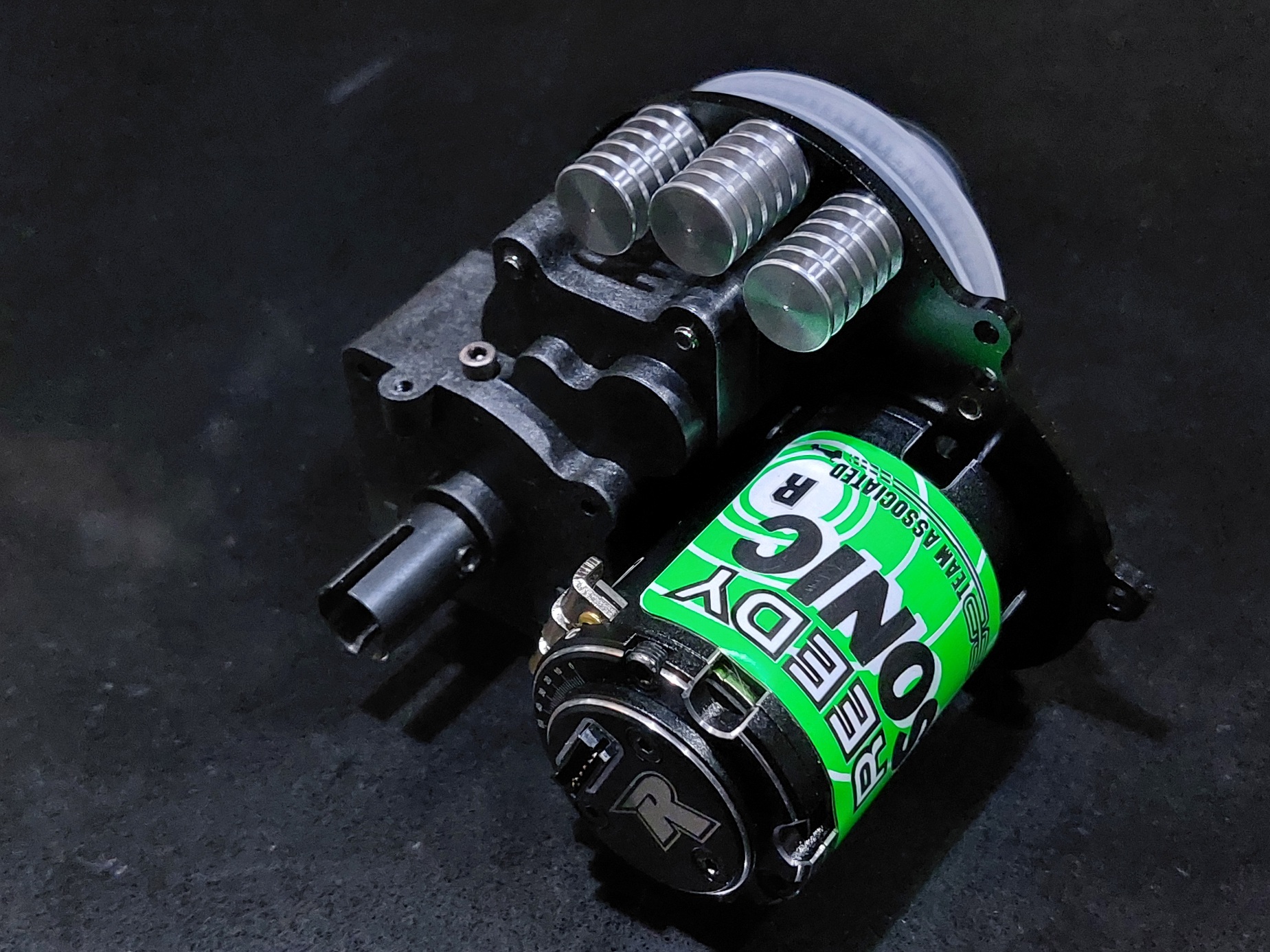

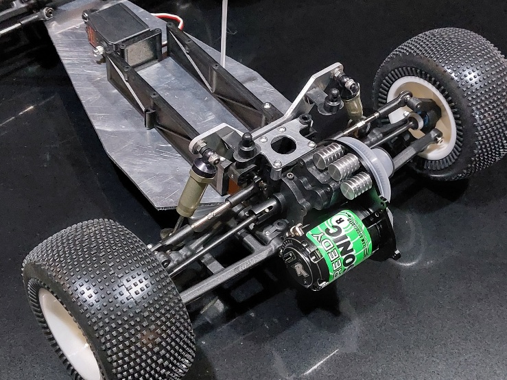

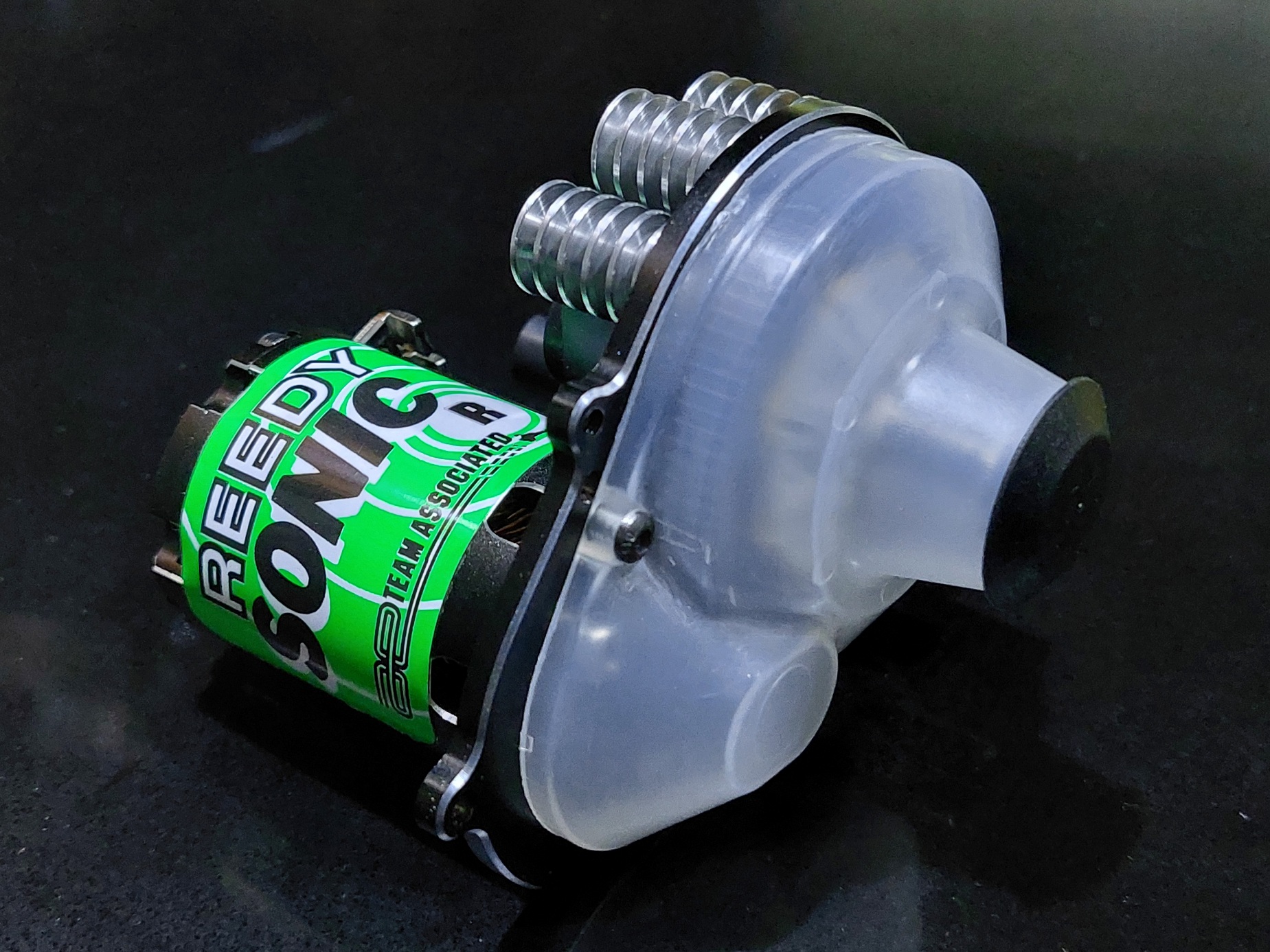

The early tra**as gear cover wouldn't fit so I had to come up with another option, why not try a B4 gear cover of all things?
Sure enough it fit with a bit of drilling and tapping and it clears a large 87 tooth spur so plenty of gear options.
I'm not sure if this will be the motor I'll use or not but I like it, it was the motor I bought for my race truck before I found out they were running boring old blinky 17.5's :roll:

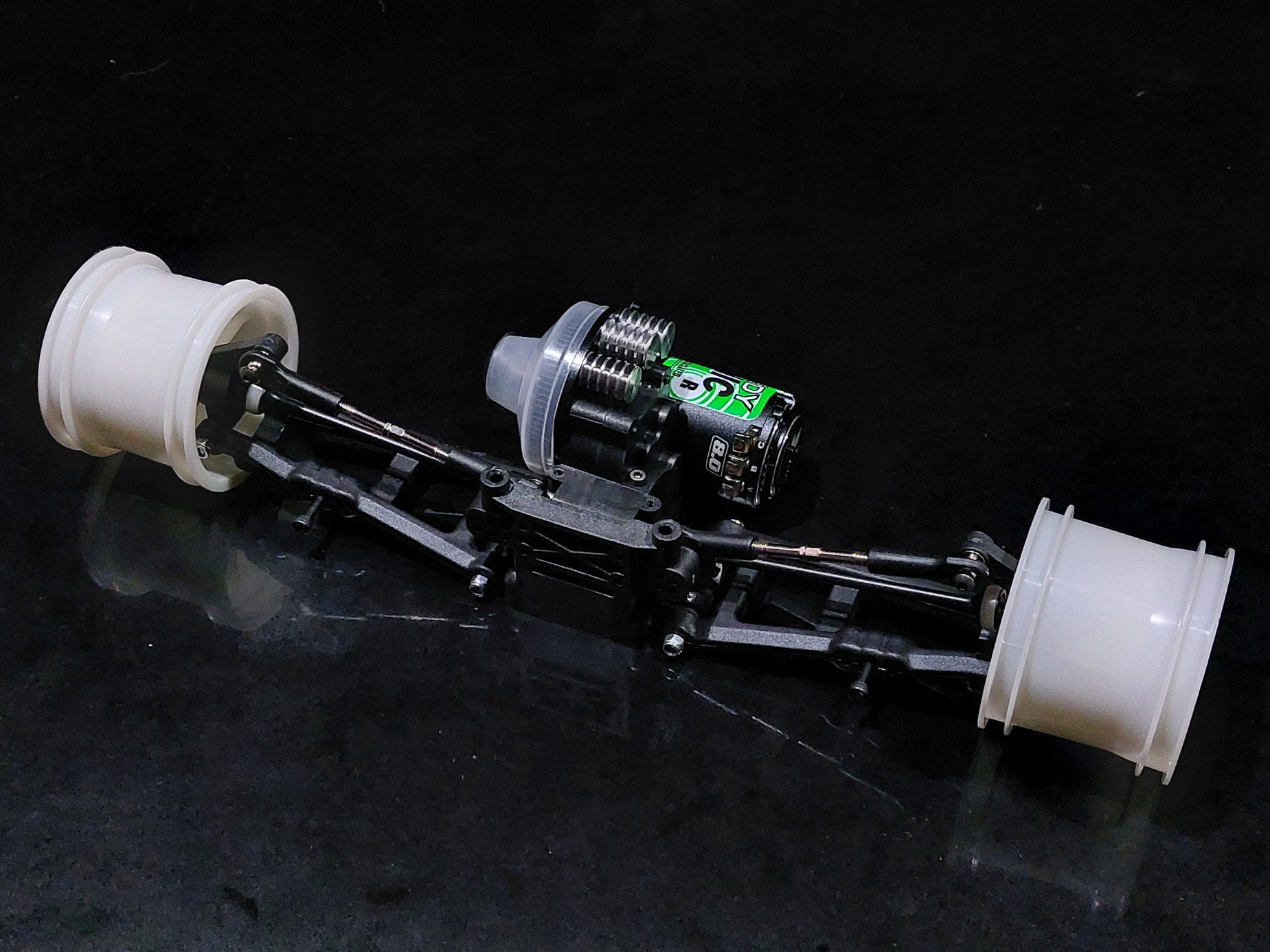

Rear driveline sorted, I'll probably have to hit Jeff up for a few parts soon-ish.
I can't really do much about a rear shock tower until I get a chassis made to see how the body fits. I'll probably have to make a custom lower tower as the back of the Outrage body is quite flat.

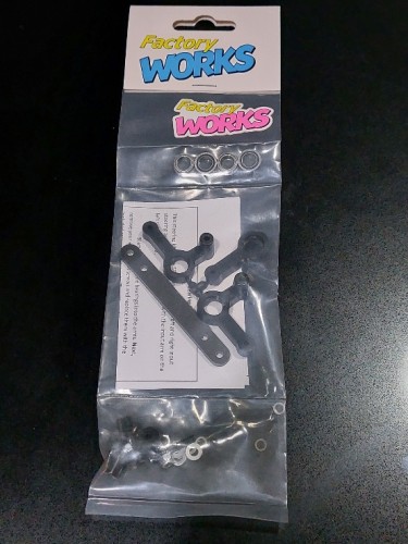

Another piece of the puzzle, incognito black steering set from Factory Works. I'm struggling to find someone who has 2.5mm black G10 here. Ebay has G10 sheets but they are all 300mm and I need 330mm :roll:

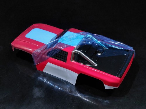

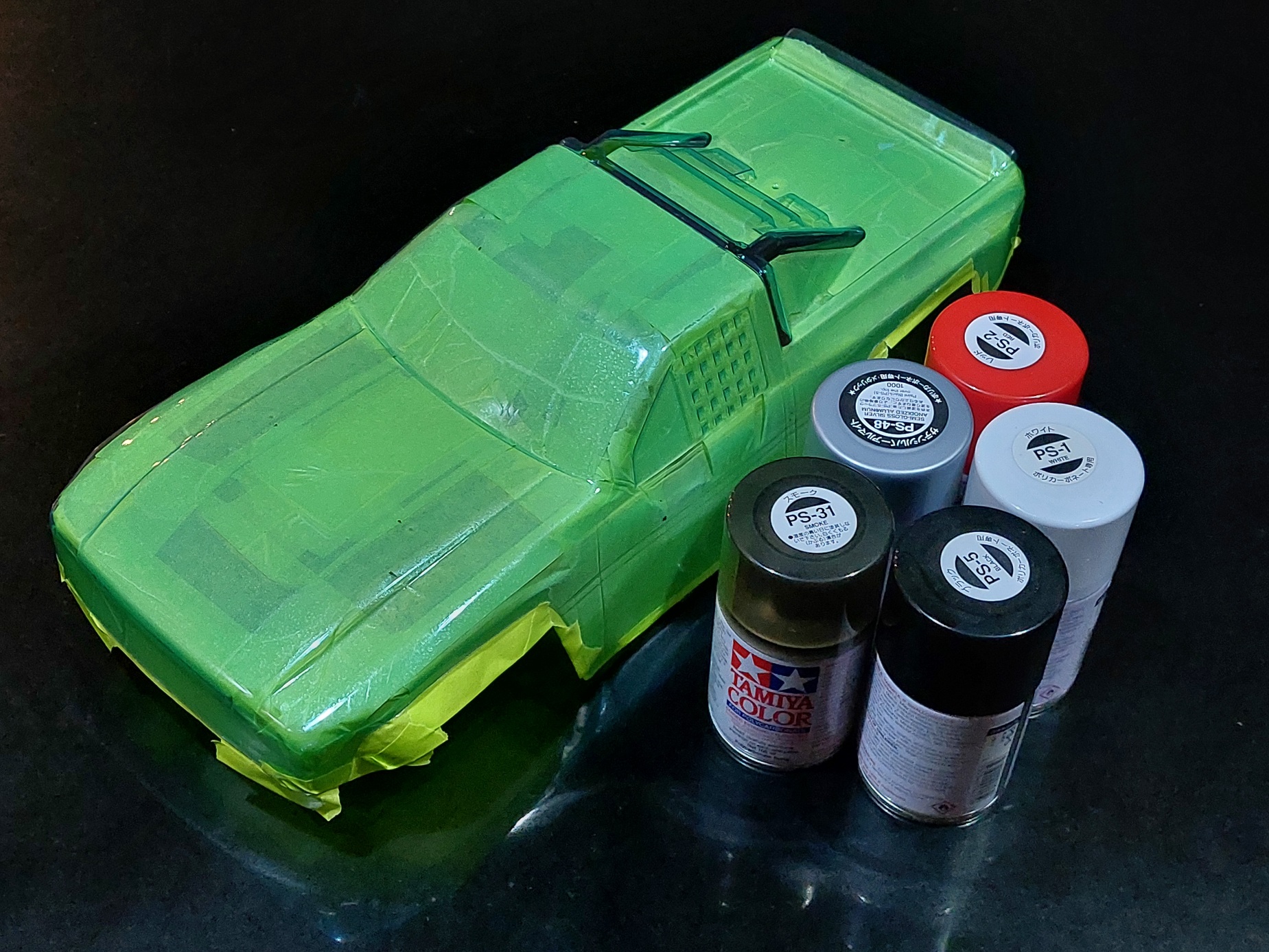

Amongst other progress and going back and forth between shortening a chassis or not I painted a body. I suck at painting but I used a tape that I like better than Tamiya masking tape. It's about as simple as you can get but still 5 colors. My camera makes it look pinkish but it's definitely red.

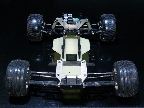

I finally dyed the battery box and made some new low profile shock towers to fit the SRT body, so far so good. The front tower is 10mm shorter and the rear tower 18mm shorter while still retaining the stock shock angles. I just need to make the rear trans brace before I get back onto the chassis which is roughly cut out and half drilled pending my final decision on length.

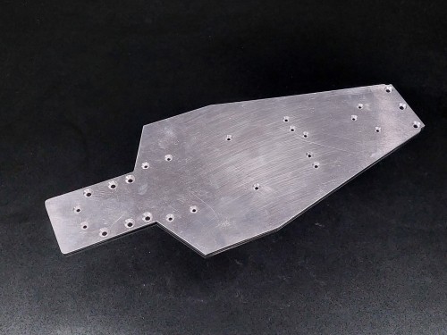

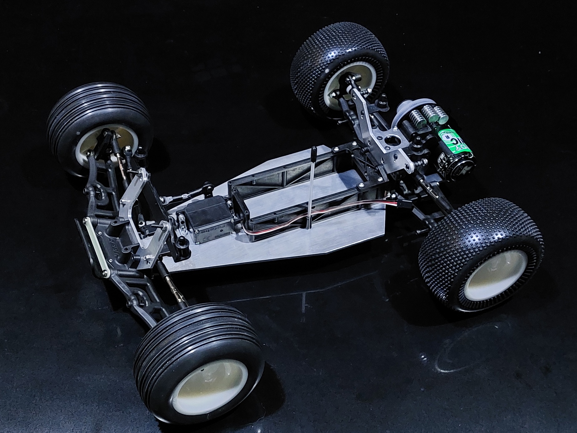

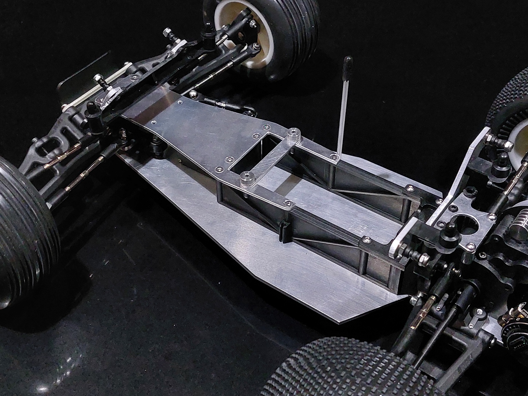

I finally had the motivation and time to finish shortening a chassis. I wanted to shorten it 20mm as I felt this looked the best but then a full size lipo wouldn't fit, so I compromized and it ended up 15mm shorter than stock. It's still in the mock-up stage so I still need to scribe the final shape, give it a final trim, and countersink the holes. I also need to make a top deck which is the last major part, I can see the light at the end of the tunnel :D
Chewbacca
Posts: 609
Joined: Sat Jun 24, 2006 6:41 am
Location: Herrenberg, Germany
Has thanked: 46 times
Been thanked: 104 times
Re: Kyosho SRT, or is it SRT Outrage?
Post by Chewbacca »
You could change your servo position and perhaps the steering setup to gain space for a full size battery.
- a low profile servo mounted sideways and standing without any change to the steering linkages
- a B3 / B4 style steering with a low profile servo mounted sideways, but laying down
Both options would free up enough space, so you could shorten the chassis by the desired 20mm.

Chewbacca wrote: Sat Jun 29, 2024 3:58 pm You could change your servo position and perhaps the steering setup to gain space for a full size battery.
I've thought about that, I think I have one set of NIX10M steering bellcranks left which would work perfect. 5mm over the length of the truck isn't much and you probably couldn't tell anyways at the end of the day. it still looks good. I'll post a pic with the body once I make the top plate, it is pretty low and wide.

Trimmed the chassis profile and countersunk the holes, for some reason the countersink I was using wasn't playing the game in the drill press so the countersinks aren't as nice as I would have liked. All in all it turned out pretty good at the end of the day.
I could finish the chassis face a bit nicer but it was a pretty beat up offcut to begin with. I would like to get some black holographic mirror vinyl for the bottom chassis protector so when it goes tumbling down the street it puts on an electric light show.
Next up is to tackle the steering rack.

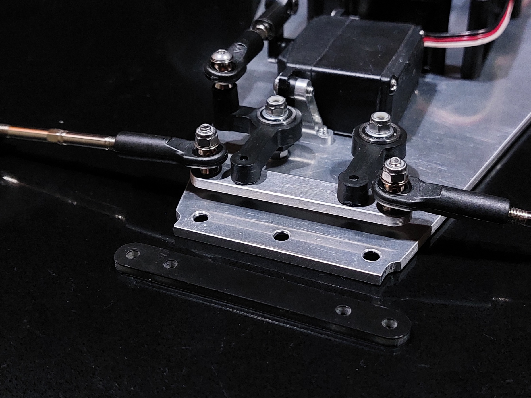

Dumb dumb me ordered the wrong steering rack :roll:
Oh well, what's one more home made part ?
At least the steering is all connected now and works well.

Top plate pretty much finished, I just need to make 2 - 3 large round holes in it then it's done done. I will also make a more elaborate battery strap eventually.

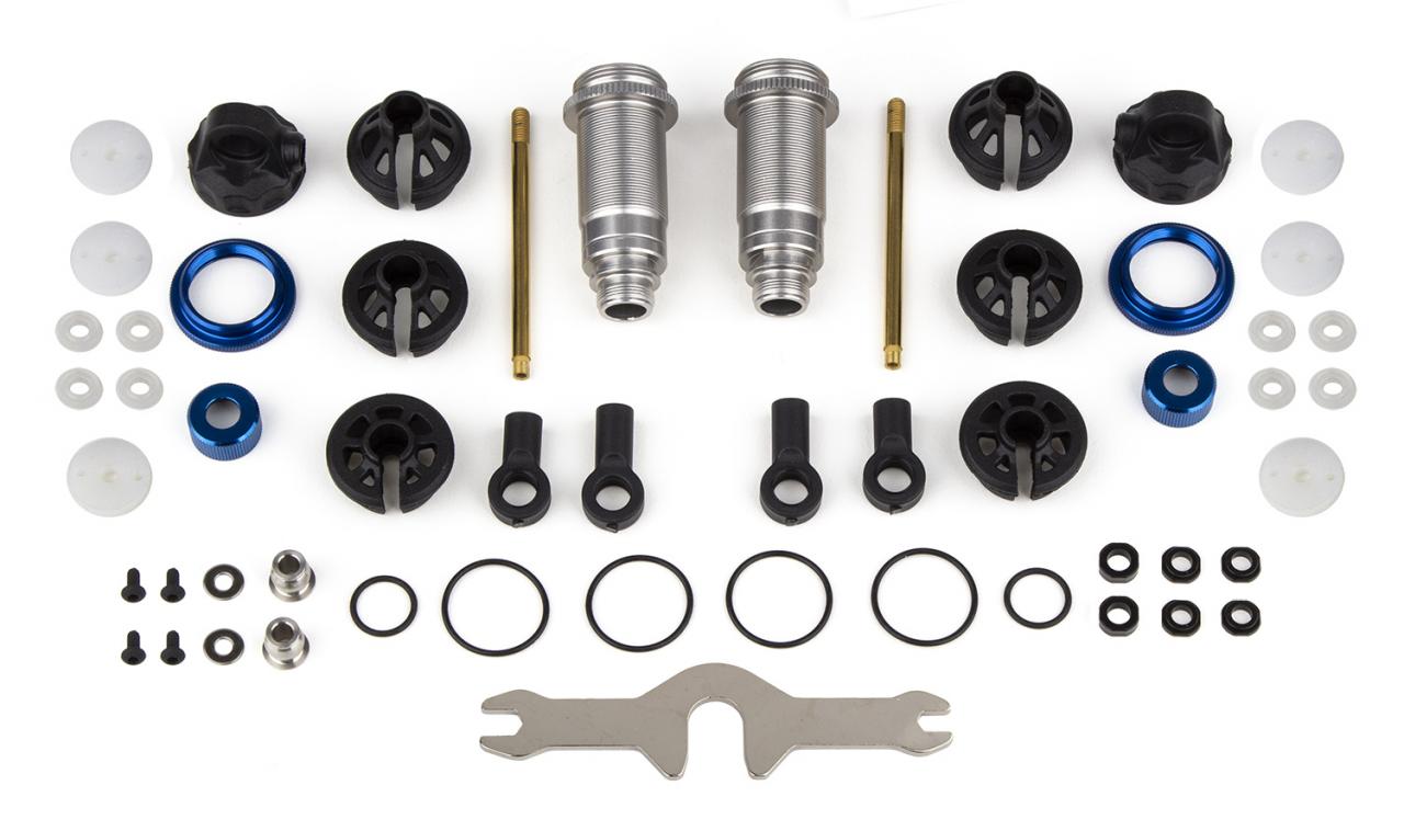

Shocks are the only major part I'm missing and .89 shocks are pretty hard to find, so I've been trying to find an alternative. Even though I'd like to find vintage style shocks I may have to use D/S/RB10 front shocks all around. Of course the blue will have to be stripped....
Expensive though :(
Posts: 3437
Has thanked: 264 times
Been thanked: 2020 times
RC10th wrote: Sat Jul 13, 2024 8:46 am Shocks are the only major part I'm missing and .89 shocks are pretty hard to find, so I've been trying to find an alternative.
Didn't AE make various kinds of 23mm shocks?
