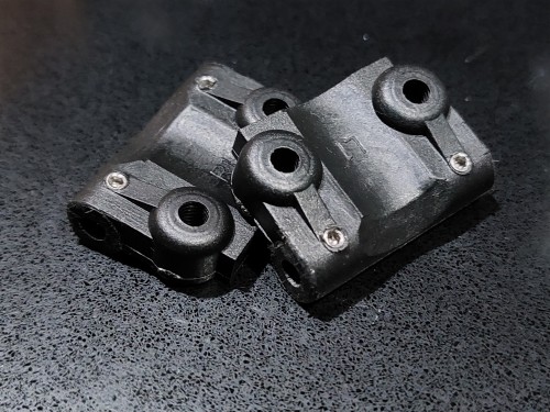

Here's a little mod that I did to overcome the sloppy hinge pin holes in the +/- 1 degree mounts to give myself some tuning options. Very simple but it works.

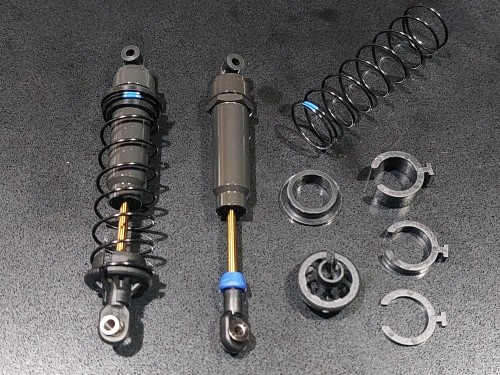

And many many more thanks again to Chris (1300GT) for making me some spring collars to adapt the AE springs to the Traxxas shocks. I originally tried to find Losi springs but they aren't the easiest to find anymore. Thanks Chris !
Shocks installed on the truck..... The Traxxas shocks are actually pretty good and super smooth. I think the T6 rear springs are quite a bit softer than conventional springs so I ended up using a harder spring then I was expecting, but overall it feels good. The truck feels SUPER plush and I'm hoping is a traction magnet. The chassis sits really nice and feels and looks just right.

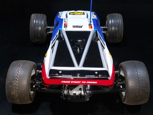

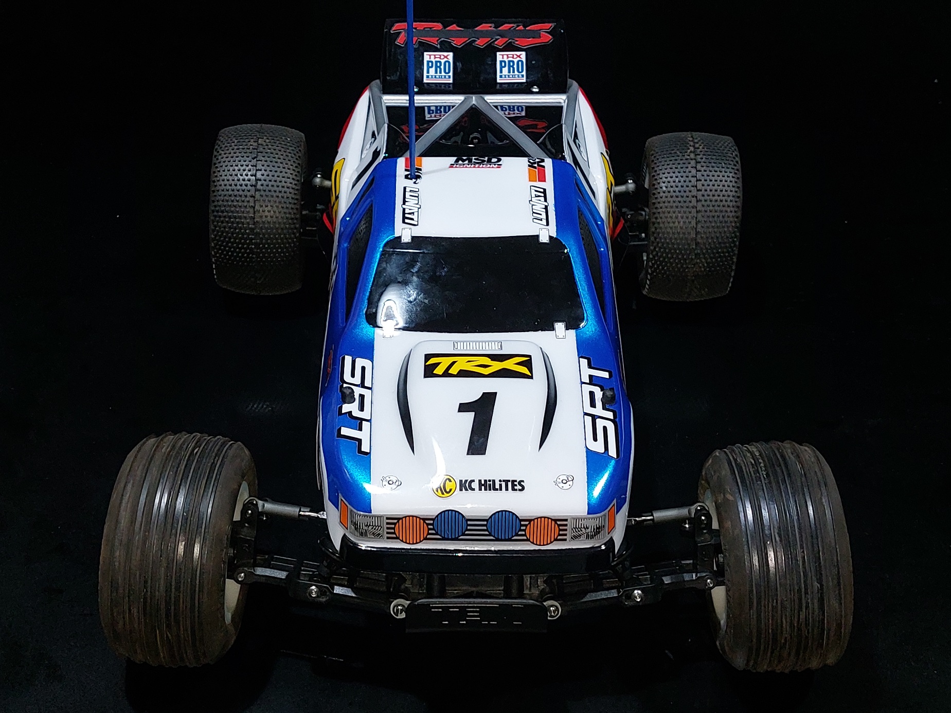

Truck is done !!
I still need to glue the tires and set camber etc but it's done. Overall I think it turned out pretty good, it's as close to box art as I can get it.
