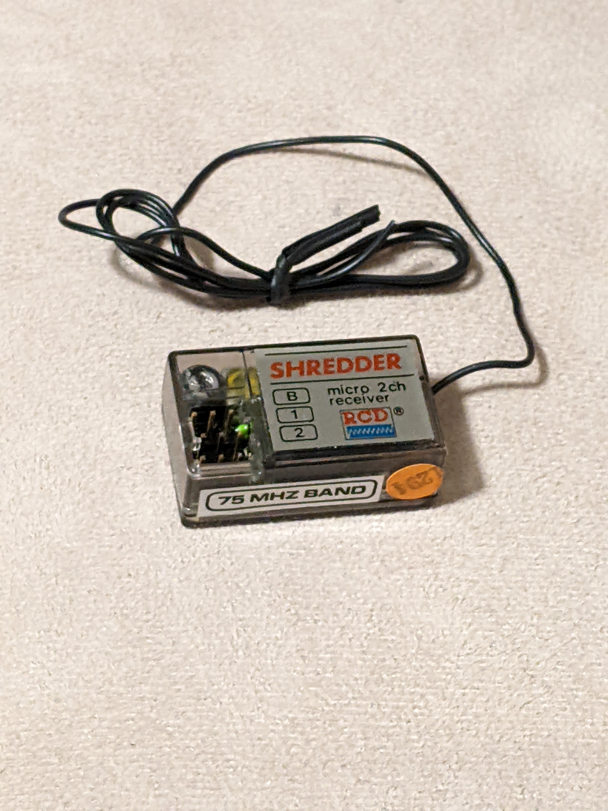

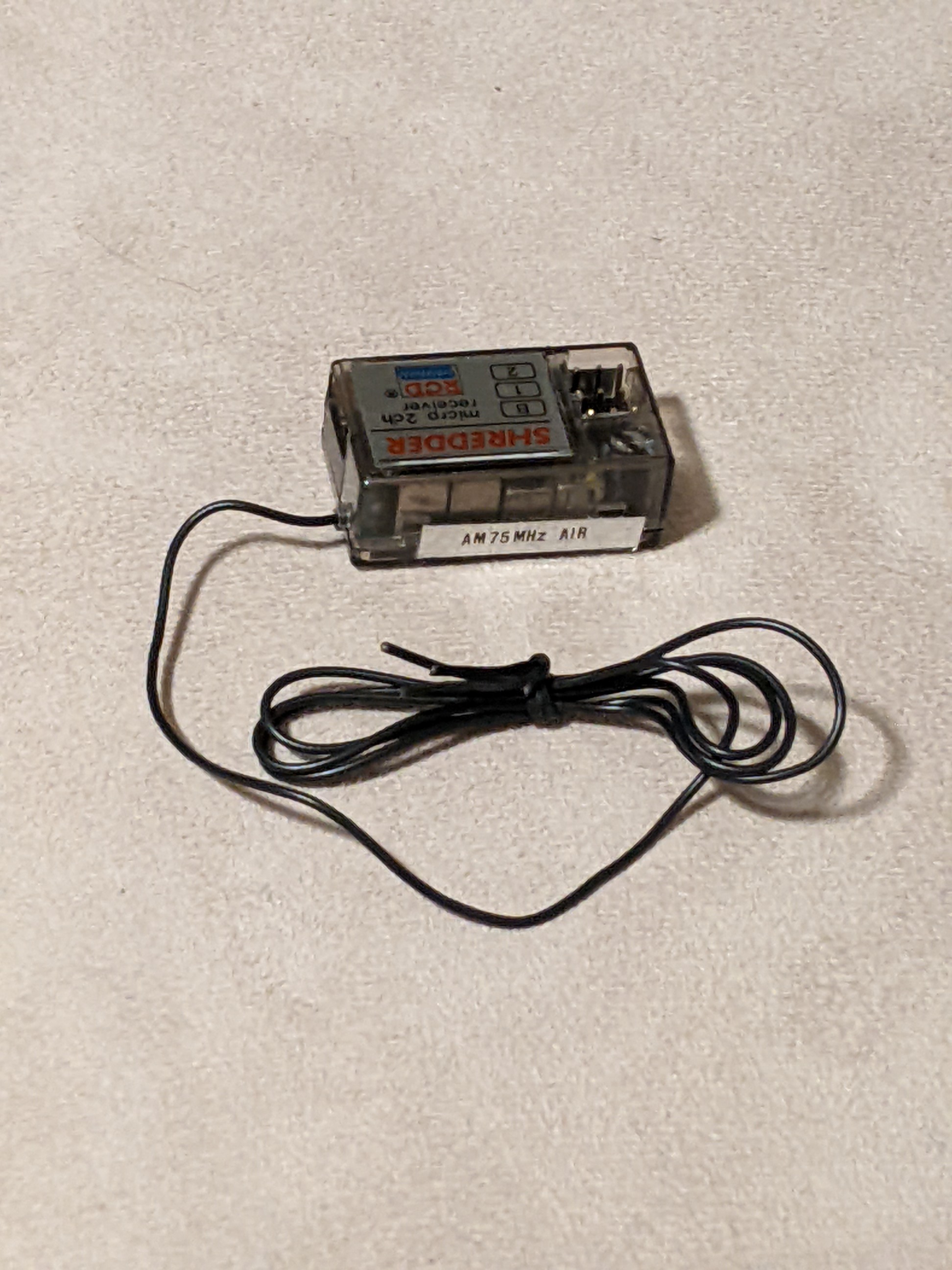

I recently picked up a nice little Hitec Shredder RCD 75mhz AM receiver, however it's marked AIR so I presume it's tuned for Airtronics. There's no real wiring markings on it and I have no 75mhz AM Airtronics radio. Is there any way to test this receiver with a Futaba radio? Any thoughts?

I looked into the wiring and have made some adapters. I also have a couple of old Airtronics servos, so I tried those. I don't think the receiver likes Futaba radios and/or crystals. When I hook up Airtronics servos and a 4 cell pack, the servos will give a 'power on' twitch but will not move under radio command. I've tried a couple of different sets of genuine Futaba crystals and also an aftermarket set. I guess next I'll have to see if I can find either a set of Airtronics crystals or an Airtronics radio.

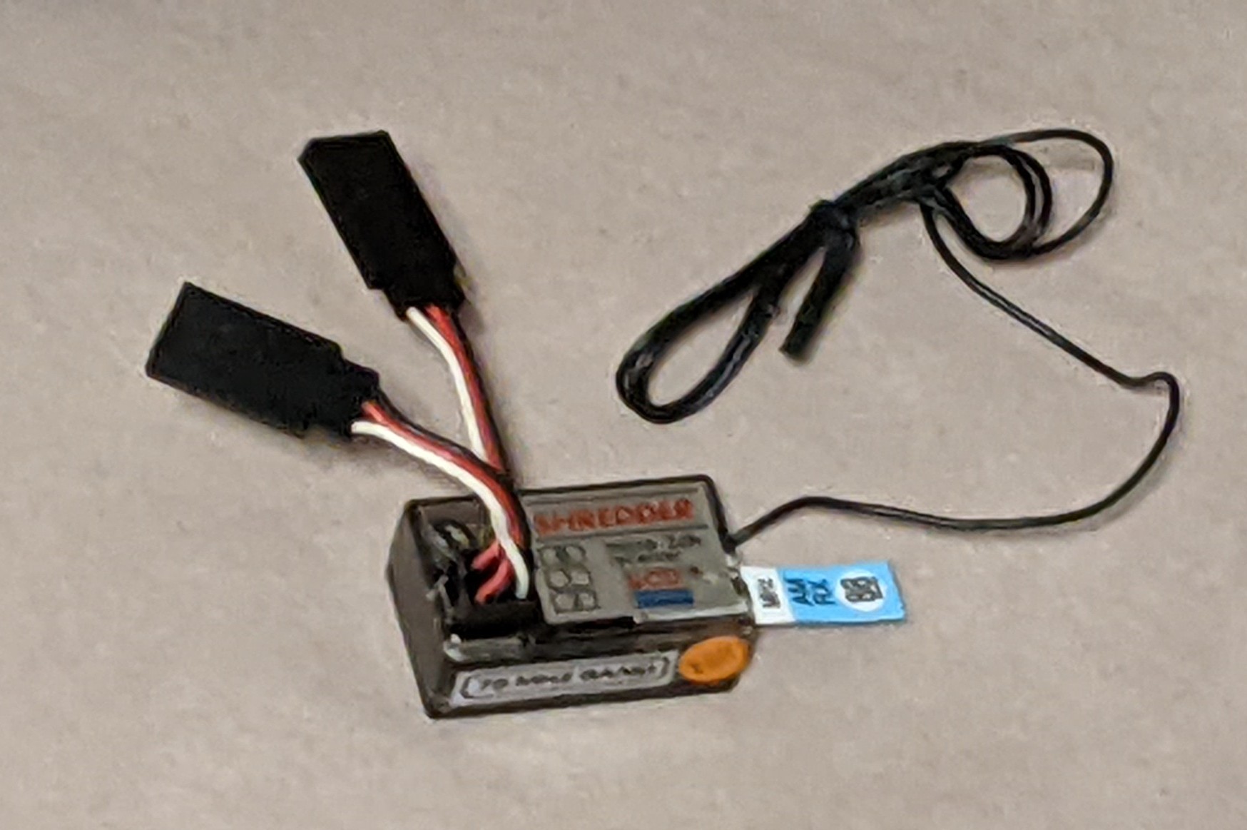

The old style Airtronics plugs are a good fit in this receiver. I have a pair of old Airtronics servos that I never thought I'd have a use for. Receiver testing is there new purpose.

Using an Airtronics rx crystal for the receiver is the magic solution. The little Shredder works just fine with my Futaba radio now. Awesome!

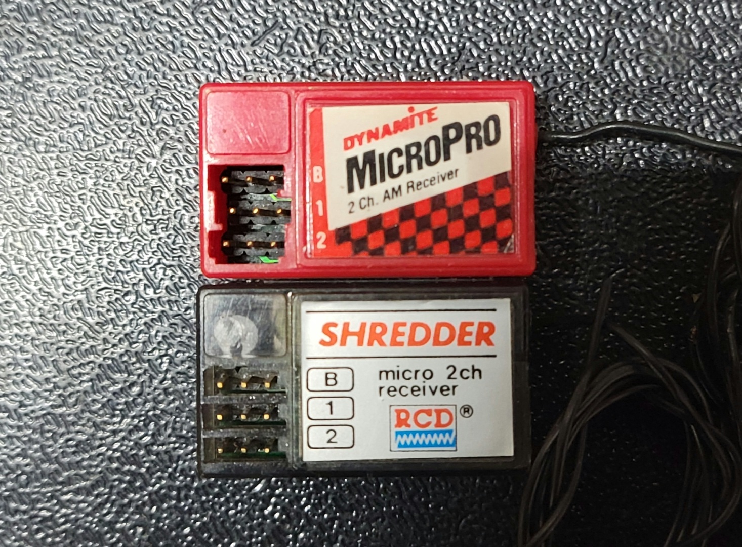

Here it is, with a Shredder. Other than color and the label, they look identical. I have another Micro Pro (Futaba) and a couple Shredders.

That Dynamite MicroPro has old style Airtronics servo sockets, so it should need a Airtronics crystal. But be mindful, old style Airtronics plugs had the positive and negetive wires in reverse order from Futaba plugs. The Shredder receiver has Futaba style servo sockets.

I have two, Futaba and Airtronics versions. The manual says to use crystals that match the transmitter.Mark Westerfield wrote: ↑Mon Oct 10, 2022 8:35 am That Dynamite MicroPro has old style Airtronics servo sockets, so it should need a Airtronics crystal.
I posted that picture for Ed, as he has the Shredder in Airtronics format. They are together to show the similarities.Mark Westerfield wrote: ↑Mon Oct 10, 2022 8:35 am But be mindful, old style Airtronics plugs had the positive and negetive wires in reverse order from Futaba plugs. The Shredder receiver has Futaba style servo sockets.

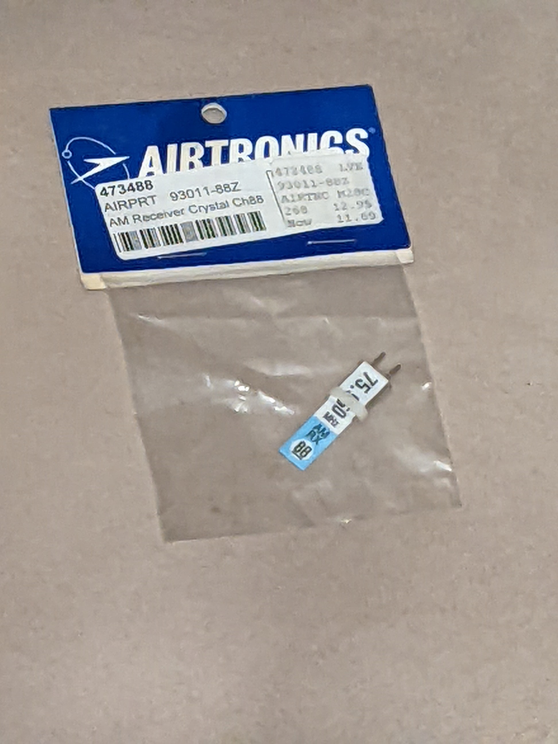

Just to follow up on this. I did finally get an Airtronics receiver crystal to try.
I used a Futaba transmitter and crystal.
-Novak Polaris for Airtronics (with Futaba J plugs!).
-Dynamite Micro Pro for Airtronics.
Both worked when using an Airtronics receiver crystal on the same frequency. Neither would do anything with Futaba or Hitec crystals.
Strangely enough, my actual Airtronics receiver will function with a Futaba crystal in it. Glitchy, but functional.
