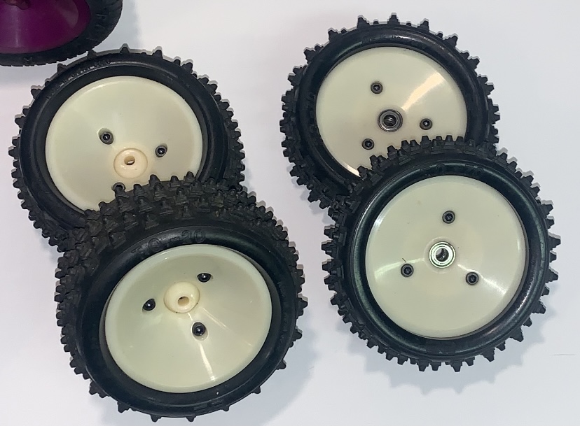

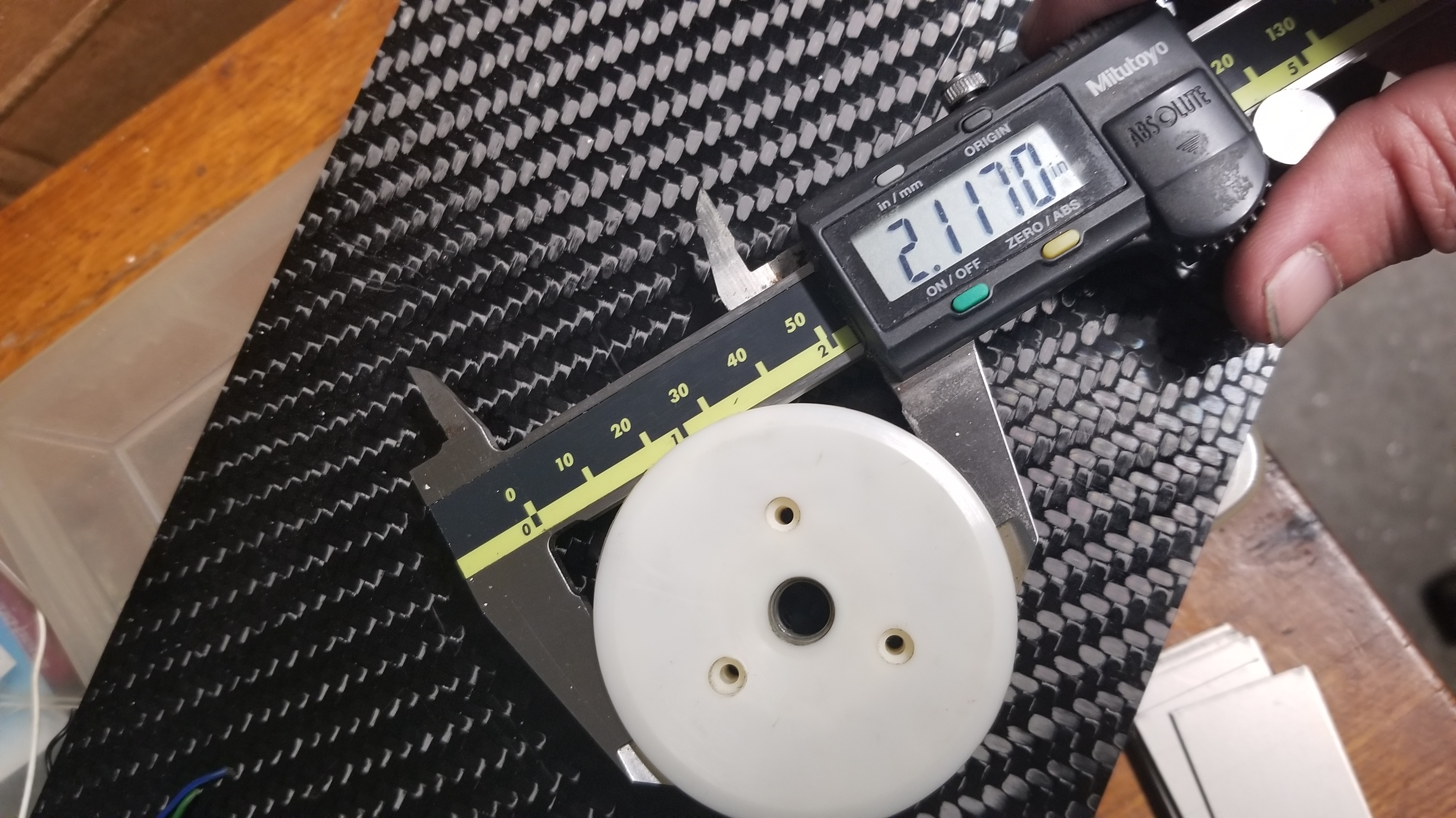

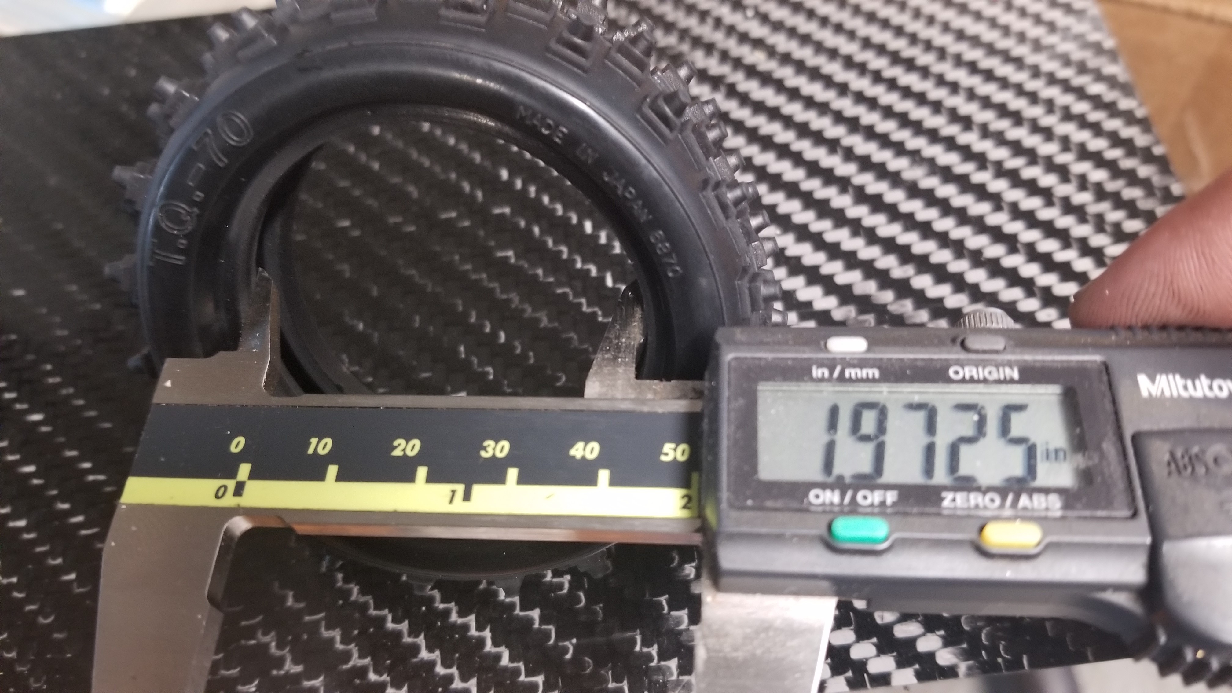

Maybe i'm doing it wrong, but a 2" wheel would seem to work best. The TQ20's fit nice on my rear rims, and both the rims and tires are measuring 2". The TQ 20's I have are the same diamater as the TQ70's. Attached are some pictures. It would be quite a stretch to get them on there. Doesn't seem right to me. Are those measurements lining up with what you've experienced?

I have TQ-72's on a a set of the CE wheels. You want them to fit snug. You have to lightly stretch the tire onto the wheel edge, then they fit nicely once everything is assembled.
Also keep in mind that the three piece CE wheels rely on compression and friction fit to hold the tires, not glue. They need to be a little tight.

I do believe that the tq70's are a 2.0 tire. AE used to have a 2.0 front wheel that looked like the 2.1 TQ wheel. Don't recall the part number.

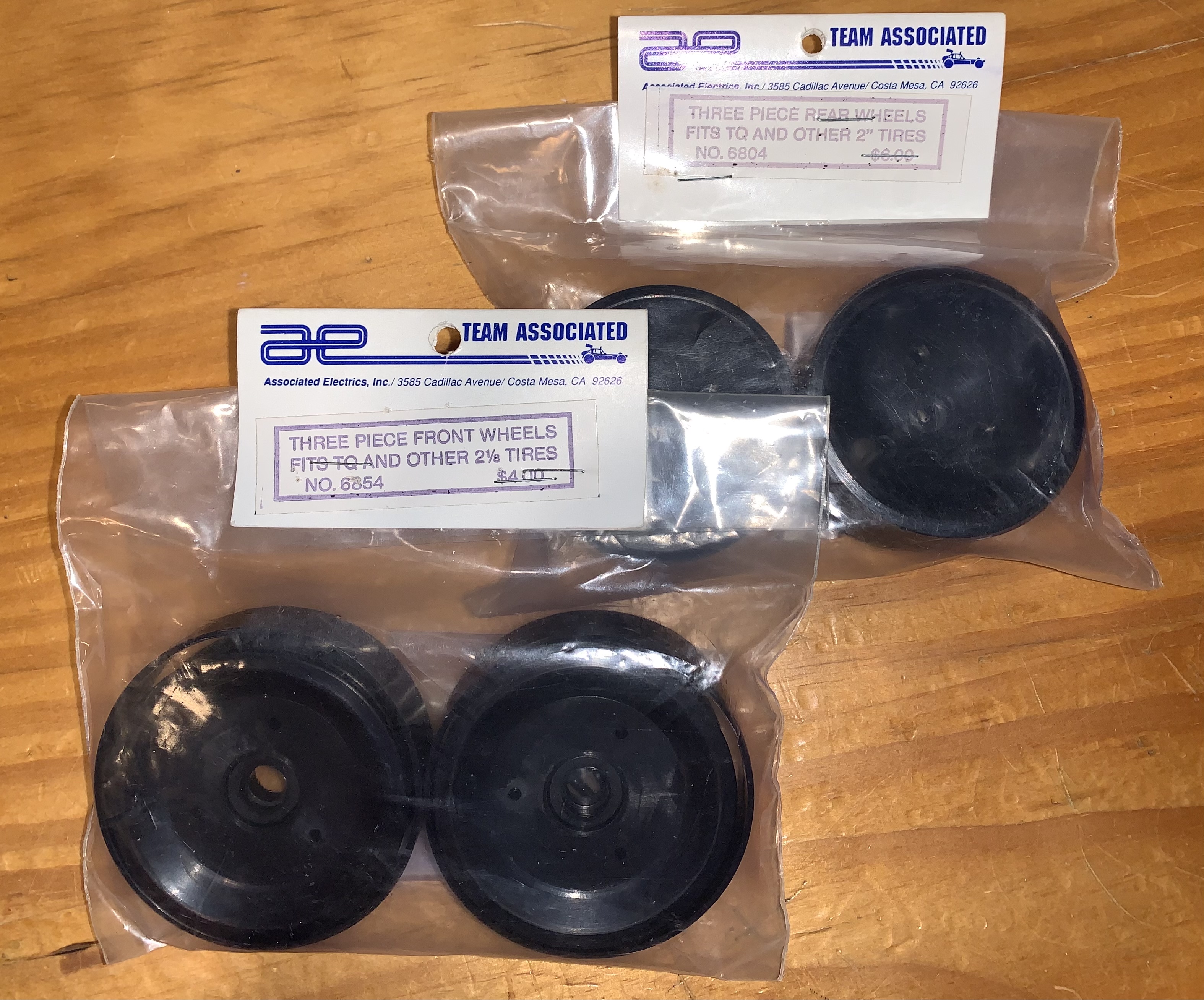

So your saying there we’re both sizes in one piece fronts and 3 piece ?

Yep these are 2-1/8 fronts.
Great now I’m going to be popping off all my unglued front tires to measure the wheels

Thanks for the feedback and information guys. The tires I have are a hard compound and they really don't want to go on these 2.1" rims. It might be possible, but i'm not going to push it.
Mark, I would be very interested to know what size your front tires are in the picture you posted. Nice wheels btw!
I sent an inquiry about these to AE. Not expecting to hear back, but will be sure to post any information if they provide it.
I've got a new idea, however. I might use a rear outside dish, and make a custom inside plate for it. The offset will be a little off, but it will certainly look aggressive and give me the 3 piece look to match the backs.
