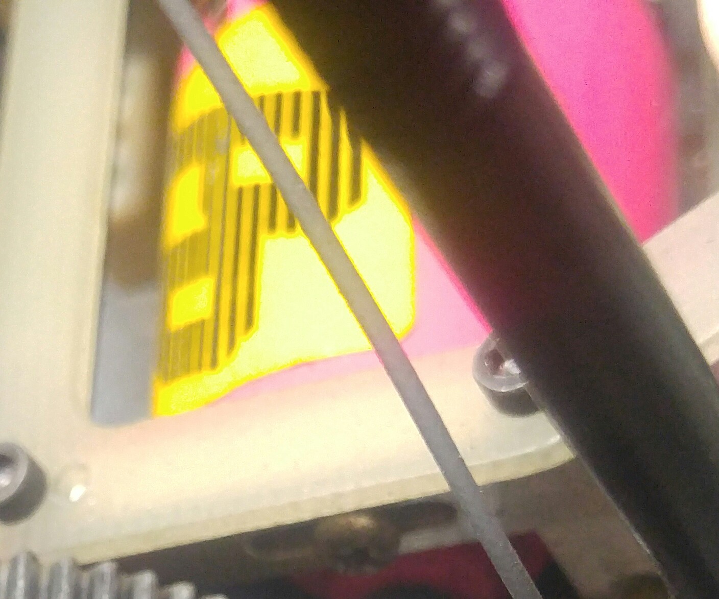

Overvolted wrote: Fri Apr 16, 2021 1:21 pm I started assembly yesterday on my pan car and need a little help. My left rear bulkhead is not the greatest and id like to reolace it however, I cant seem to find one. Are they not for sale any more and will one from another model work like Bolink perhaps? Also my motor did not have a spacer on it, do I need the spacer? The gear mesh looks great and nothing seems to be out of allignment.

Why is the left rear bulkhead on your car "not the greatest"? What is wrong with it?
You do not need the motor spacer.

It is ok however, it has a few small cracks starting to form and there is a stripped hole for one of the top plate screws that I have used a screw and nut to fasten. This car is going to be ran so id like it to be in good form. Thanks for the info on the spacer, it was not on there when I got the car and I was not sure if it was needed.
