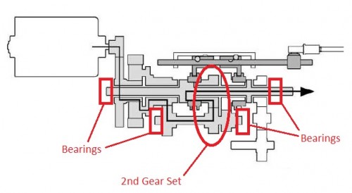

Are you chamfering the edges of the gears where they interlock for gear changes ?
jwscab
Posts: 6570
Location: Chalfont, PA
Been thanked: 498 times
Re: HG-P407 "Bruiser Clone" Arrived Today!
Post by jwscab »
Not always. If you have gears or any type of metal with hard sharp edges, you create a stress riser. Sanding down or softening edges can make parts stronger . In this case, the gears might be engaging poorly due to tooth shape. softening the edge might make a better engagement. That's just my guess however.
XLR8
Posts: 3296
Has thanked: 1640 times
Been thanked: 1156 times
Post by XLR8 »
You might be right Joe.
Polishing the gear to eliminate stress risers is one thing but I guess I've interpreted his comment to mean that he's going to "file" the tooth "point" (or crest) and doing that alone won't loosen the gear mesh (if that's the objective) and, if taken to the extreme, could cause the gear to fail.
Maybe he'll post another update soon and tell us what he's up to.

Flie down the point edges of gear help gear to be able to withstand the stresses which are put against it.
When it doesn’t withstand the stress, it failscan make Bending load parts work more free stronger
When the shafts and gear become misaligned, e.g. while deflecting under load, that general area will be
particularly stressed, and relatively likely to fail in fatigue, throwing a chip that will eventually find its way into the mesh and destroy the gears.
Better to remove it preemptively.
The next car or truck i do i will take picture of it
I been doing this for model train and all my rc for 40 year sometime i even shave gear case out for more room
XLR8
Posts: 3296
Post by XLR8 »
Thanks for the explanation, kennyrach.

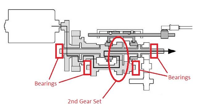

It appears that the 2nd gear set could be most prone to fail due to deflection. Both gear clusters runs on 5mm shafts and, referring to the schematic below, both shafts are supported by bearings only at each end. Notice that the 2nd gear resides very near the middle of the top shaft. To make matters worse, the shafts are drilled for 2mm cross-pins at multiple locations.
