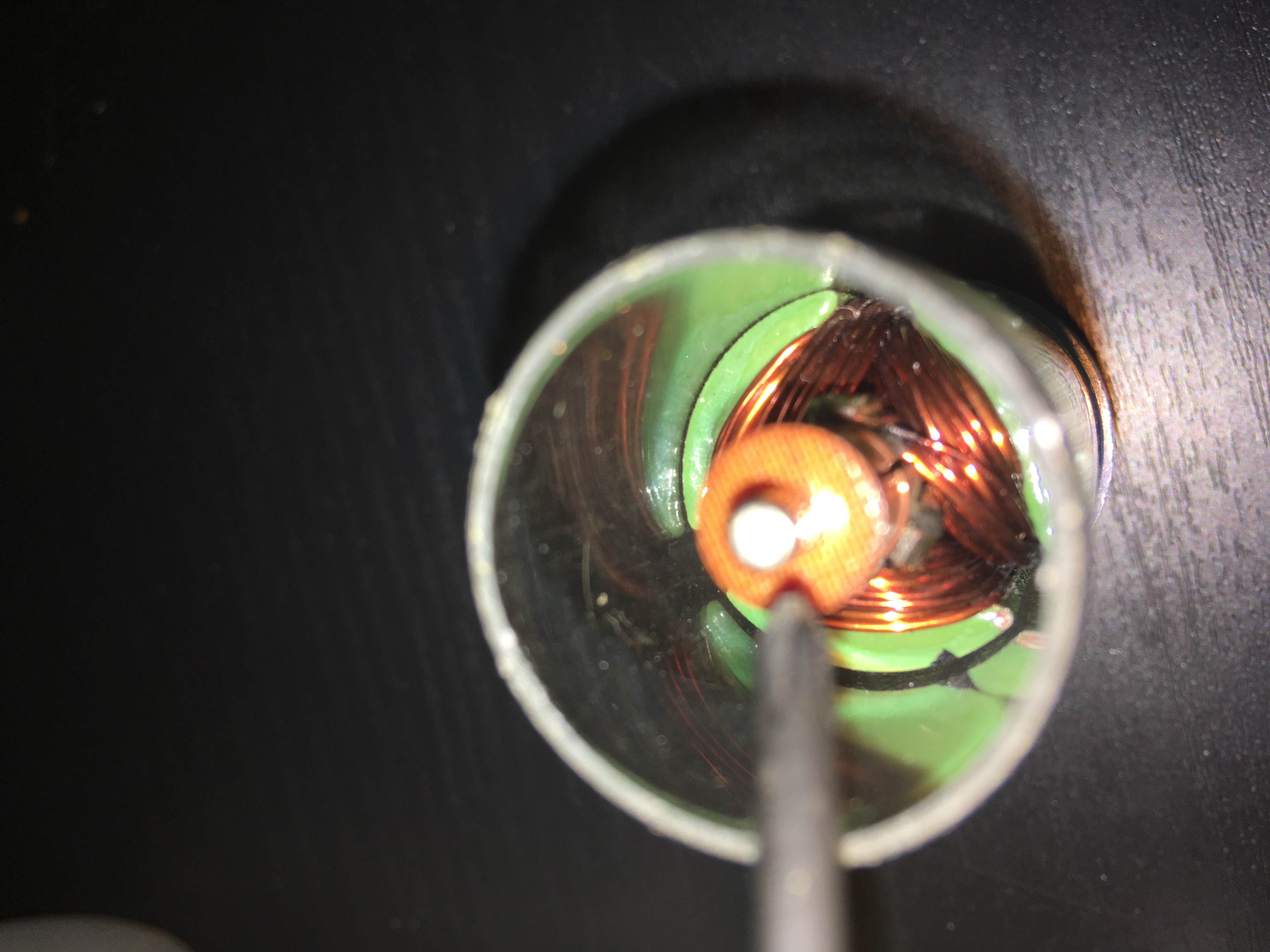

That feels good to have that down...thank you! Two more motor related question if you would pleeeease? The armatures have 3 green plates on the sides. each one is labeled (with a marker) 1,2 and 3. Why is this? The second question is how can I tell how many turns each motors is?

The marks on the three sides of the the armarure core are made when the armature is balanced, as a reference by the person doing it.
As far as knowing the wind of the motor. There is no non destructive way to find out.

exactly right on both counts. You can-sorta-maybe tell how many winds it is by the wire gauge and how many turns you can count that you see. thicker wire and you will be able to count more of the turns, and will be a much lower wind, like 11-14 turns. then 15-19 turns are smaller gauge and will fill the armatures more. 20 turns and above, you will see a pretty thin wire and the armature core will be completely full. again, just rule of thumb/guideline.
another complication is that some winds are multiple turns per wind, like double, or triple-up to 5 or even 6. in that case you have to look very carefully at the welded tab on the comm and see how many wires are welded in place, sometime very hard to see.
if you are lucky, the arm will sometimes have a marking telling you what the wind is.
