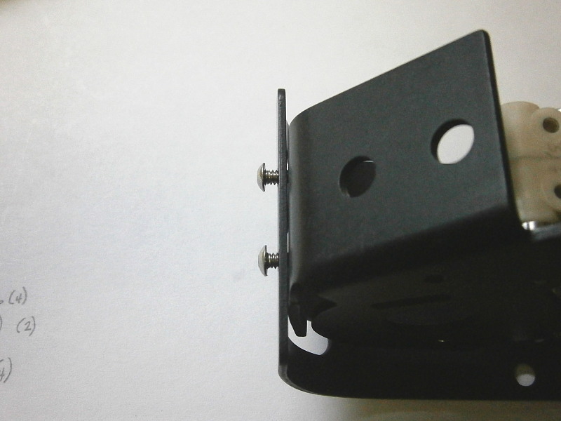

Hey guys, any advice on how to go about fixing this "tweak"? It's approx. a 4mm gap. :?
Bum on Direct Deposit
jwscab
Posts: 6570
Location: Chalfont, PA
Been thanked: 498 times
Re: NomadRacer's RC10 Trailing Arm Truck
Post by jwscab »
looks like the motor plate was modified,and it might have been held in a vise on the back flange, causing it to be flattened somewhat. Need to simply add some curve back in and bend back into position. the chassis looks fine, but you could also tweak it a little to bring the end forward.
NomadRacer
Posts: 1467
Has thanked: 81 times
Been thanked: 79 times
Post by NomadRacer »
Thanks for the tips. I'll get to bending on the motor plate first!
NomadRacer
Posts: 1467
I spent more than an hour, less than 12 :mrgreen: to get this far. I was not able to do anything with the curve at the bottom but there's no tension on any screws!
