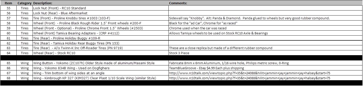

Here is the spreadsheet listing all of the mods/parts needed for this project. It's originally an Excel file, but I exported as a JPEG and broke into 3 seperate pages to get the file size small enough. Let me know of any errors or additions and I will update.
I hope other members find this helpful.
- Limestang

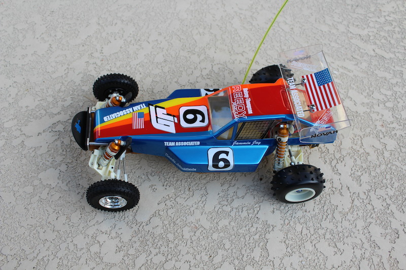

Well today was my birthday, so I got a little time to install the correct servo and front shock tower. Thanks to Kooz for selling me a hard to find S131 Servo. I found a graphite shock tower on Ebay for a reasonable amount, solving my Ritt Dye issue.
Posts: 16728
Has thanked: 33 times
Been thanked: 1179 times
Re: JJH Replica using Classic RC10
it looks like you have the front wheels assembled wrong. the center needs to be flipped around.

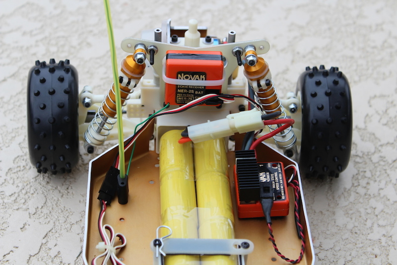

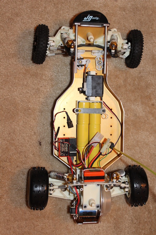

Rainy week, so took the opportunity to Incorporate new parts on the JJH Classic project:
1) Installed correct Novak Receiver (Not an easy part to find)
2) Replaced Classic Shocks with period correct versions
3) Replaced butchered G-Plug wiring on Novak ESC (Tested my eyes and soldering skills)
4) Corrected Battery Plug
5) upgraded front wheels (chrome)
6) Test operation with NIB Airtronics XL2P Radio System
Overall I'm pleased with how the re-re parts integrated with the vintage chassis and other components. The reproduction chassis is often a lighter gold, providing a more authentic look.
- Limestang

What exactly are the black front wheels on this car? I have always
been curious about the front wheels on Jay's car.
"They call me the Breeze,.....I keep rollin' down the road."
Early six gear CE, black & white Stealth CE, RC10 classic, SC10 kit version.
limestang
Posts: 986
Location: Fort Worth, TX
Has thanked: 91 times
Been thanked: 249 times
Post by limestang »
They are Proline 1.5" wheels that fit the Rough Rider (#200-F). You will also need Tamiya Wheel bearing adapters. If you click on the spread sheets, they will enlarge so you can better read them. The spread sheet contains all of the parts needed for the replica.
If you search eBay for Proline 1.5 wheel, they show up fairly regularly. Here's a set showing now:
http://www.ebay.com/itm/Vintage-RC-Pro-Line-1-5-FronT-BLACK-Wheels-n-Tires-TAMIYA-Sand-Scorcher-Etc-/301576316431?pt=LH_DefaultDomain_0&hash=item463759660f[url][/url]
Hope this help.
- Limestang

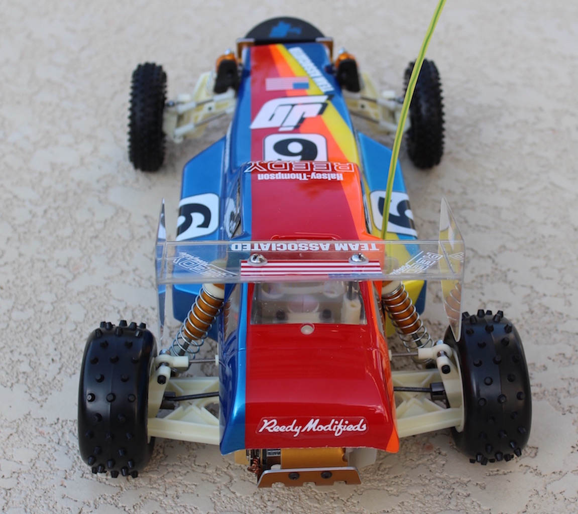

Here are some other photos. This was a fun project. Credit goes to all the members that built a JJH replica before me.
Mark
