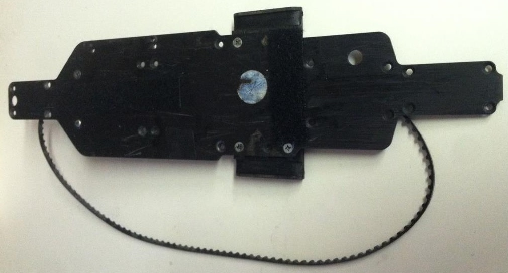

Looks like I found my chassis already. Made an offer on this for $26, the seller accepted. Should be easy to extend the front end as it's flat; the nose extension will include a kick-up. Not sure how that'll pan out yet; what front bulkhead & suspension I'll use, but I have a small collection of aluminum arms, front hubs & carriers...most of it for HSP cars, but I should be able to make something work. The LWB belt is a bonus, though I won't have a use for it.

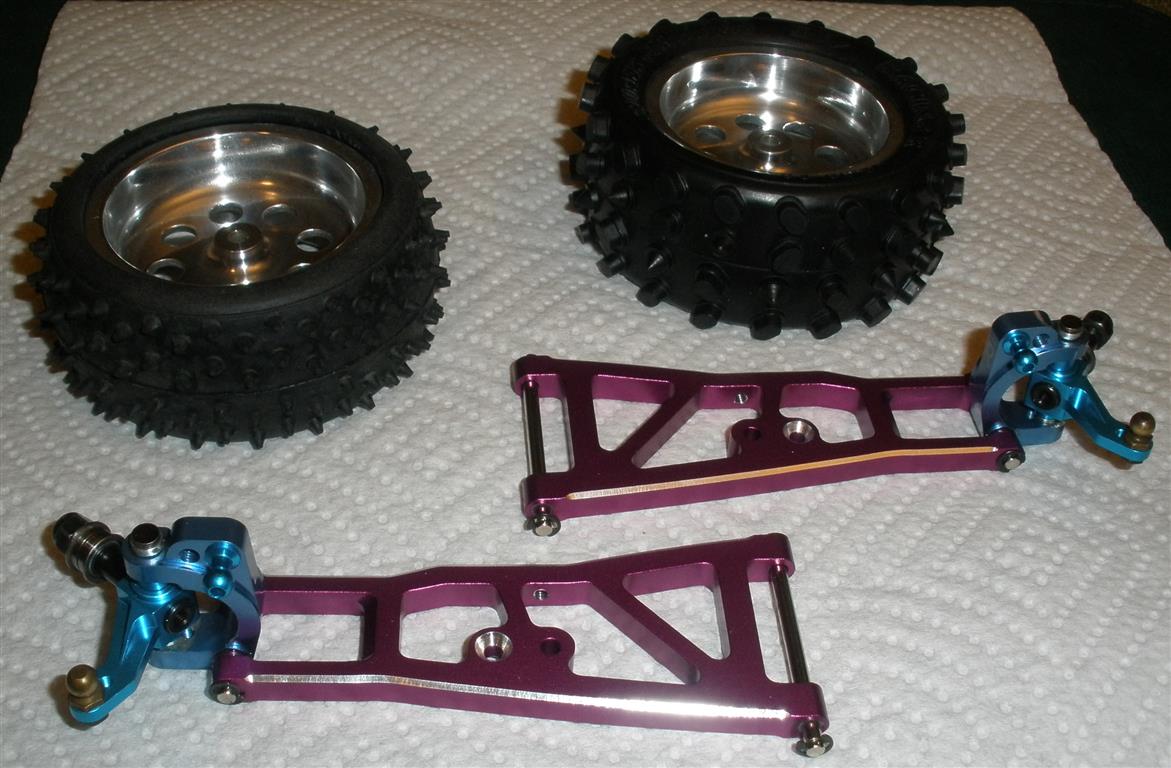

Early front end mockup
Post by Coelacanth »
Here's what I put together so far for the front end, using random leftovers that didn't make it onto my previous builds. I want this beast to have a wider-than-normal front track because the overall wheelbase will be quite a bit longer than a typical 1:10 buggy, and for the steering to be effective. The arms are HPI Nitro MT2 arms, the C-carriers are Kyosho Ultima SC/RB5 units from ST Racing, and the steering blocks are some upgrade parts for a Tamiya...can't remember much more than that. The steering parts were initially planned for the OptiMutt car, but I found something that worked better for that, so these were just lying around.
I'll drill out the Duratrax rear wheels to accept the flanged bearings on the axles. Those wheels are kind of an odd width; too narrow for typical rear tires, but should be perfect as front wheels & tires for a bigger-than-1:10-scale chassis. I'll probably go with the Tamiya Hotshot-style tires because they're bigger diameter and look more "meaty" on the wheels.
