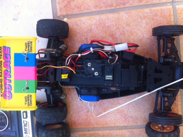

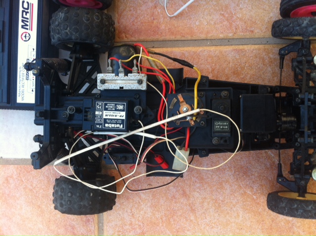

Hi guys, I think I did something stupid today. I bought a vintage kyosho raider and it was missing parts so in order to check if its servos worked i plugged then into the receiver for my vintage outrage, now the receiver nor the servos in my outrage arent responding to my controller and when u plug the battery pack the engine just runs and nothing is responding. Could someone please help me sort out this problem, and please dont tell me i screwed up my reciver because these cars are both vintage.

Can you tell me what type of radio equipment you have? If you could post pictures it will really help.

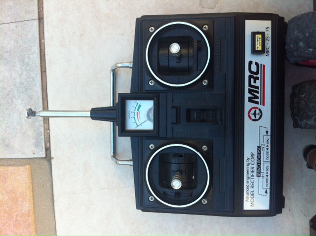

My receiver in my outrage is Futuba FP-R122Je & the receiver in my Raider is a FP-R102 JE. The controller is a MRC. Im sorry but Im new, so I dont know quite how to post pictures yes. Thanks for your help.

well the good news is both rx are easy to replace if needed but a few dumb questions.
1. did the servos in the raider work when you tried them with your outrage rx?
2. are both rx 75mgh? (can't quite read the all black one)
3. did you turn the radio on?
I know they are dumb questions but gotta be asked. Check your prongs on the rx to make sure that nothing got bent over or misplugged when you did the switcharoo. #3 sounds really dumb but a seasoned vet who still runs some oldschool stick radios had a brainfart last month at one of the Not so LHS and had primarily the same thing happen. They were messing with it for a couple minutes when one of the guys asked about turning it on. It was on but the batterys were low so it didn't have the juice to send a signal more than a couple feet away...he turned about 5 shades of red but fixed it by new batterys in his tx

Rc4lyfe, it does not look so bad. All of your in car stuff looks to be Futaba so it is all compatible. If I was to test this equipment I would use a receiver battery. Make sure that all of the batteries have a good charge in them. The only thing that concerns me is the transmitter. I am unsure it that MRC transmitter is a re-badged Futaba or some other brand. To be sure if you can borrow an old Futaba AM transmitter on 75 it would eliminate a lot of the guess work.

Thanks for the assistance urban, if im reading your response correctly, youre telling me its my controller and not my receivers. I checked and both are Am futuba receivers. What I would like to know is how do I regain control of my vehicle, right now nothings responding so Im hoping I didnt burn out my receiver. The prongs are all straight and everything looks good.

Rc4lyfe, smell your receivers, if you burned them they will smell for sure. Most AM equipment is compatible. I do know of exceptions for example Airtronics/Sanwa does not work well with other brands. Did any of your stuff work before the swap? My concern is that that MRC transmitter is an odd brand radio and will not work with the futaba receivers that you have. I know that MRC did not make any of there own stuff you just have to figure out who made it for them. The best way to trouble shoot this is to use known good equipment. If you live in the GTA PM me and I can help you out.
