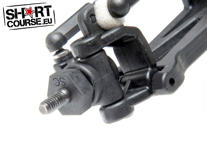

Has anyone tried the SC10RS front carriers....now with 12mm hex :)

Those look cool Joey. Looks like they'd add about as much width to a car as the RB5 setup, and probably be cheaper for us in the US. What size bearings? 3/16x3/8? The blitz front blocks/spindles/axles will work too - I think. And the blitz ones won't bump the width out so much. Blitz ones can even be had in white!!

the associated parts numbers for that setup are as follows:
steering block: 9880
axle: 9881
c clip: 9882
hex: 9883
uses 7922 c-hub, same as gt2, b4.1,t4.1
rough price is about 20 bucks without bearings. They are 3/16"x3/8" unflanged.

Can someone confirm that these are the correct wheels adapters used for the fronts:

RC104ever wrote:Can someone confirm that these are the correct wheels adapters used for the fronts:
http://www3.towerhobbies.com/cgi-bin/wti0001p?&I=LXJK29&P=7
That's the one I used. :D

Can the steering blocks fit in any other caster blocks, like for the T3? I'm trying to use 12mm hex wheels on the front of a car but want to keep it from getting too wide. Traxxas Rustler front parts fit, but I have to grind both the arm and the caster block to get full travel.
