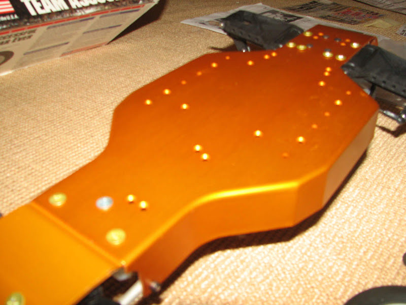

As a kid back in the mid 80's I got into off-road and dirt oval 1/10 racing. I was wooed by the flashy ads for the original Ultima and the Optima/Turbo Optima. The RC10s where my competitors. I think in retrospect, I made the wrong choice and always sort of regretted it. So now, 20+ years later with my vintage racers and parts in boxes, I found my opportunity to pick up a NIB partially assembled RC10 for cheap. Now it's not the original kit, but I couldn't pass up the deal. It is the '92 Champion Edition #6011 with gold tub with the included stealth. It is about 80-90% assembled and is missing the body, most of the manual and probably some screws, etc. Pictures to follow.

Not the greatest macro shot. I need to try again with the "good" camera. But as you can see, it's clean and never run.

Another question I had was if it a good/bad idea to use a quality fine automotive polish on the anodized pan?

i wouldn't try and mess with the anodized finish. soap and water and maybe a stiff brush to get gunk off. you can use acetone or wd40 to remove sticker/tape residue, but nothing abrasive.......
