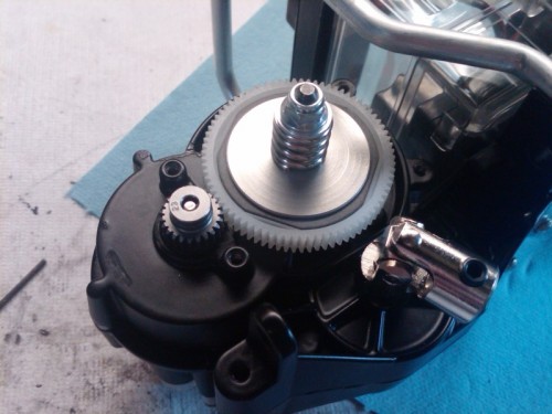

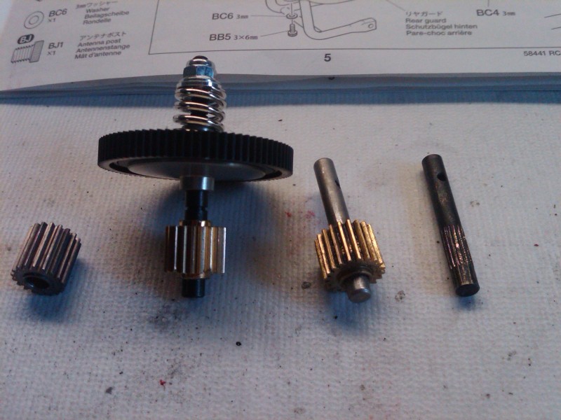

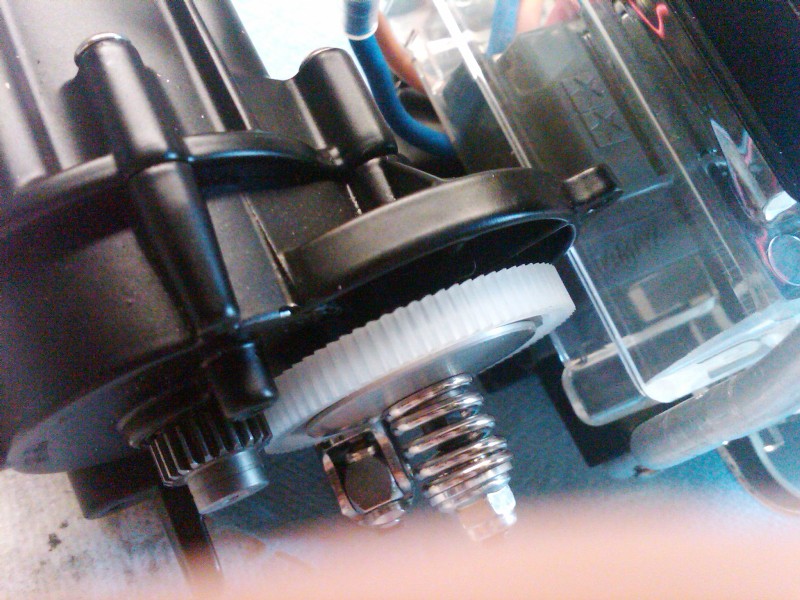

heres a picture, i popped off the brass gear from the original rough rider arm, and popped off the steel gear off the original arm, and swapped them.. will post some pictures of it mounted up soon, waiting for some plating to be done on the gear cases

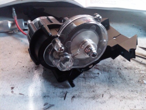

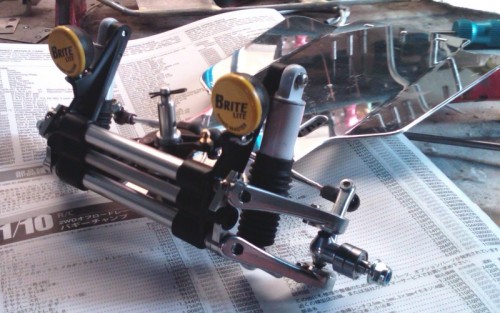

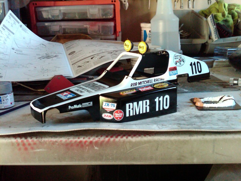

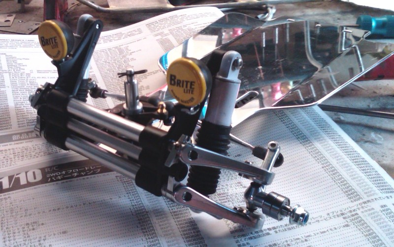

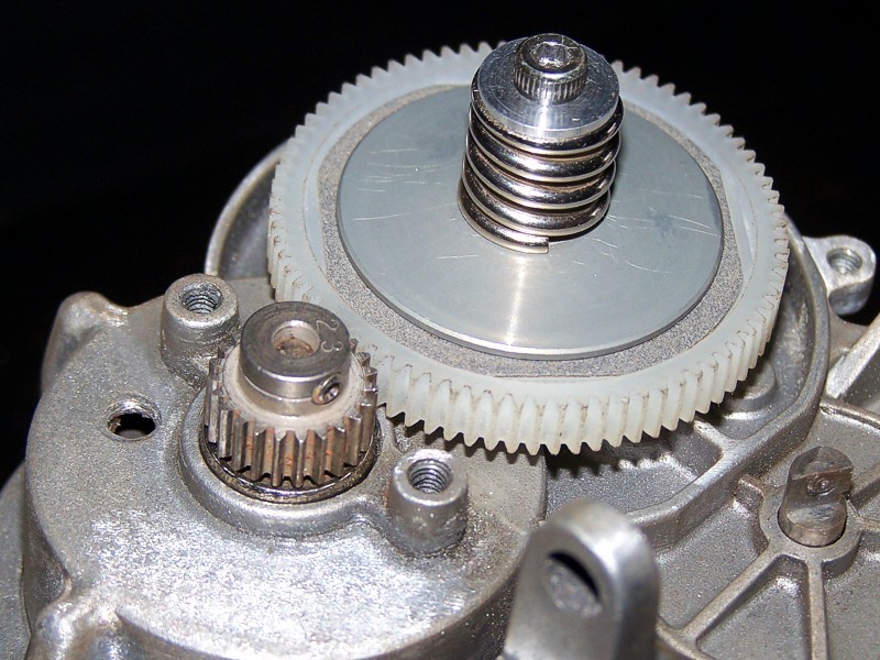

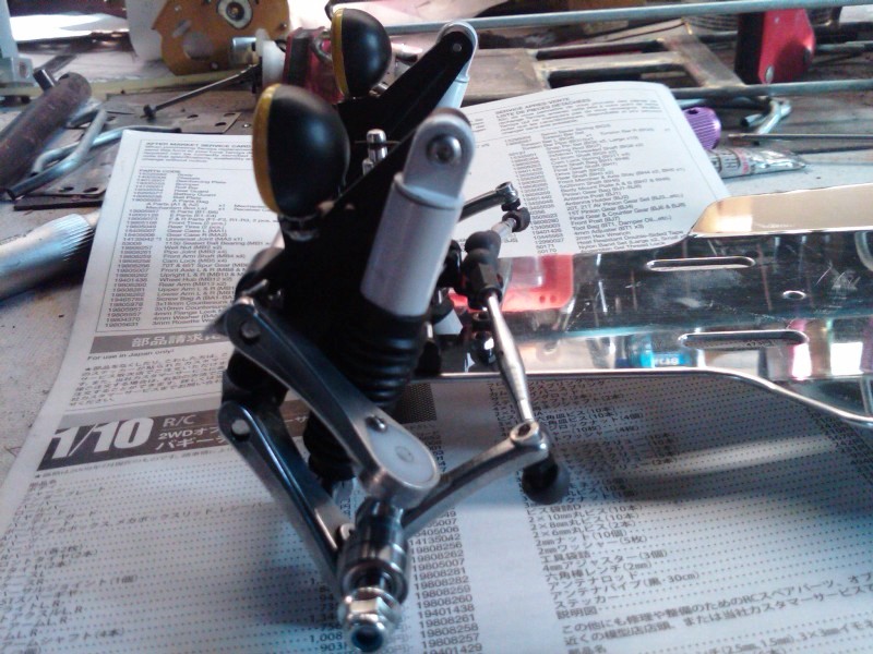

got my rear gear cases and front mounts back from powdercoater, got it in a flat black. added some rc4wd white shocks, fit great in front, need to cut body and weld a aluminum post in the rear to make them work, think it will look great. Added a polished chassis from the UK also. and painted up the body.. i am waiting on Tires from CRP (getting paddles/smoothies ala scorcher style) since i want to run it on the beach.. Also ordered from chrome plated wheels from the czech republic (figured would be lighter than aluminum)
Pictured is the Slipper modification, i am awaiting on a 19t 05mod pinion, and need to make a end cap for the slipper, but fits and works great. added a CRP brass idler gear (vintage) in there also.
Only thing im waiting on is RCChannel to make more of the buggy champ rears with zero camber, really want to get one of those running here.
i kept saying to myself, well i spent so much on this kit already, let me keep the mods to a minimum, and of course like a idiot i went all out on them.. bah!

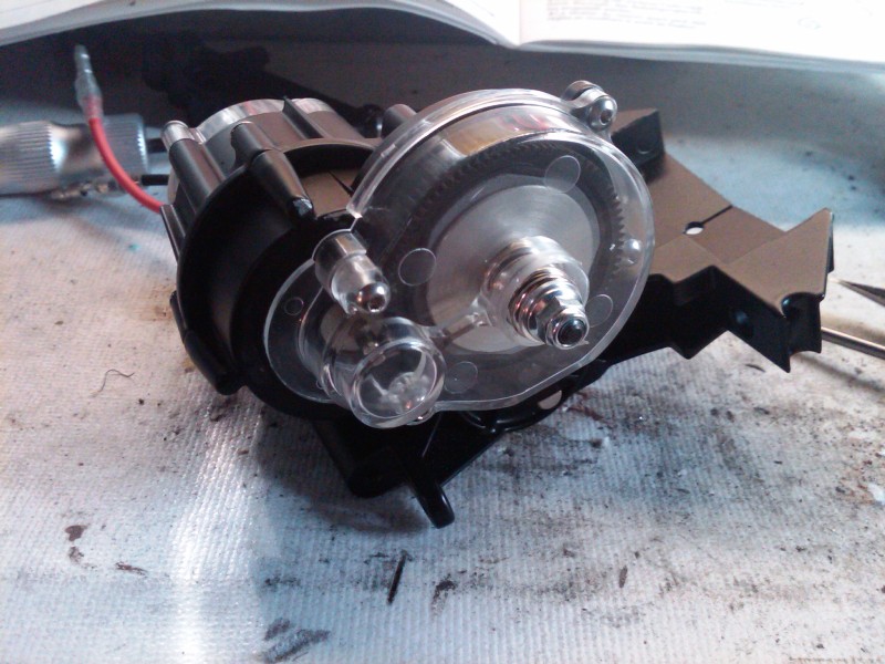

Re: Buggy Champ Build...

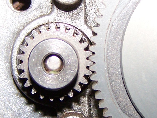

took some more shots with a 23T/78T - 6.78:1 FDR combo installed.. probably would work better over a 19T/82T - 8.63:1 FDR
just need to find a clear cap now, this is the original from the DF03 here
http://cgi.ebay.com/New-Tamiya-DF03-DF03ra-rally-M-parts-avante-mk-2-/290317676789?cmd=ViewItem&pt=Radio_Control_Parts_Accessories&hash=item43984830f5
But would like to find one in clear, dont know where to look
