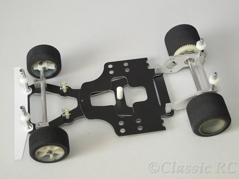

Posts: 792
Location: Europe
Has thanked: 18 times
Been thanked: 15 times
Re: Delta Phaser project
Post by Jirka »
Really impressive spur gear cleaning, that spur looks as good as new! That cleaning machine that You have will cost itself back really soon in this hobby. Also other parts looks like new from pics.
What is the idea of those two chassis plates so close but not in contact of each other? To get right kind of chassis suspension? Should saddle pack or stick pack batteries be used in this car? Also what is the meaning of that white pin in the middle of the chassis?
Really nice project.
Jirka

Yes using the ultrasonic cleaner did work very good, much better than expected. For some cars with worse condition I will try the machine again.
As there was no real suspension chassisflex was used. With the radio plate just connected at the pod to the chassis result in
more chassisflex and no binding. Saddlepack batteries were used.
The white pin is a mount for antenne. I used this at the chassis as it was provided with the kit but I don´t use any antenne at the vintage cars.
Thanks Jirka.

Post by V12 »
Phaser project completed. Wrong parts replaced, also correct RC12E wheels used now.
I know Delta 1/12 wheels look very nice but they are far from being period correct. The first Phaser was sold as a conversion kit for the RC12E and the Delta team also used those wheels. Delta released their own wheels around 4 years later.
