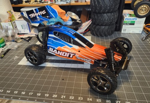

So, inspired by MXACRES on YouTube I’m building a Bandit from the ground up because I figure if I bought the buggy whole, I’d wind up replacing everything eventually, so why not just build it from the ground up with good parts to begin with(?).
Starting with the front end parts on order so far:
  • Chassis with battery strap and esc platform, eBay (thought it was the black one, but turned out to be grey. Oh well)
  • R-Designs CF shock tower (holes for dayz)
  • Black top chassis plate
  • stock bumper
  • aluminum bulkhead (blue)
  • RPM arms
  • aluminum caster block (blue)
  • RPM steering block
  • HR steering bellcrank (black)
  • turnbuckles
Going with a plastic-aluminum-plastic-aluminum theme for the suspension bits to keep it somewhat rugged but not too rigid that there’s no flex. Hoping that works pretty well.
I’ve got an Associated B6.3 body laying around I’ve heard it’ll fit with some trimming. Also have some Associated factory team shocks I could use. I plan on picking up a Savox 1258 on the used market, and stock ESCs are cheap enough whether I go with Hobbywing or a Reedy RTR unit. Clamp on hexes for the rear, and I know for sure that Associated 71127 front hex axles work with the TRX steering blocks. Got plenty of hex wheels with slicks. Plenty of 12mm springs and oils to experiment with. Also, have a Reedy Sonic 17.5 motor to go with it.
Pretty stoked to get this project going.

Took the B6 body to the LHS to test fit on a Bandit, and it did not fit. I don't know how MXAcres was able to get one to fit on his. Looks like I'm getting a new body for it then, which is fine. Make rear cab great again. I was around when the transition to forward cab became all the rage with the Proline Bulldog, and now I'm sick of seeing them. It's kind of endearing to see a rear cab on the track, especially one with a big TRAXXAS sticker on the side.
Instead of making the Traxxas axles to maintain hexes without falling off, I went ahead and bought another set of 71127 axles. This combo is tried and true:
RPM steering + 71127 hex axles
Most of my front end parts don't come in til the end of the week. I wager that this car won't be finished for another month or so. My wife is eventually going to notice that pile of parts one day turned into another toy car.

Front end is done-ish. UPS lost the bumper so ordered a replacement. Looking like the aluminum bulkhead might be lost as well. If it doesn’t turn up by tomorrow I’ll order another.
Unfortunately, the RPM outer hinges are a bit beefy and binds with the steering block a tad bit, so a quick Dremel job solved that. Also, had to bore out the caster block hinge with a 1/8 bit to fit the pin.
