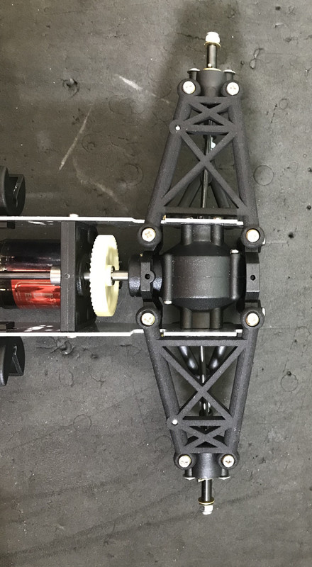

Fast forward 30+ years..I bought some incomplete kits, a used car and various parts to finally build one..or two. I quickly ran into the problem of brand new suspension arms cracking around the pivot balls and that’s where this has sat for the past two years. Thankfully Dadio Designs made some 3D printed ones and now it’s on again!
Here is where it currently sits, stalled for 2 years..
Notice the cracked arm.. also note that I used an extra front differential case in the rear so that the pinion/spur shaft is supported by 3 bearings instead of 2, which makes a big difference in setting up and smoothness of the rear diff.
Some serious Dymond horsepower!

Interesting idea using a front diff housing on the rear.
Dadio certainly is a Godsend for Coyote owners. I see you've bought one of his gear covers.

She's looking fine totally minty, do you have the metal diff gears? If you're running it I'd soak the spur gear in water to rehydrate for a day or two. Mine looked good but turned to powder after a few runs.
- Posts: 677
- Location: Ill-Noise, USA
- Has thanked: 946 times
- Been thanked: 563 times
Re: Coyote time!
Thanks for making this possible again, Dadio! The rear diff has all hardened steel gears. The front has hardened steel ring & pinion with plastic spider gears.
I am not going to run this one, but have parts to built a second runner and will definitely hydrate the gears!

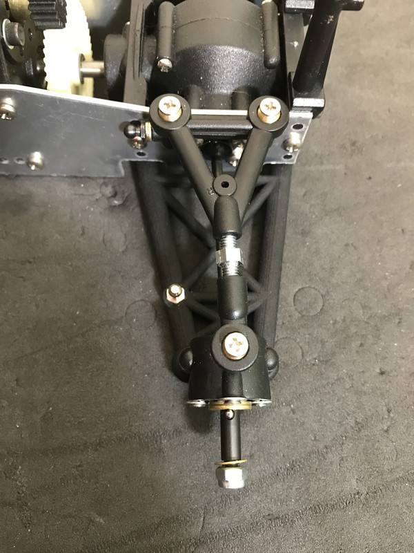

Sorting out the suspension..
Anyone who has tried to build the Coyote knows how terrible and confusing the instructions are! And looking at other builds online may not help because you see a lot of different setups. I have built this every conceivable way to try and figure out what is going on and hopefully I can help some future builders.
The front suspension. This is where the confusion begins because of a huge mistake in the instructions. It tells you to install the upper arms with the “F” towards the rear..which is wrong! If you install it this way, you end up with negative caster angles, that is not desirable in any vehicle. Interesting though is if you ignore the text and follow the pics..it is correct.
The wrong way..
The correct way is to install the upper arms is with the “F” towards the front..makes sense, right? Then the lower arm is installed with the shorter/straighter leg towards the middle of the vehicle. This creates a nice positive caster angle and full suspension movement.
If you flip the lower arm, it makes an extreme positive caster angle and restricts suspension movement.
Another confusing aspect is that the shocks can be mounted in front of or behind the suspension arms. This is more of a tuning and aesthetic issue after the arms are correctly installed. I will show this later.
The wrong way..

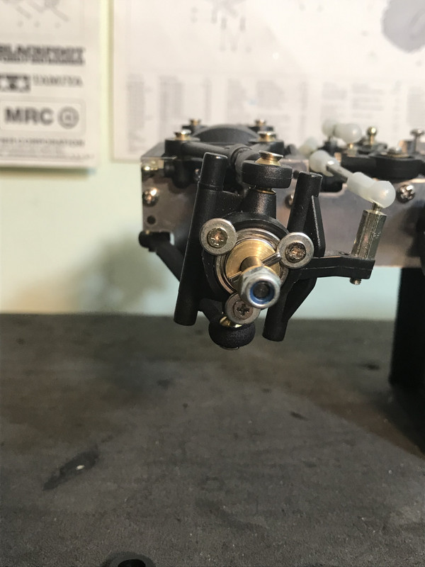

Finally getting this back on the workbench to install @Dadio’s double wheel bearing adapters, put on the front bumper and install a limiting spacer on the rear shocks because the dogbones are getting pulled out of the drive cups.
Stock design with the single 5x16x5mm bearing.
Double bearing mod using two 5x10x3mm bearings…and some more appropriately sized washers..love those Losi A-6215 cad plated washers.

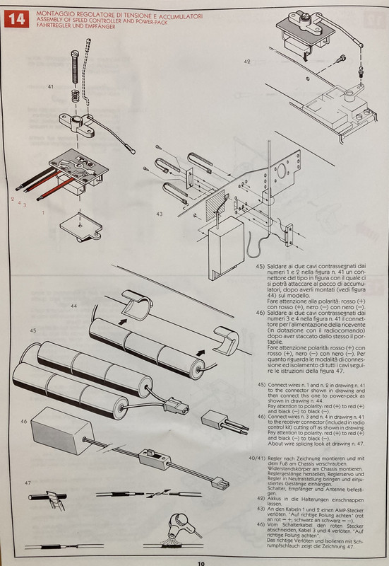

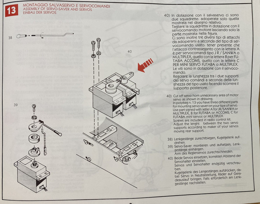

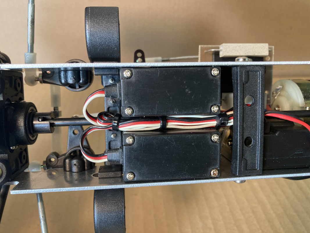

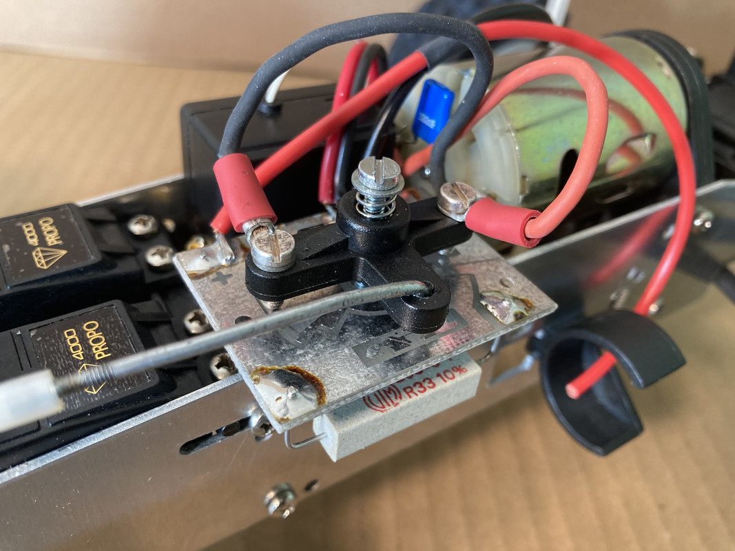

I decided to install the stock electronics and vintage radio gear in this thing. Even though I have done a few subtle mods/improvements, I still want to keep this looking like a box stock build. And when was the last time you saw a good pic of the stock mechanical speed controller properly installed in a Coyote? I couldn’t find one..
It wasn’t easy stuffing these electronics in…there’s little room and you have to be careful to keep everything away from the center driveshaft and resistors. I spliced in a switch harness to the BEC circuit to power the receiver and just did a shorty antenna that will fit under the body.
You have to follow the instructions pretty closely too because there aren’t many other options. Also to note..there are two different styles of MSCs used on the Coyote, so you have to be careful to hook the motor wires up correctly..I had to install mine reversed from what the instructions showed.
Building the battery pack is next..waiting for parts..
