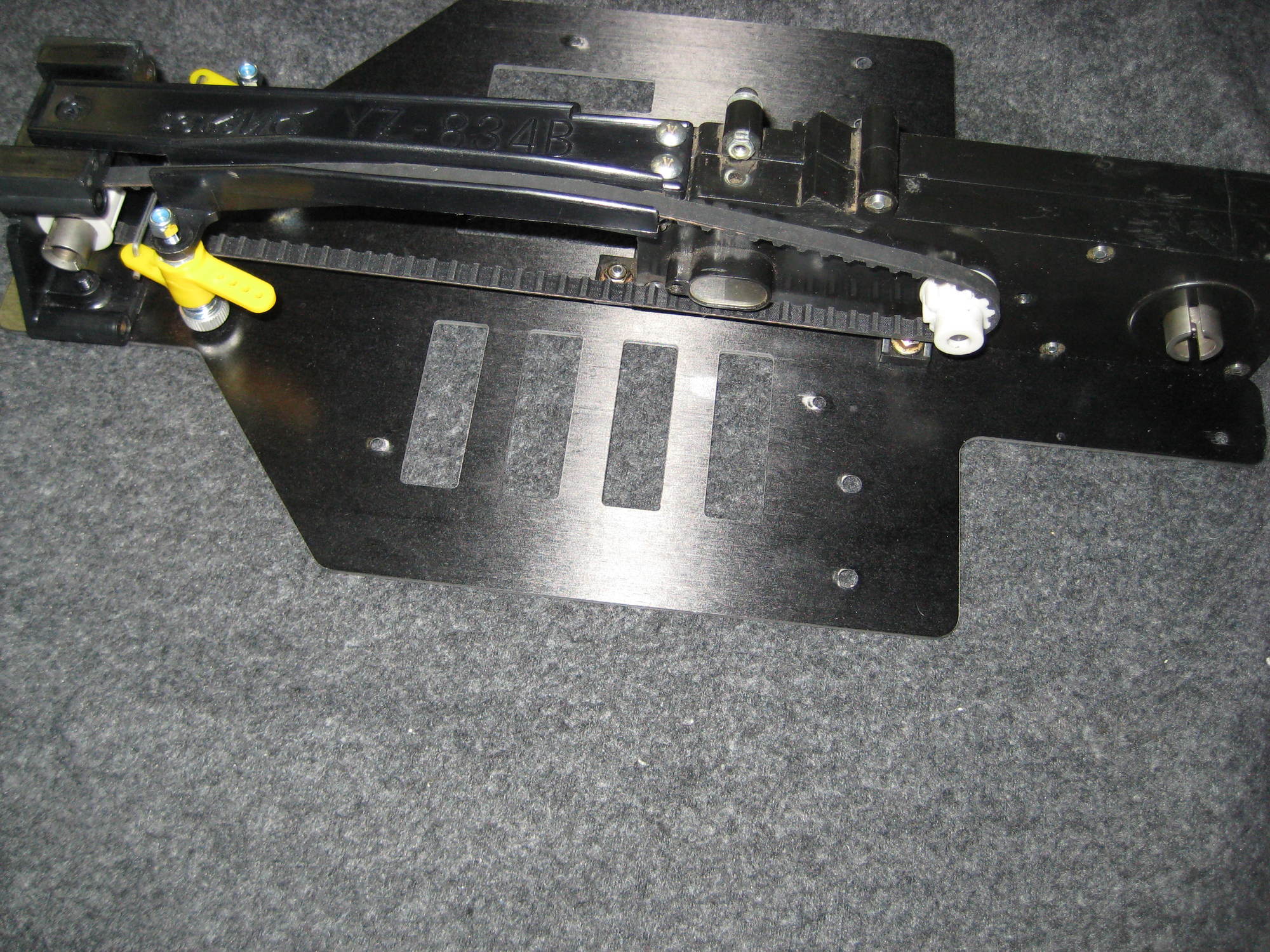

First thing is to have a chassis to build on, and to find the chassis I wanted from Delta is hard to find I believe. And I have to do it while I’m at my country house sins I have my little workshop there, can’t do any “big” job in the apartment. You have to remember that I’m married.
So the only thing to do is making your one.
I had some old CF (not quilted) from when I made a chassis for my old Tamiya SRB. I purchased a sheet (2x2 feet) from a guy in California that use to make porotype chassis for lots of RC company’s back in the 80’. Mostly it was pan cars chassis and he started his business back in -83 (DA Graphite). This sheet is a reproduction in the same way he did produce it in -84.
The first 834 chassis I cut out I did a layout mistake, I got the top layer fiber in the wrong direction. You want them along the chassis, not across. Whit modern quilted CF this is not an issue, you can cut it in any direction you want. Second time around I got it right
On this type of CF you have to super glue all edges around the chassis just to minimize the risk of splitting the CF chassis.
The faulty chassis didn’t go totally to waste, I made a top plate and the reinforcement to the rear arms. And I will probably cut out a few more parts yet.

To connect the gearbox with the front I will use a belt instead of the chain sins this was an option from Delta back in the days. This is pretty easy converting, all you need is Delta slipper, two pulleys and a belt. I used a 17T (S3M) pulley from 3Racing and a 453mm/151T/3mm (S3M) belt from Boom Racing. Depending on the chassis length you might have to go with 16T pulley. Those pulleys I got from 3Racing, I had to drill out the center hole on. But only 1 mm from 4 up to 5mm to fit the front axle and the Delta slipper axle.
I think this belt converting is a pretty neat upgrade for a runner/racer. I know there are many kinds of schools when it comes to renovating a vintage runner/racer ore shelf queen.

That's all looking really good , what belt pitch and length are you using ?

I do wonder how that fared without a tensioner system? Placed like that there is no way of adjusting tension - unless you change belt length. At least with the chain you could remove/add links to tune. I'm sure you've seen the homemade tensioning systems in some 834b rigs...
