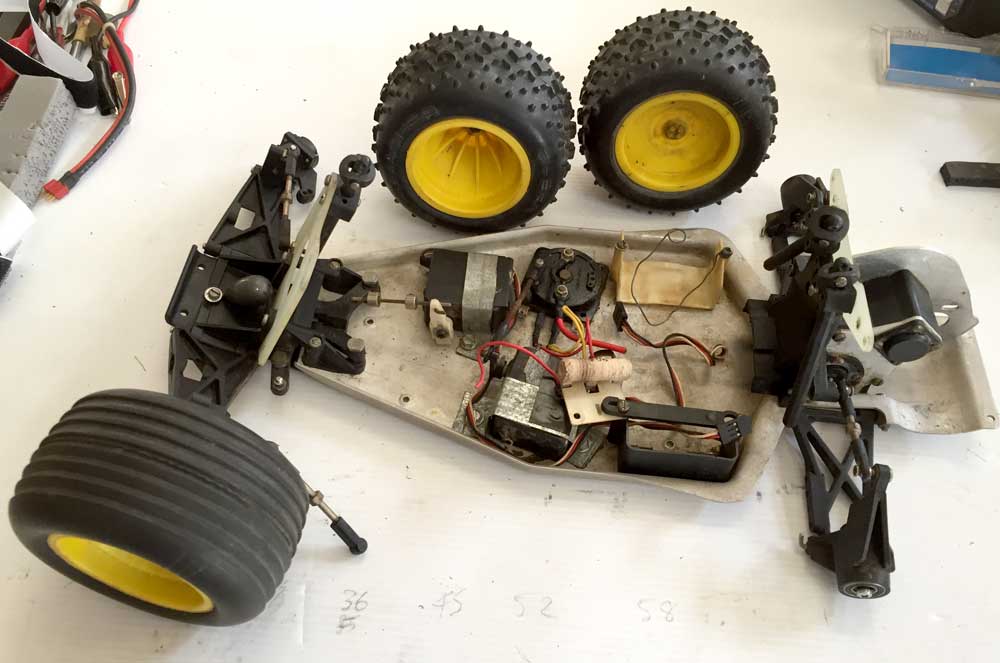

Schumacher Shotgun project
Schumacher Shotgun.
-Arrived in the post.
I thought it was a Cougar from the ad photo but it's a somewhat different breed of pussy, thanks Alex for ID-ing it as a Shotgun (has the 2mm rear pivot pins).
Some parts required, mainly suspension parts like ball sockets and turnbuckles. I need to get another of those nice big fat wheels/tyres (VEE-2 they're marked) which will be ideal for the rough Wombat Forest.
The "mystery lump" up front is a lead sinker so I might have to add buoyancy tanks.

Hey Jools,
Nice to see another old schuie getting a new lease on life!
Your truck looks to have started it’s life as an early original cougar or even a top cat and was then converted to a shotgun. You can tell as the chassis have the mounting hole for the topcat lay down shocks that only the top at and early cougars had, by the time the shotgun was released they were deleted. Shumacher released a conversion kit to go from cougar to shotgun , my first cougar went through many changes including running as a shotgun for a while.
The front tower was an upgrade for the cougar (cougar 2 pre release) it also on the cougar 2 box pictures.
I’ve got 2 rims laying around in my garage your welcome to have as I haven’t got the urge to do a shotgun yet- got too many cougar 2 works on the table as it is. Tires are still available through schumacher aswell

I was wondering what else might be required.... what I saw included:Jools wrote: ↑Thu Feb 28, 2019 9:30 pm Haaha Alex, and there I was worrying that the wheel and tyre might be a hens-teeth jobbie!
The good news is that though the thing appeared to be REALLY cruddy and incomplete, it's actually not bad at all, -a low-use thing. Plastics have come up almost like new with just an initial toothbrush detergent clean.
Apart from the missing wheel the only things that will stop it are x2 A095 steering turnbuckles, and - well I have some unidentified shockers that will do the job initially, They could be Schuie, (maybe I'll upgrade them later), but the ones I have don't have the extended spring holder/lower mount on the shaft that allows it to fit down into the front arms, plus the T238/T239 lower strut rosejoint mounts.
Pretty lucky really, the downside is that this build might be over too quickly!!!
-Jools
- Either a front tyre and wheel with rib pattern, two tyres and a rim in any pattern (if the rib tyre is not glued), or two complete wheels and tyres
- Front turnbuckles, rod ends and ball joints for at least the steering links, with maybe a few extra for the shock tower.
- Truck front bumper
- Truck front shock mount
- At least one drive shaft
- Rear motor protector ***
- Possibly gear cover ***
- Maybe spur gear?
- Maybe another battery holder, to replace the ASSociated one
- Shock mounting screws and standoffs
- If you want to go that route, steering servo mounts
- Shocks (with possible longer lower ball joints / shock rod ends) ***
- Body ***
I can certainly help with a lot of that , although the parts I've marked with *** could be problematic.
I'll try and look in the box-o-Schuey junk this afternoon....
P.S. How about an Irvine .15 engine, while we're at it?

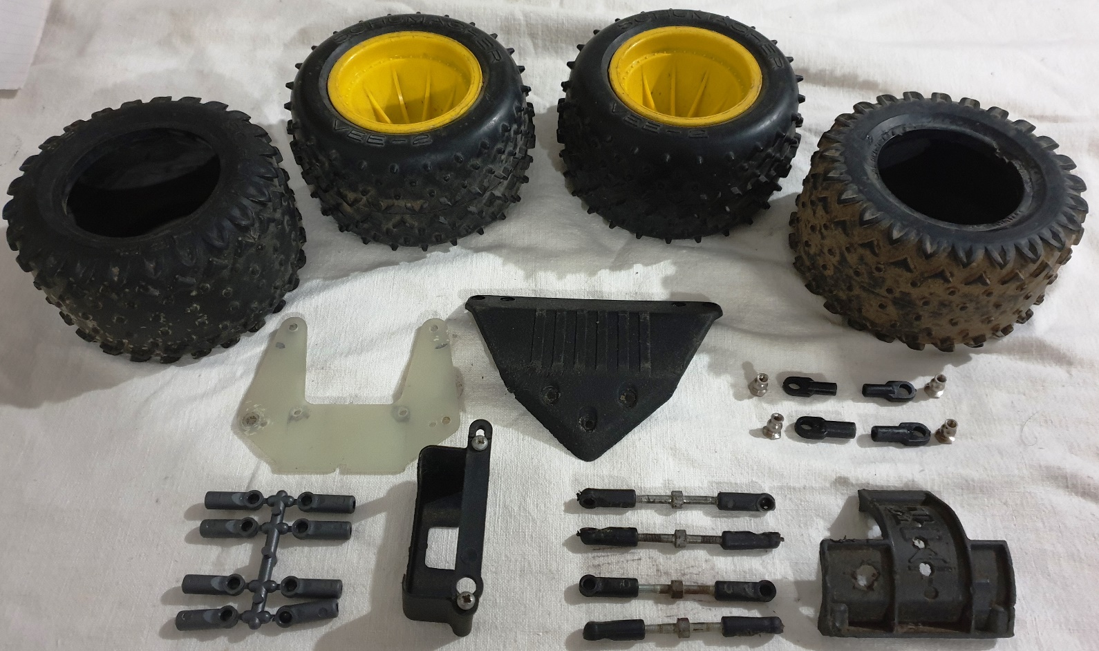

Jools,
Here's what yesterday's junk scrounge uncovered... - Two very nice condition VEE-2 tyres with good condition rims
- Two usable VEE-4 tyres, if you would like to try them free
- Cougar / Shotgun front tower
- Four new 'rose joints', two slightly smaller than the other (T238 / T239)
- Near new complete battery holder
- Two pair front tie rods, one pair 55.5mm and one pair 60mm
- Hi-Po lightweight ( ) TopCat rear motor mount
- If required, more new rod ends.
No chance of gear covers, I think I'll be picking up some re-re TC ones soonish. Tyres are a real issue, as a lot of the ones I showed over the past few days have rotted... including some that have not been used!

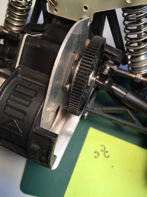

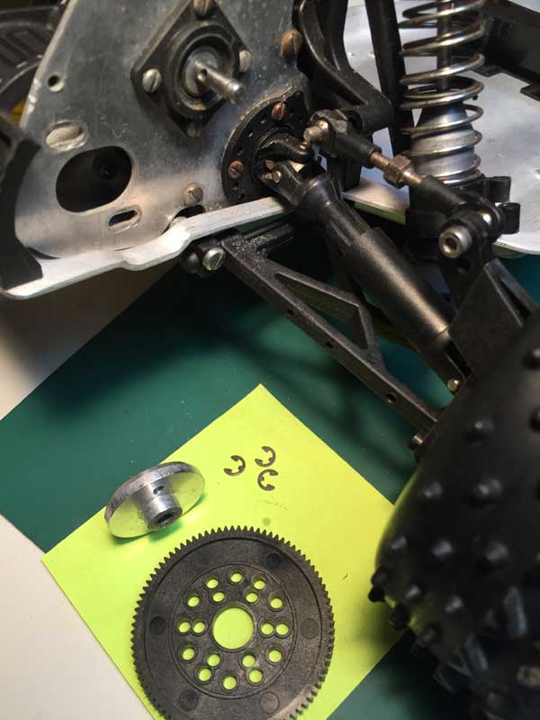

One of the (few) bodges found on this little beauty.
This is the spur gear, - the P.O. has done a 'conversion' using that alloy adaptor plate. Co-incidentally I had in stock an 87t gear which fitted the adaptor plate almost perfectly.
It would work, but I'm not 100% happy with it, and would like to go back to Schuie 'standard' (with your help Alex!)
As you can see the gear was held on with x3 circlips. (Well, in for a penny in for a pound I guess !)
I want to get lowish gearing due to the rough slowish terrain up here in the woods, so a 19t x lots of t will give me a starting point.

looks like Alex has most of what you need in 1 hit
The gear cover is an easy fix to find and so are original spurs as the top cat rere parts are a straight fit for that matter basically the whole rear end except for the hub carriers will work.

Quick note regarding the rear shock tower setup... if you can move the shocks to the outermost hole, you can then mount the body mount post blocks so the posts can be vertical, which could be a lot easier to mount a body with a flatter rear section. Oh, and the rear shocks are upside down
