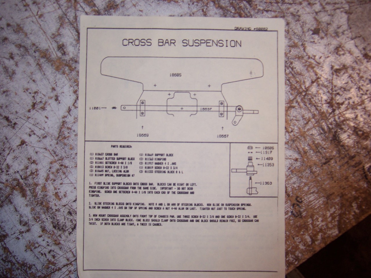

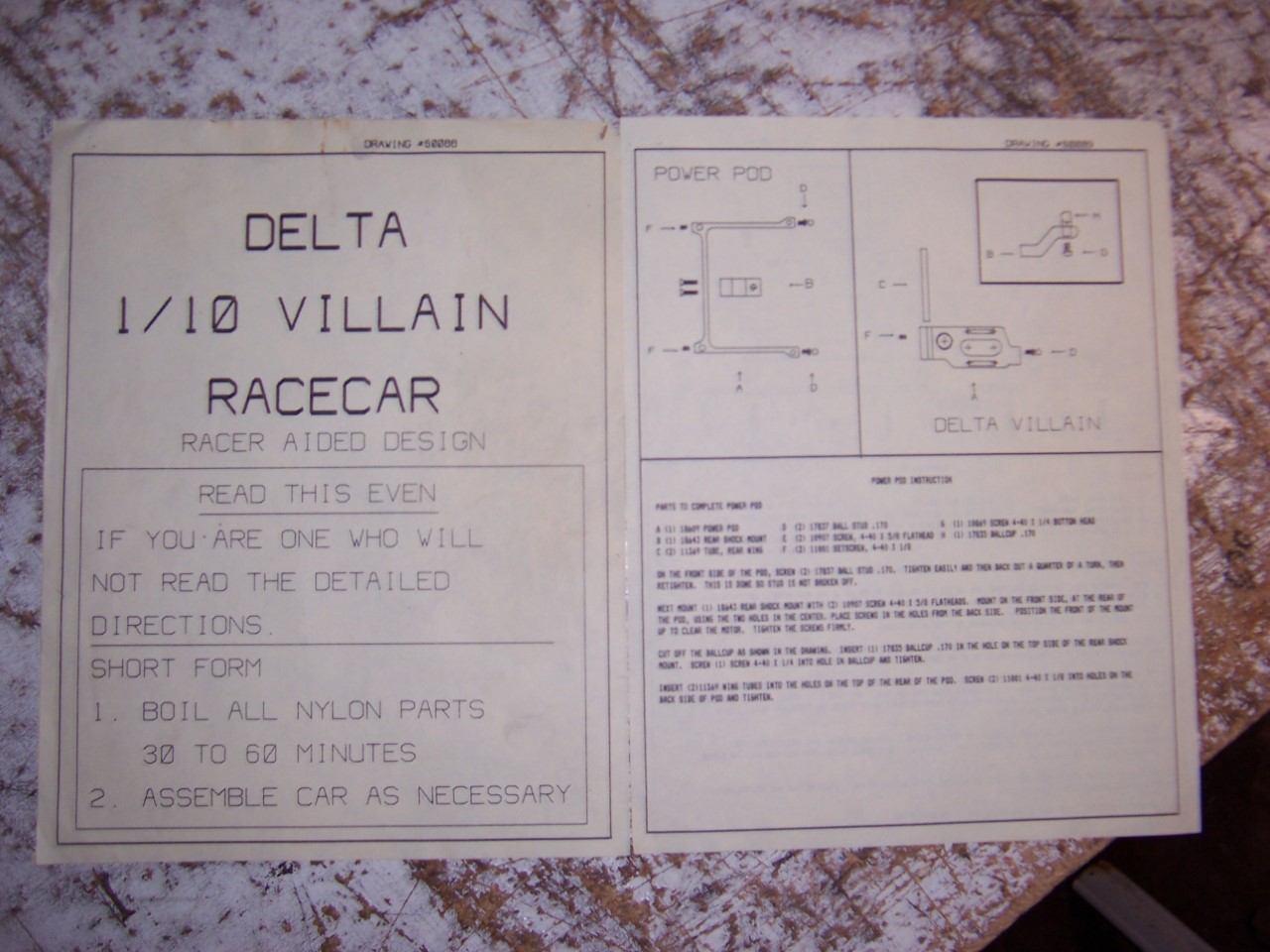

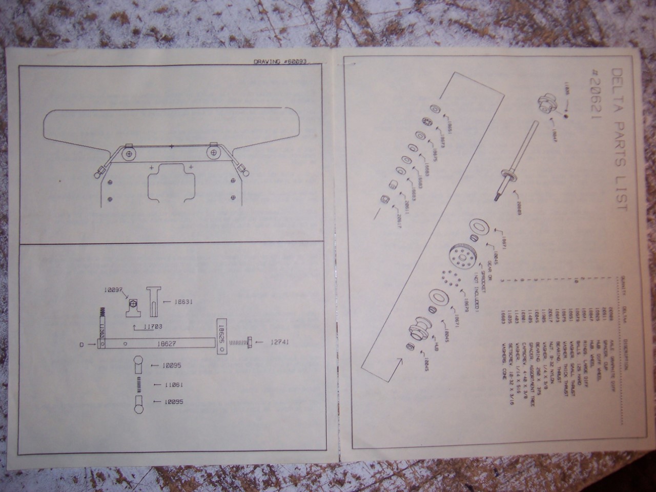

    Delta Villain probably was the top 1/10 Pro-10 line up under Delta. Hard to come by now.
    Bolink always have a pseudo off road car. Heard that it was light and fast, ok to drive on relatively non-bumpy track with no jumps.
    I do not know anyone personally has on though...

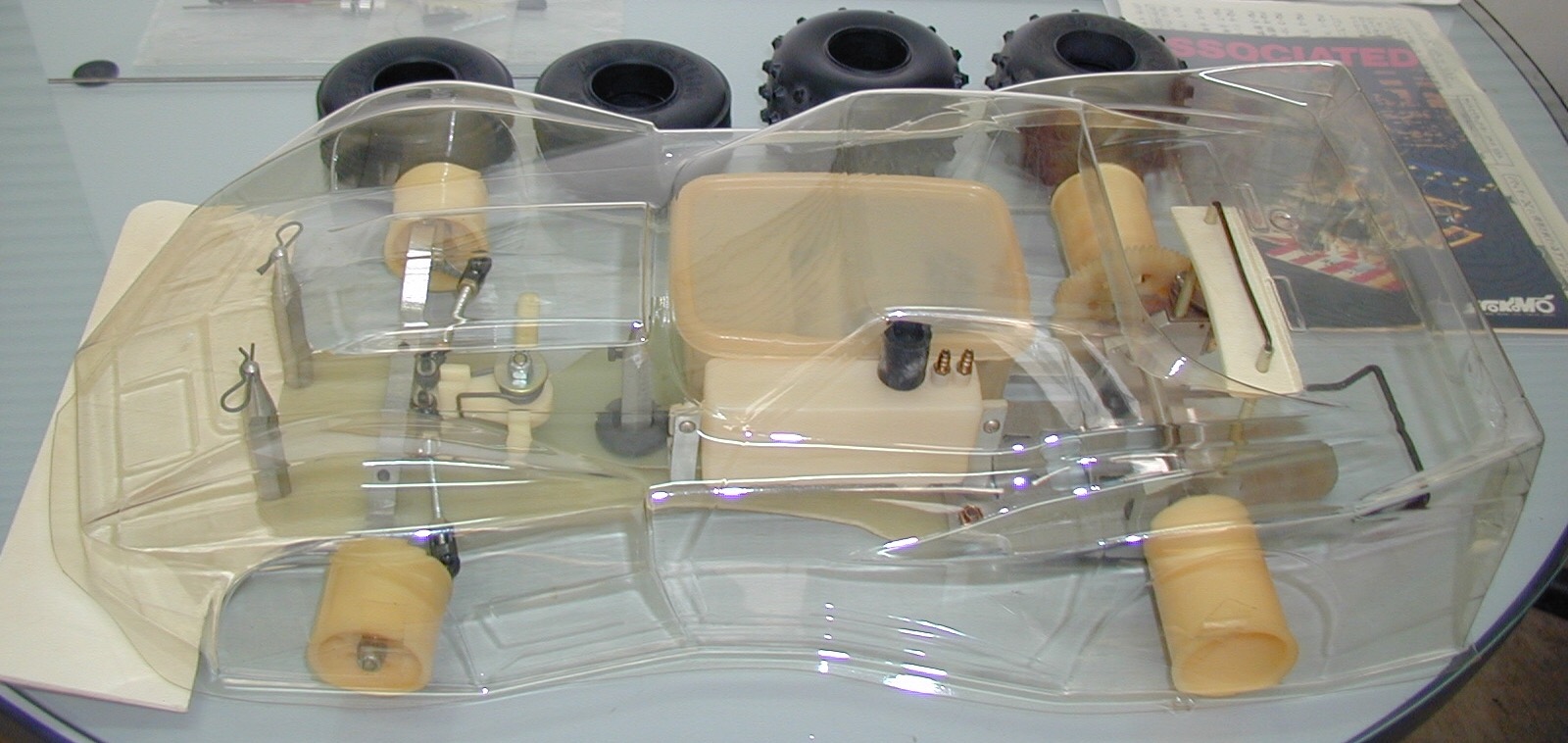

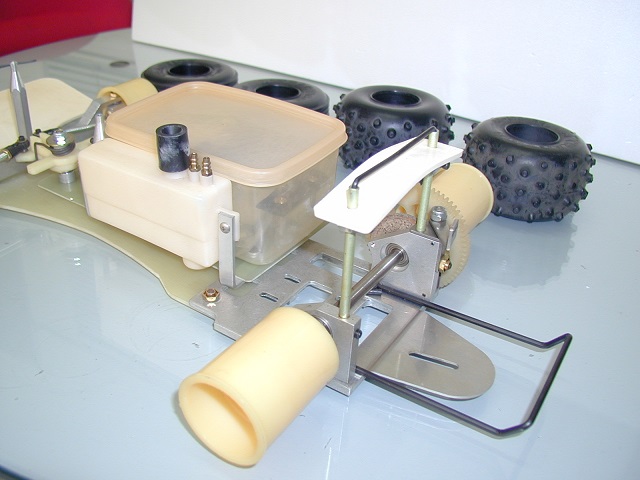

    Back about 1979 Associated RC200 had an twist too, off road wheels and tires on a pan car. Seems like it was only offered in the Japanese market.
    A plastic lunch box was actually included as the electronic box! Zero suspension except those off road tires were supposed to be bouncy...
    A friend of mine had it and he enjoyed it a lot with his brother until his mom got pissed off when they started the engine in the bedroom. ;)
