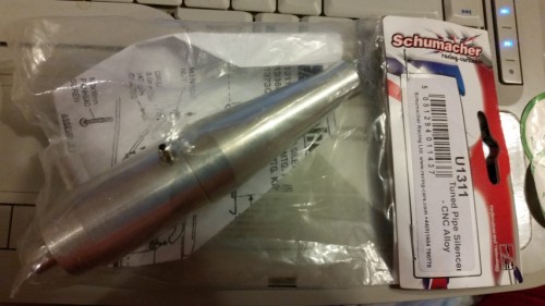

Unfortunately we don't have the round silencer; Schumacher gave us the part number and when we ordered it sent the silencer pictured below. As you can probably tell, it's pretty useless like that! We were kind of expecting the round bit, and then going to sort an exhaust to sit on that!

Ahhh... okay, now I see what they've done. Instead of the standard Nitro 10 Irvine 15 part, they've sent the tuned pipe version.Netto wrote:Hi Both
