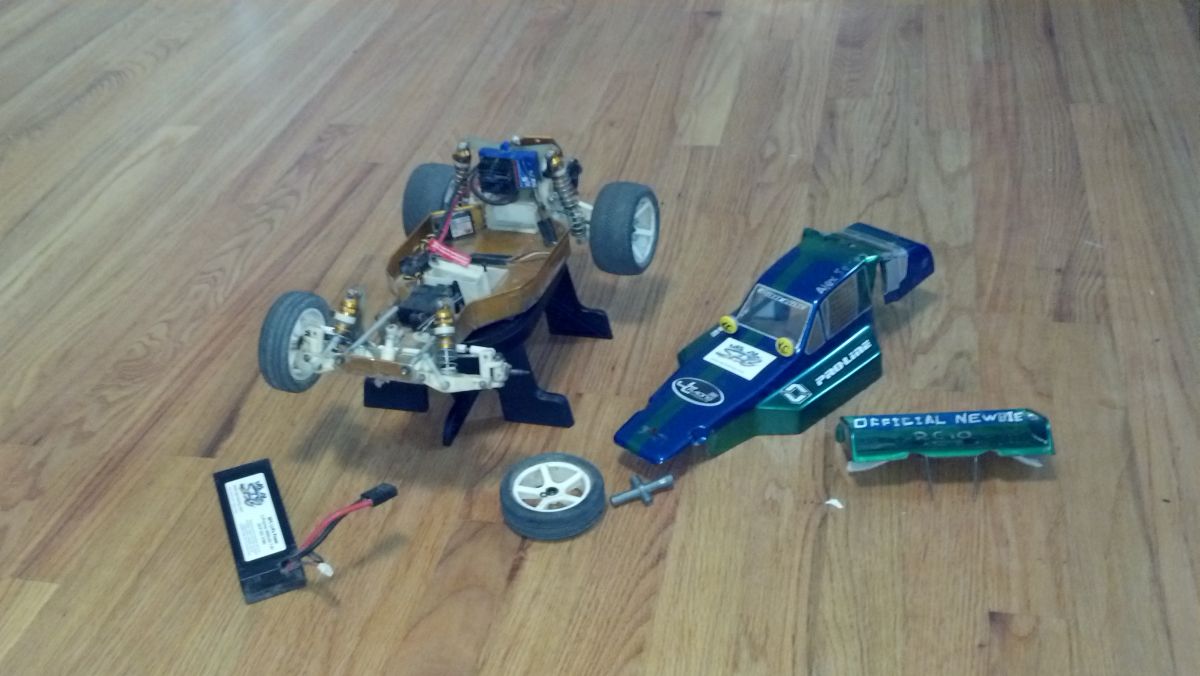

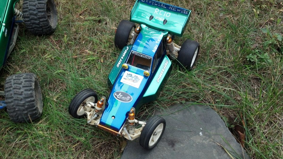

Hello all,
For those who don't know, I got my first (and so far only) Rc10 as a short arm off eBay in early 2012. First I joined this forum and got it working, gradually fixing and upgrading it as I went. Then I learned about Vonats, got the car into the best condition I could, did a lot of practicing, and raced Novice (expecting to race other 14 year olds, instead being humiliated by 6-11 year olds).
After that, I decided to put long arms on the car for ease of parts replacement and better handling. I put a Novak 17.5 in the car in preparation for 2wd buggy in Vonats 2013, but couldn't make it.
Now I'm thinking about rebuilding the car with more of its original parts as a short arm for a few reasons:

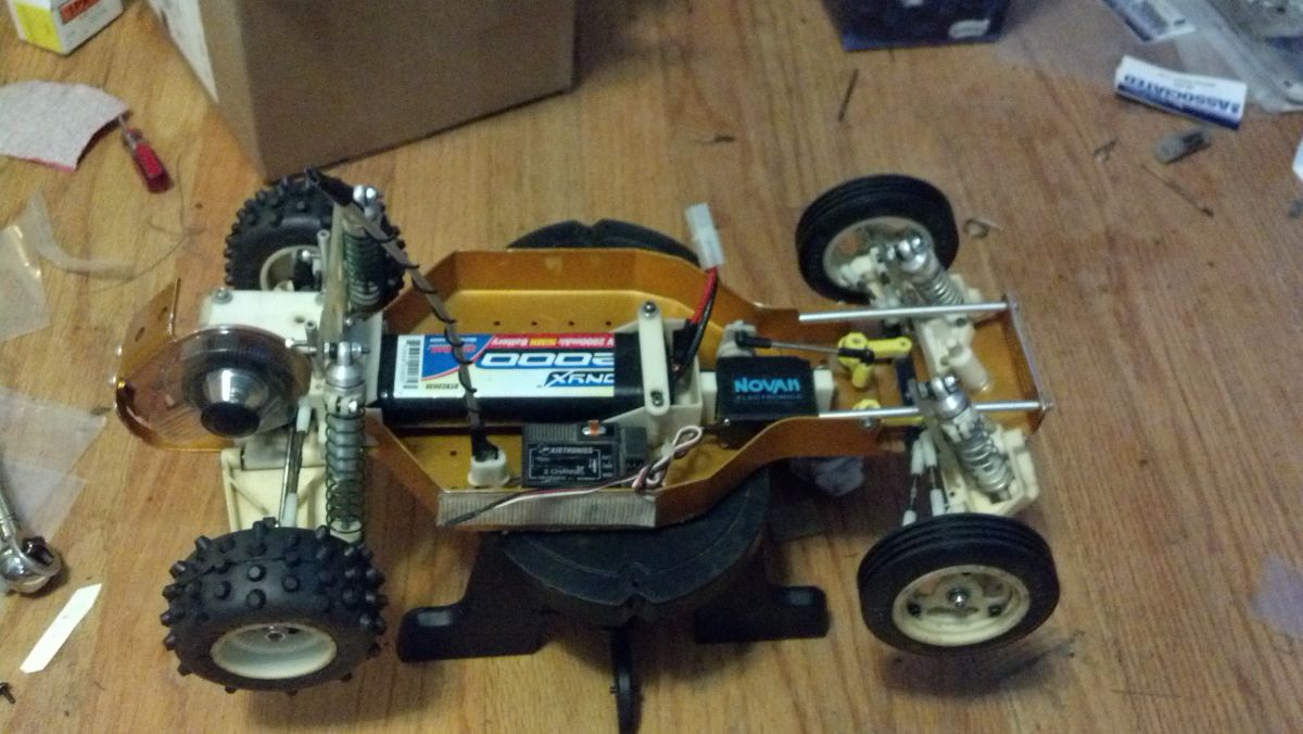

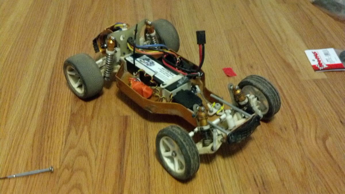

Then I added long arms:

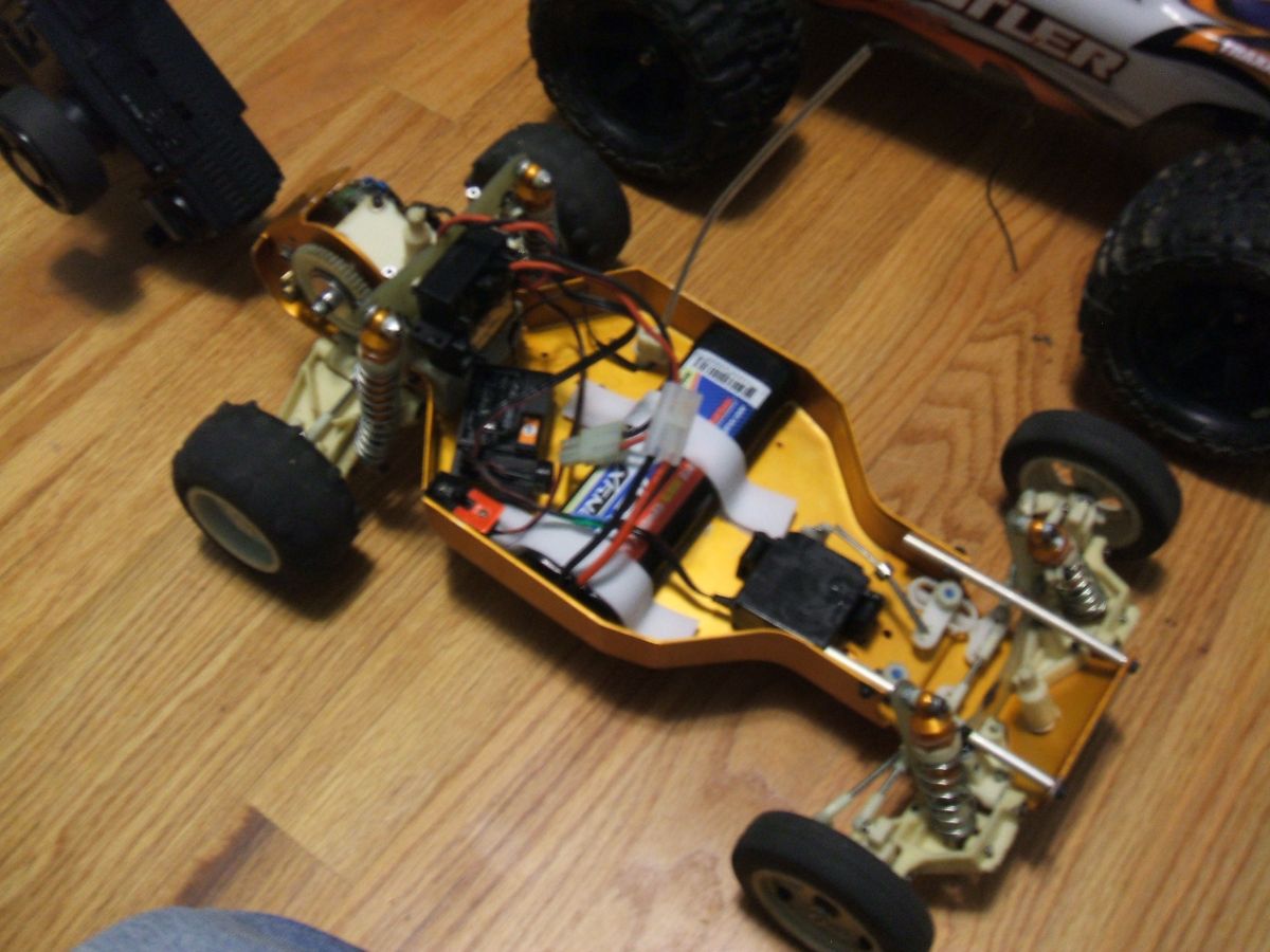

Here's what it looks like today.. . . you have Associated Green Slime for brains. And not even new Green Slime, but old gooped out Green Slime.

Okay, thanks. The springs the car came with (I think they were the stock ones?) were insanely stiff.
Here's what I'm thinking of doing:
.Putting short arms back on
.Putting re-re tires on my old wheels
.Taking the A&L steering off? I hope not. I paid $30 for it weeks before the intriguing ad ran.
.Putting a brushed system in to run a Tamiya Sport Tuned per Classic class rules
.Getting a good starting point setup- shock mounting locations, spring weights, shock oil, camber link holes, etc. I need a good starting point to tune from. I'm looking at the Blinkinger.
I might cut the nose plate to mount the servo lower, dremel the motor plate, and maybe even do a mild chassis cut.
I've made the car into something it wasn't- it's now pretty much a CE with .56 front shocks. I want to make it into a better version of the short arm it used to be.

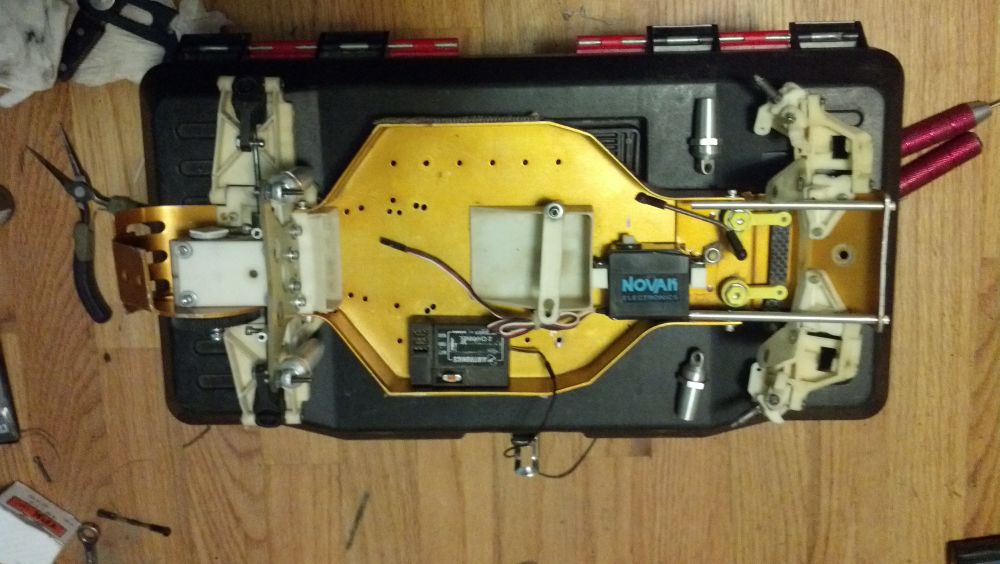

It's almost together. I'm just waiting on shock shafts (new all around, switching to 1.02's in back), ball cups, bearings, and a motor. They're coming in the mail.
I'm planning to copy the setup JK Racing's setup from here.

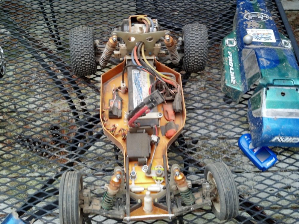

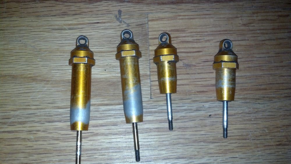

did you remove the anno off the shocks? They look custom

Yes, I de-anondized the shocks. Those are the original shocks, the same ones the car has always had. The anodization had gotten very scuffed up and looked bad. Here's a photo from before I stripped them.
The suspension feels great, and the transmission shouldn't be a problem. It's got de-burred pinions and outdrives mated to RW Racing steel idlers. I re-greased it and rebuilt the diff while the car was apart.

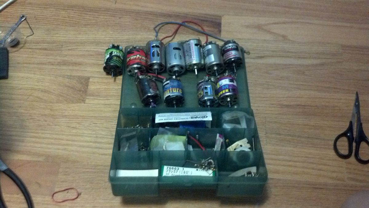

I got a lot of motors from Rccars4all. I'm trying to decide which one to use in this car.
There's a Venom Fireball 17 turn, a Trinity Chameleon, a couple of silver cans, a silver can with a Kyosho Le Mans stock 05, a Kyosho Le Mans 240st, a Le Mans 360ST, a Peak Dynasty 19 turn, a Trinity Gold Dust with Brian Kinwald's face on it, a Kyosho Atom Smasher 12 turn, and a GM Offroad Adventure that I can't find any information about.
I'm thinking I'll run the Peak Dynasty 19 turn in this car off my XL-5 ESC. I'm just trying to decide which of these motors are worth running and which are too old or rare.
I definitely plan to run the Trinity Chameleon, the Peak motor, and the silver cans. Maybe I'll run the Kyosho Atom Smasher? The problem there is the only brushed ESC I have that can handle a 12 turn 540 is the Novak 410 hpc.

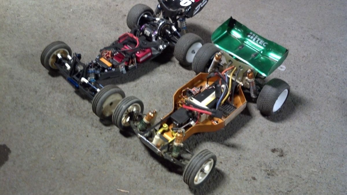

The car's almost done.
