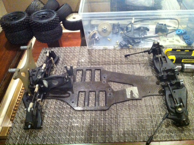

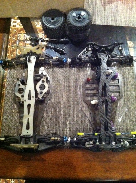

So I managed to get ahold of two previously loved versions in varied conditions and started with the exciting task of tearing them down to complete one decent car:

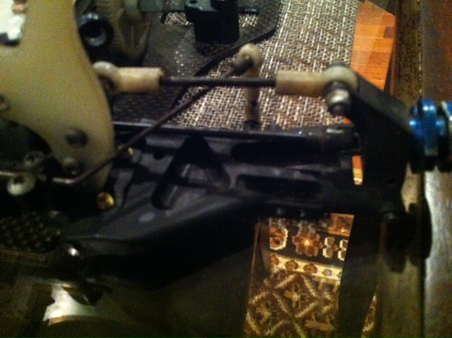

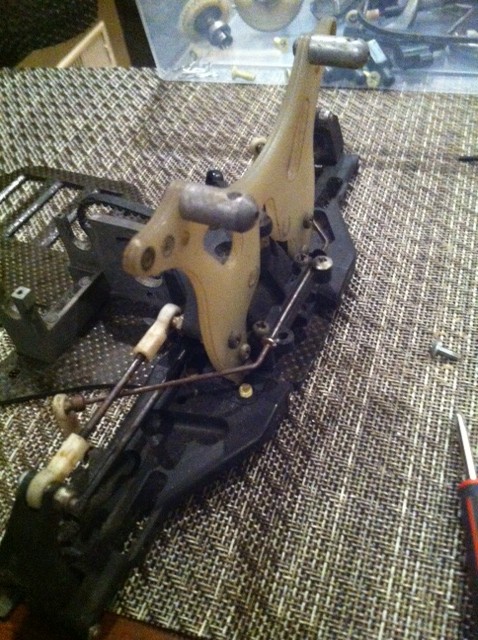

During the tear down I noticed that the arms didn't quite look right, does anyone know if these are correct? I believe them to be Pavidis or later era arms but wasn't 100% sure if they also came with some versions of the 1994 car?

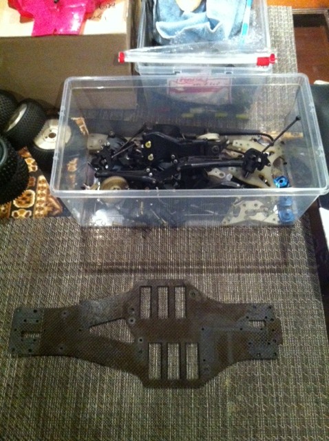

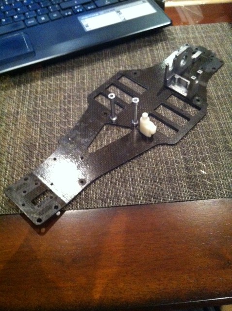

Finally managed to get them completely torn down before it was too late into the evening and start tomorrow with the cleaning, determining which parts are in the best shape and heading to ebay to do some shopping

I think you have a very promising rebuild here. I'm sure with the two cars you got there you can at least get a very good runner.
The car on the left looks more like stock compared to the car on the right (alternative top deck, suzuki hubs, aftermarket turnbuckles ?rpm)
I think the rear arms aren't stock. These ones seem to thin out a bit more if you know what I'm talking about. The stock arms are certainly wider and "beefier". I've never heard of yz10 '94 arms breaking!

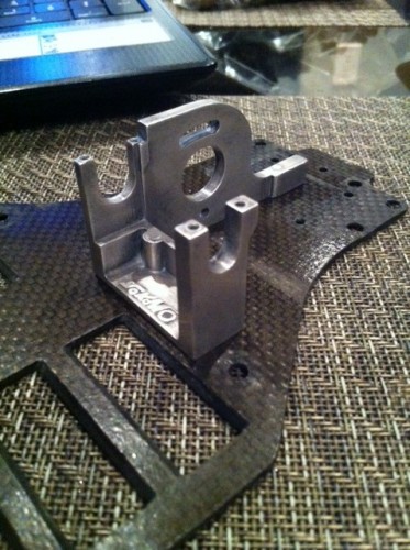

The mag motor mount can be scrubbed down with wet and dry and then polished. Alternatively, try bead blasting if you have facilities closeby.

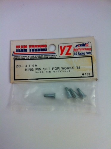

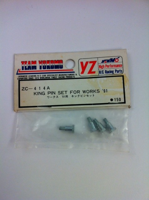

I believe the part number you want is ZC-414A, it might also have been released under other part numbers for different models.Toaster wrote: I am especially looking for those hex shaped kingpin like screws for the front and rear shock towers

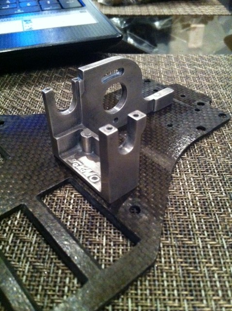

Well although it doesn't look like all that much was completed, promise you guys that I have some nice blisters to prove it lol. Took an SOS pad to what you can see and scrubbed a decade or so of dirt, grime and oxidization off and was pretty happy with the results. With all used parts there are some imperfections but nothing you can see from a couple feet away
Definitely going to shoot them with clear sometime this week but thought I would at least show the progress and post a little bit of an update.
