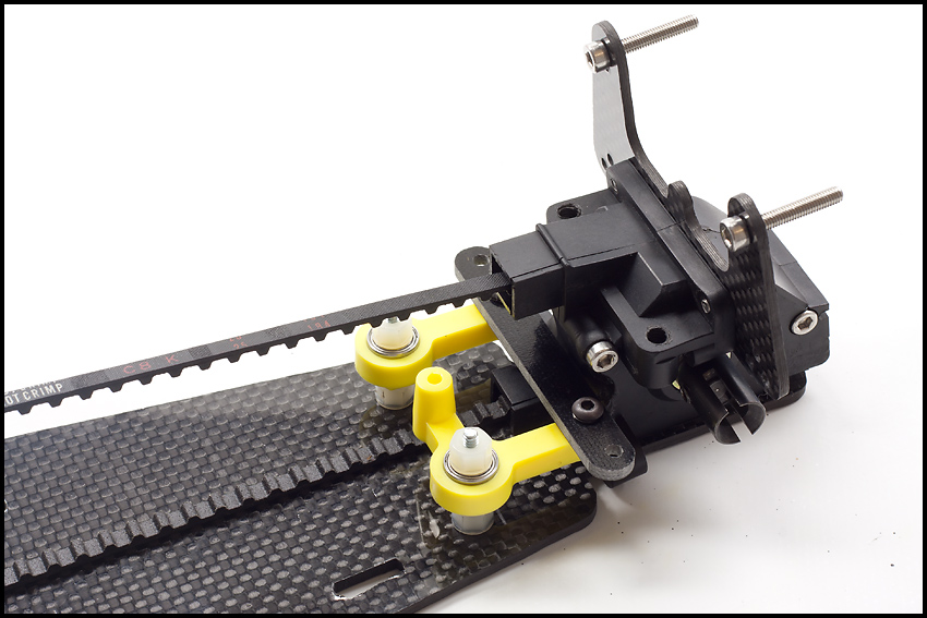

I do have a query already however if anyone can shed any light, and that is on the steering kit I have bought. It was listed as a buggy steering kit, and is complete, however it seems that the servo steering arm link is set up to be on the rightside, instead of on the left as more commonly seen as standard etc. Is it meant for the rc10 buggy or maybe a truck kiet?
With the standard servo mount holes, this seems to cause some odd angles to contend with, particularly if I want to use a servo saver type arm on the servo as they stand off more. First thoughts are to either mount the servo around the other way, and maybe put the servo mounting posts in front of the servo lugs. I also have a Savox low profile servo that I could use instead which may give more options space wise.
Does anyone know what the intended set up was with steering set? Is it a Houge?
Pics below to show more, many thanks in advance.

Hey... nice collection of parts! I purchased some fiber lyte parts too, they are really nice quality.
That looks like an A&L steering kit... only possibly assembled wrong. I'm sure someone can confirm that on this site.

A&L steering dyed black. They came with both left and right bellcranks, and a idler. That way you could set it up either direction.
Good news is they should still be available if you want to run it.

The bell crank raised part is one piece and molded so no way of switching around without modification. May look for another similar set so can run on left, and have some spares.

You may be mis-understanding. The kit commonly comes with three yellow bits, one of the cranks being a mirror image of the other, so that you can use them in Kyosho applications, like this Optima..
Here are the directions for the kit. You should confirm you have all the shims and bits because it looks as though the center link is needs to be moved under, but you probably saw that..and you'll need to lose the tall headed phillips screws in favor of some lower profile button head ones too.
http://vintageteamaandl.com/rc10str.htm

cut the raised part off the right bellcrank, flip it over, and put it on the left side. i've done that before on one or two of them already.

Many thanks Al and Scr8p.
I'm definitely missing the shims, does anyone know the dimensions of them, height especially, as could probably find something or make some up.
Had same thought as you Scr8p on cutting it down and flipping it over, should be able to nut and bolt a long ball joint through ok and make another shim to raise.
Will let know how goes.
Think i've sourced some nylon wings anyway.

A&L steering kit from Synergy - one with steering arm on left.

A&L Steering set

I've also flushed, cleaned and oiled the bearings so the A&L Steering arms are now silky smooth on the bearings. Will hopefully find a one piece RPM steering brace/arm for it rather than a turnbuckle.
